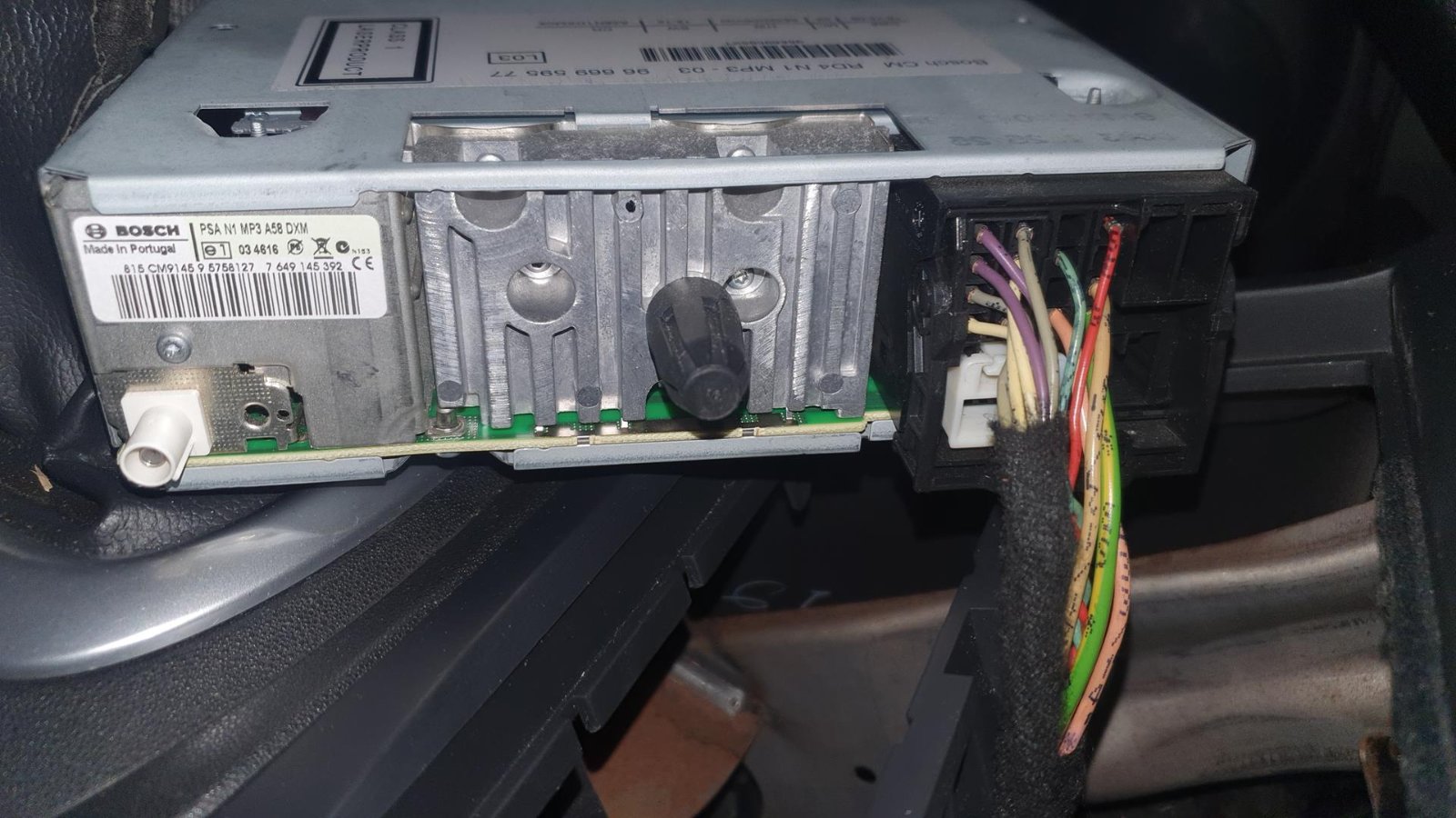

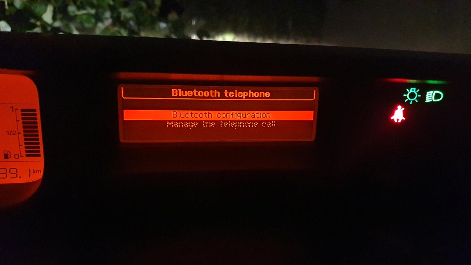

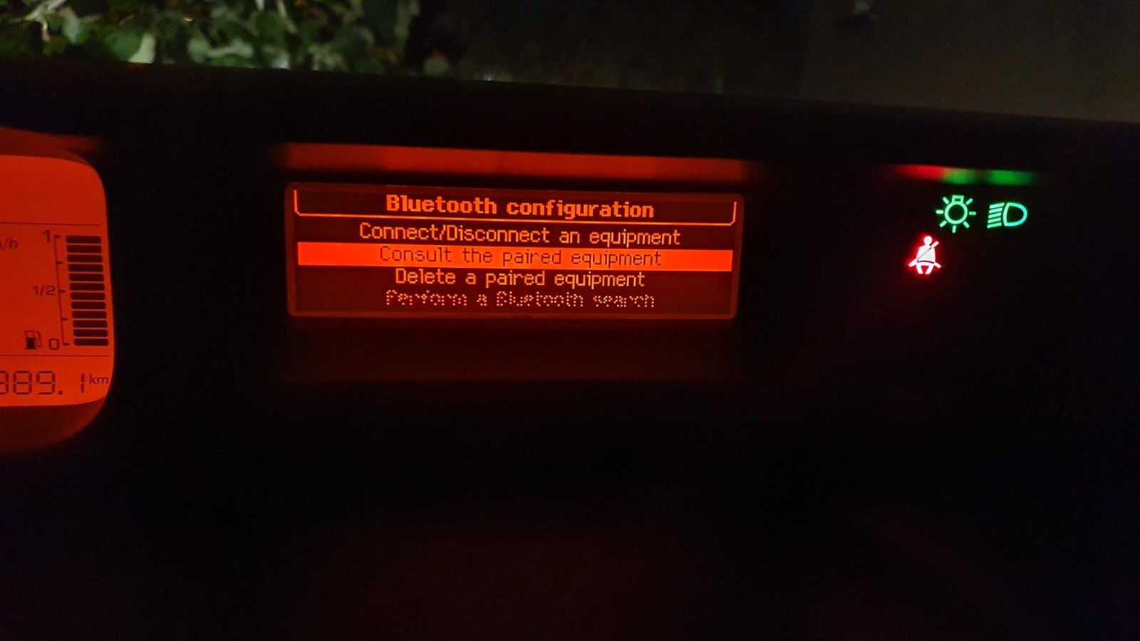

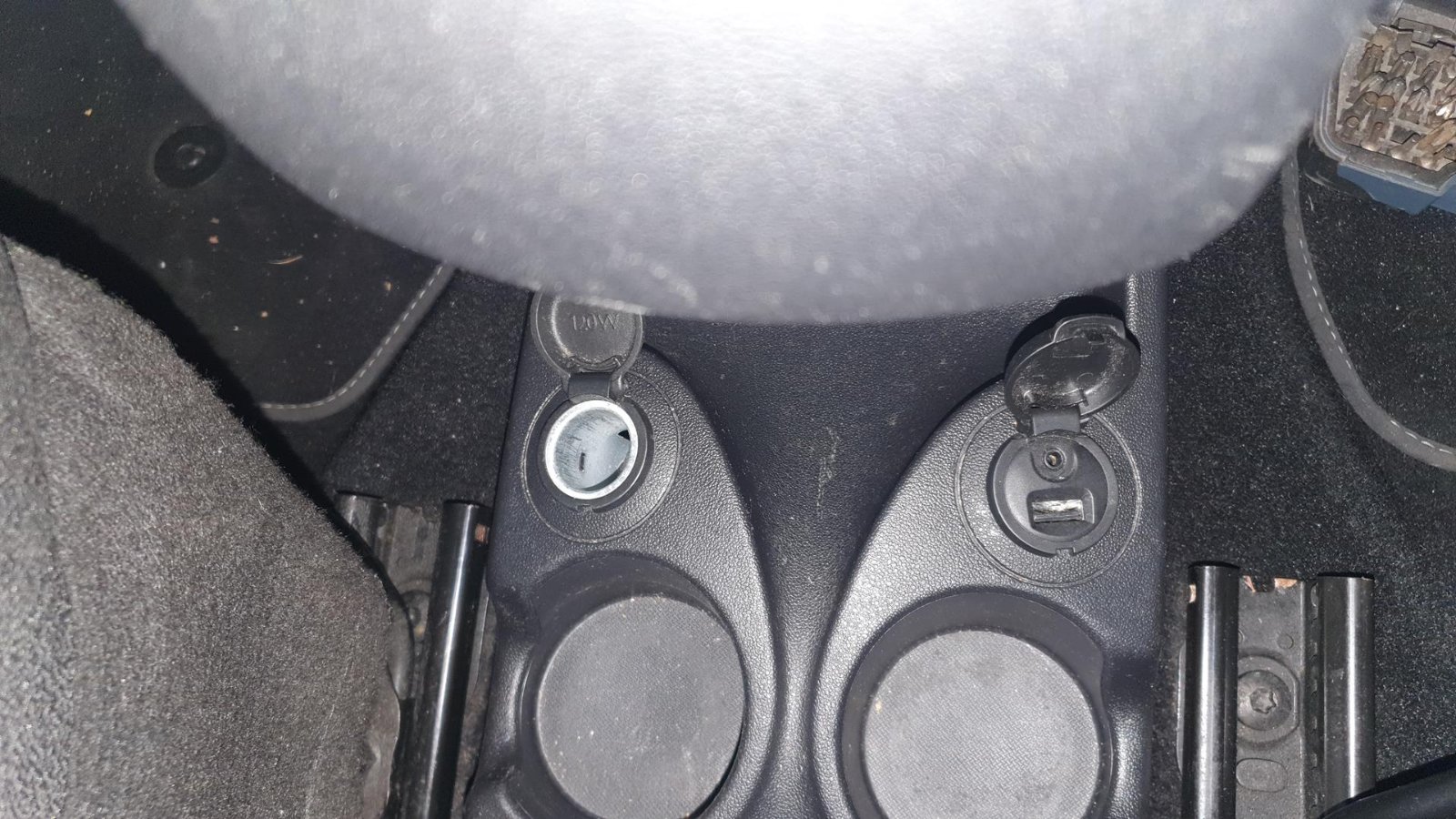

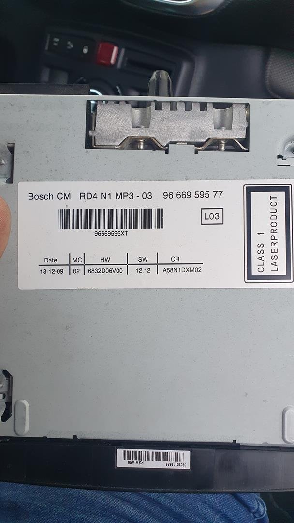

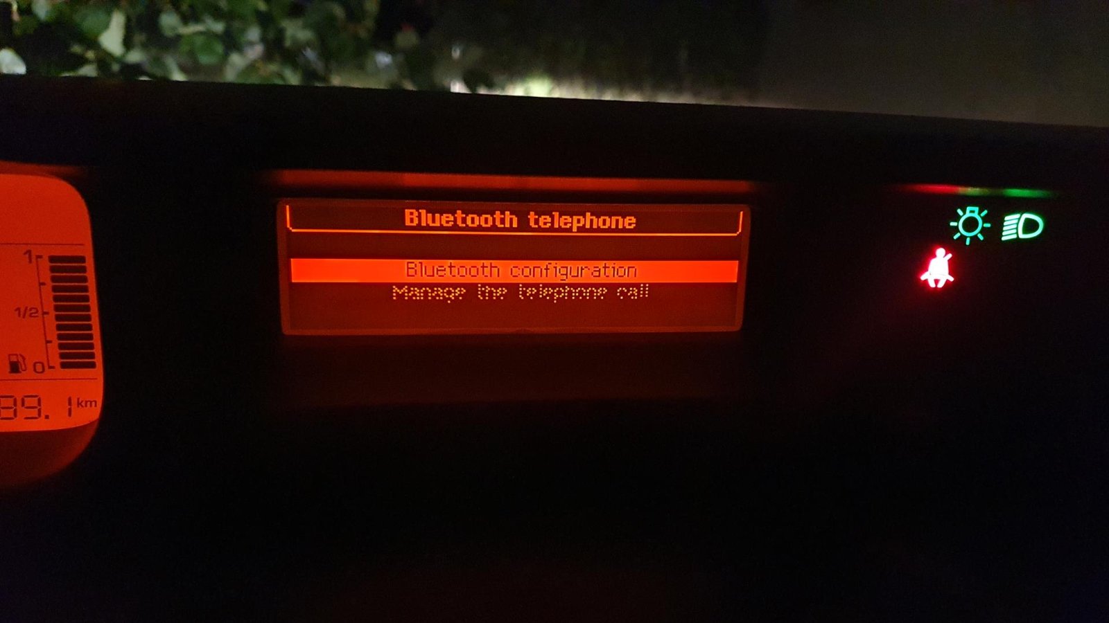

Hi all,
i have similar problem and i don't understand situation.
Car: Citroen C3 Picasso, production end of the 2009 year.
Radio: Bosch CM RD4 N1 MP3 - 03 96 669 595 77.
In middle consol usb port not working, aux port not working. Wires are goes under the heather.
On car screen i can choose BT option but they don't work (no delete, no paring, all options unable to run).
Is it normal that Citroen put BT options to choise on screen, put usb, put aux and all are not working??
I was looking BT module in my car but without sucess, no socet to plug BT module if i get one, for exemple on ebay. I supose that i do not have parts from diagram from first side of this topic (50, 30, 20, 22, 21.... and 60??, 41??).
Diagbox 9.150 told me that BT module/BT set is not avaible/no connection.
I would like to use all factory functions and have BT with streing from orginal car interface. What can i do??
It's first Citroen in my live.
I would be very grateful for your help.

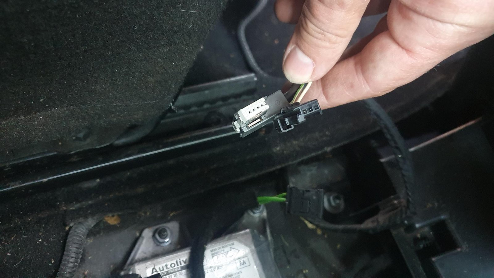

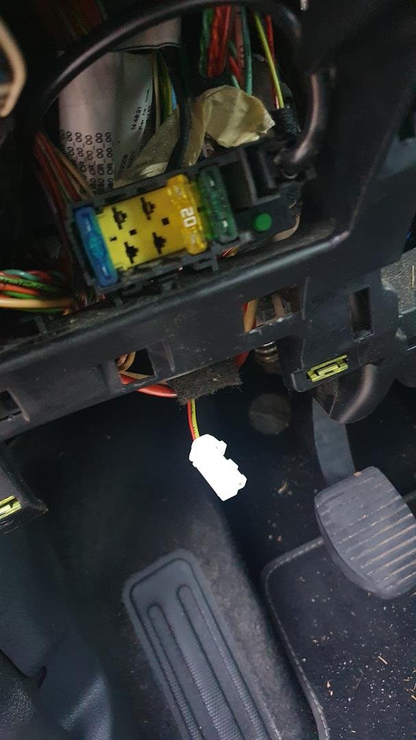

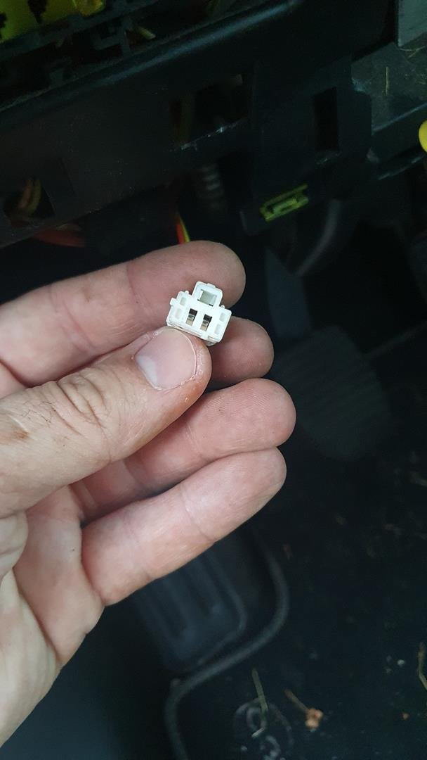

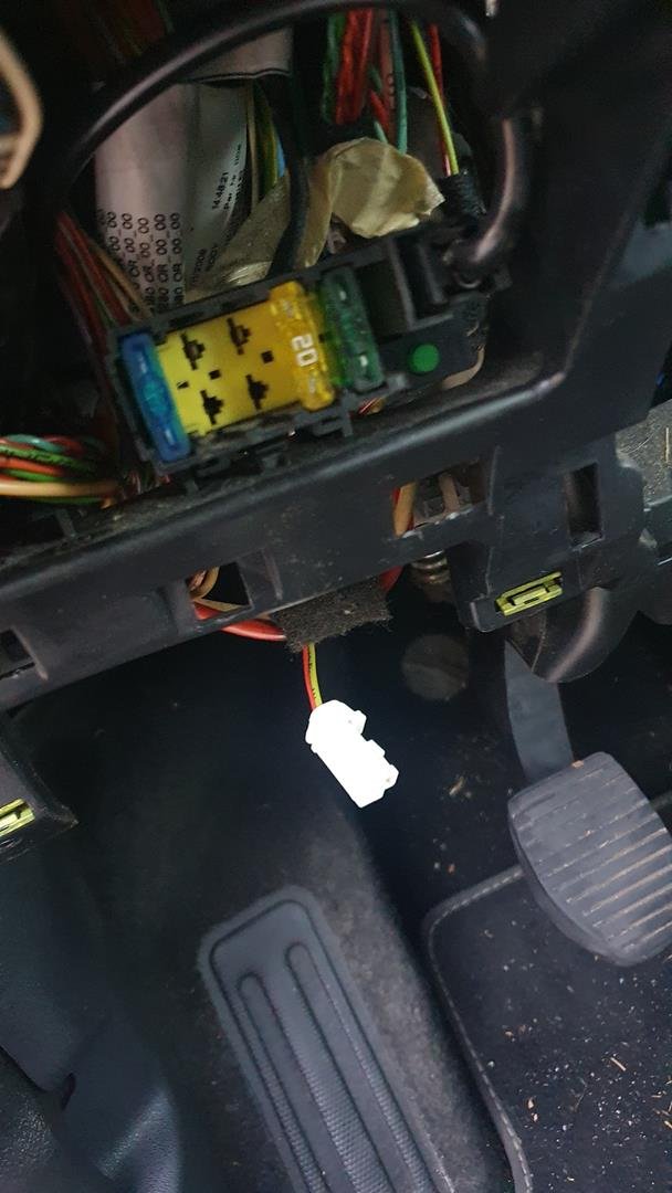

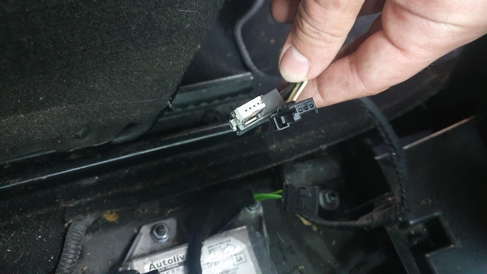

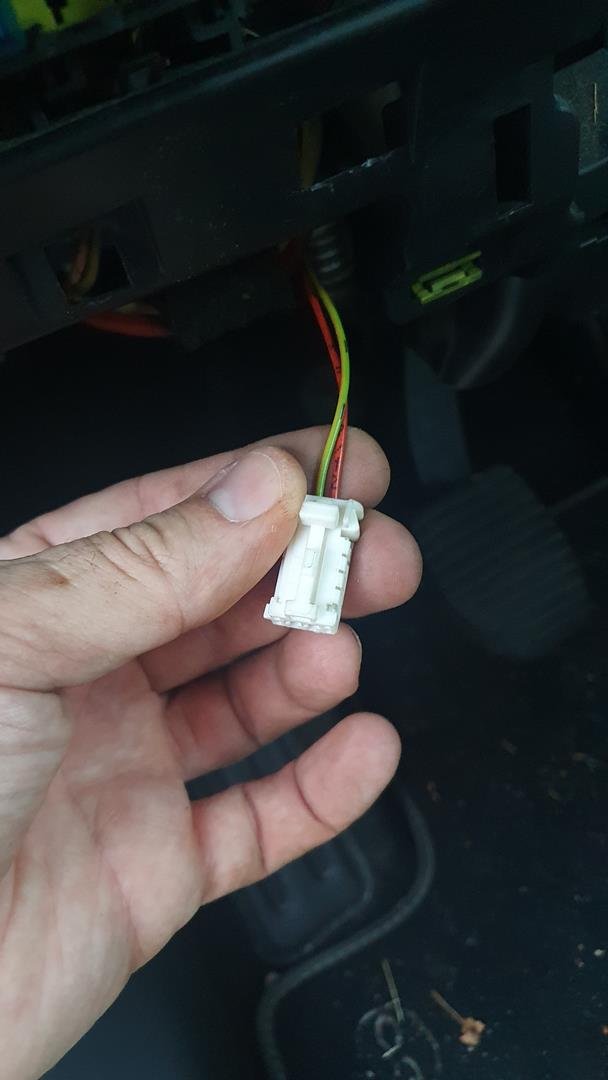

Ok, i found BT module... in many forums people writes that is over passanger feet... mayby in UK version, but in Europe version it's behind the stering whell over the pedals. So i got it (96 668 279 80 Continental), but why it is not working. Electric plate looks fine, without defects.
I see one plug with wire wchich is not in socket, and i do not see any socekt, any place to plug it. Close to fuses place.
Somebody, please help

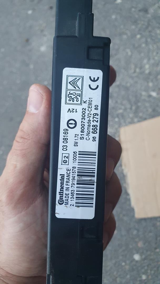

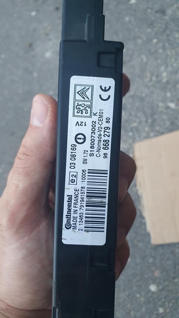

Ok, resolved. No answer here, so i decided that i will change Continental module to other one - i bought new - and now it works.

Sorry, I've only just seen the post.
A bit late now, but some vehicles were fitted with the RD4 (as in your case) and this model has no built in Bluetooth. However, it was an option on order to specify a hands-free kit. This seems to be the case in your vehicle. So the Bluetooth and other functions are handled by the hands free or 'Nomad' kit and the data is routed to the RD4 and the compatible display.
Some later vehicles had an RD45 fitted, which eliminated the Hands-free module, as it had Bluetooth integrated into the Head Unit and would handle all operations.
In your case the nomad unit may have failed and so it looks like you have replaced it now.

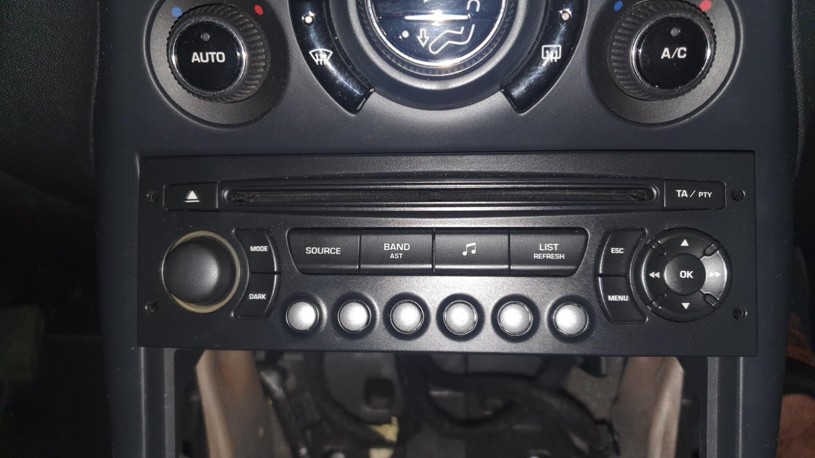

I'll get the thing indoors and have a proper rummage, it's rather silly that the cable is clearly there somewhere, but can't be found. I'll order-up some thin cable anyway, it's not a major hassle for me to make a loom.
For now I've slapped the head unit in, matched the VIN, enabled the rear speakers and a couple of other things, all seems good so far.

Tonight, tried uSB playback - all good - and came up with a new question.
Does the RD 45 have "Bass" and "Treble" adjustments? At the moment, th eone I have allows you to set the eq mode - Pop, Classical, etc., but not Bass or Treble. Mildly surprising.
- Posts: 10998
- Joined: 09 Nov 2005, 22:03
- x 1472
Re: Is upgrading RD43 to RD45 feasible?
The button with the musical notes on it (assuming you have one) should cycle through balance, bass, treble etc.shtu wrote: 21 Oct 2024, 18:40 Does the RD 45 have "Bass" and "Treble" adjustments? At the moment, th eone I have allows you to set the eq mode - Pop, Classical, etc., but not Bass or Treble. Mildly surprising.
