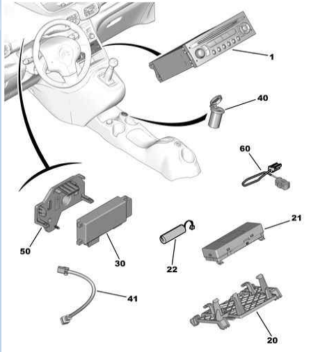

Hi, so you have a C3 PICASSO FAMILY SALOON 1.6 HDi 110 particle emission filter (DV6TED4) Manual gearbox 5. This vehicle was factory fitted with the RD45 MP3 system and is also fitted with a jack socket and USB connector. Although this is referred to as the RD45, there does seem to be an RD43 sub-variation for the C3 Picasso, dependent on Country (so you were quite correct there - apologies). So oddly, MP3 but no Bluetooth is one of the 3 flavours this unit comes in.
From what I've checked, you already have the microphone, but would still need to have the RD45 unit that supports bluetooth AND you will need the correct telephone interface unit. Your unit is the 6574 KS (WITHOUT HANDS-FREE TELEPHONE KIT AND 1 JACK SOCKET + USB AND PART TO BE CONFIGURED) and you would need the 6574 TS part which is described as (WITH HANDS-FREE TELEPHONE KIT AND 1 JACK SOCKET + USB AND PART TO BE CONFIGURED).
You don't have the independent telematic unit (part 21), backup battery (part 22) or the mounting support (part 20), so shouldn't have the Citroen button or SOS logos on the dash.
In this diagram you should have parts 50 - Tel Interface Unit Support, 30 - Telephone interface unit, 40 - USB Port, 41 - USB Socket Harness and Part 60 - the Microphone.

Re: Is upgrading RD43 to RD45 feasible?
Unread post by patriotbarrow »
This is mind-blowingly thorough information! WOW!
So in depth, that I am confused as to what exactly I need. I need the RD45 head unit and 6574 TS telephone interface unit. Correct? If that's the case, I know where I can source an RD45 from. The telephone control unit, however, I am stumped. Maybe look for them in scrapped cars?
