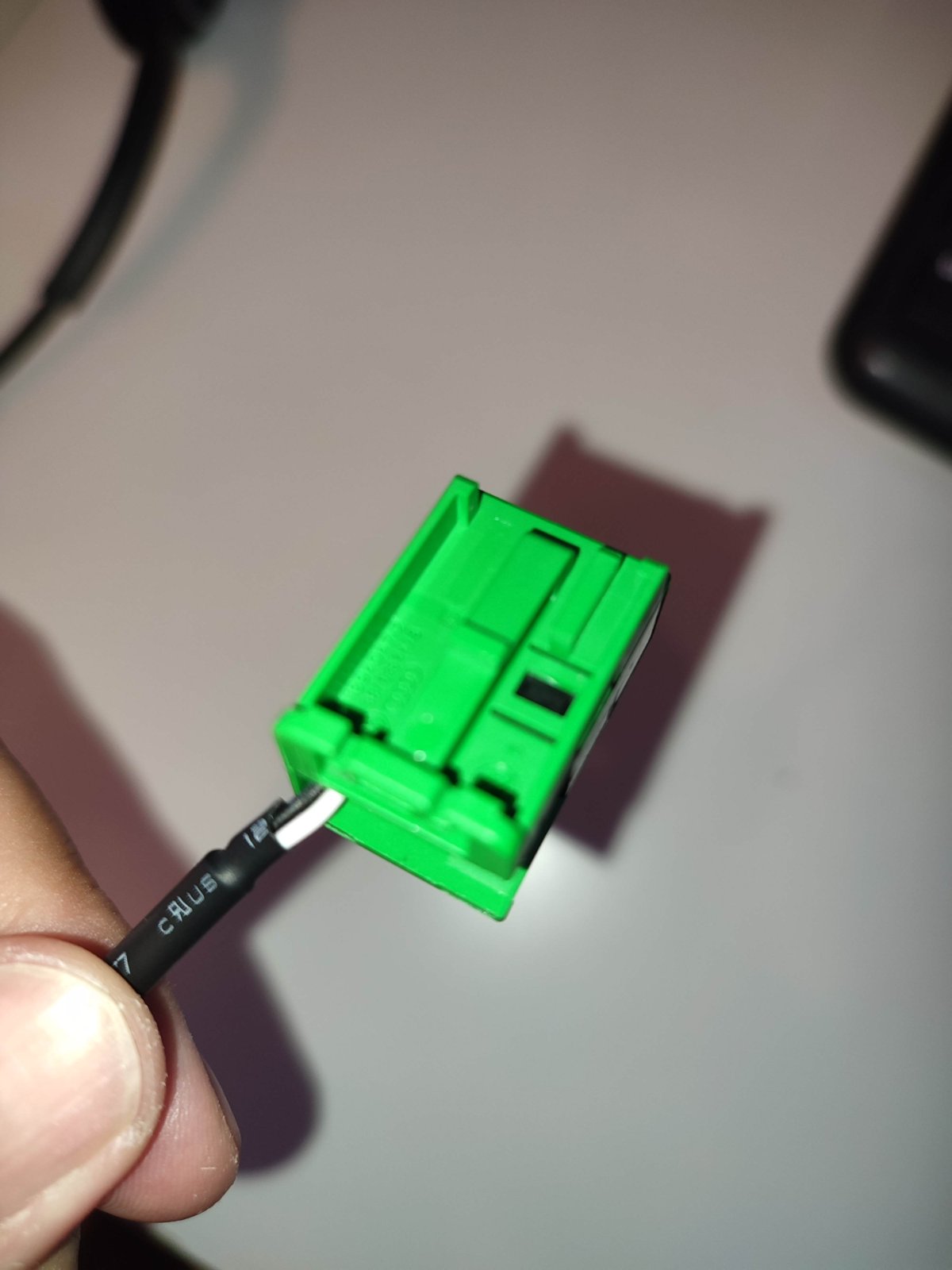

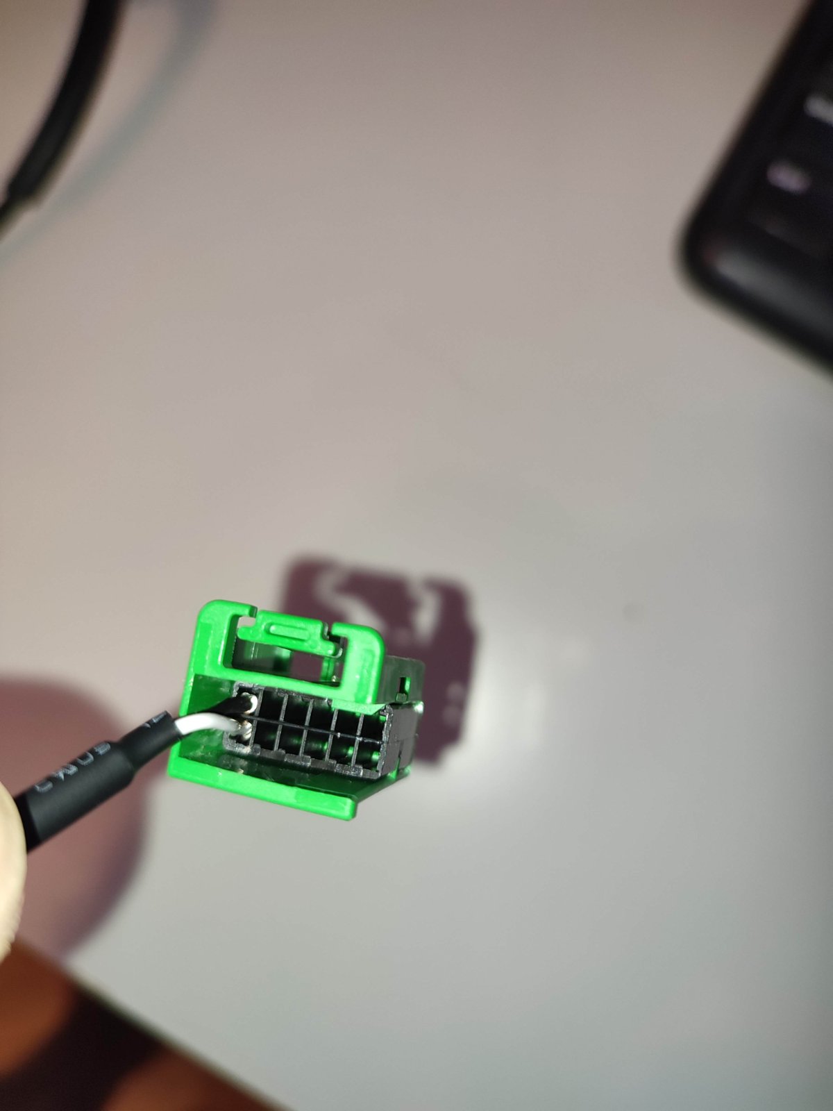

I just received cable for microphone from the ebay but I am little confused about pinout. Is this proper pin positions for it?
I think that I found someone on the net 3 i 9 positions for microphone and 1-7 for aux. Thanks.

RD45
Block 'ac'
Pin 3 Microphone Earth
Pin 9 Microphone Positive

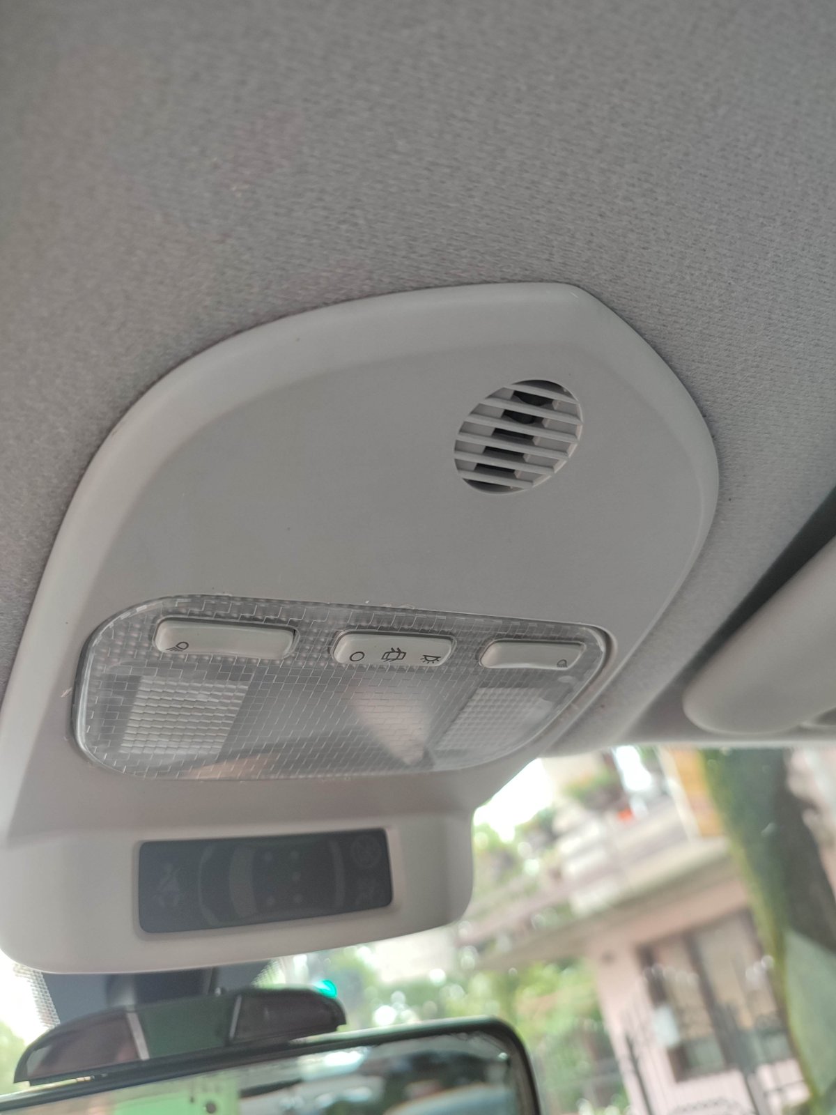

Btw, what is a proper place for microphone? I put it on the left side but after that I saw that it could be in the middle of the roof. This is a placeholder for it?
See photos ->
I had a problem with one broken pin, it was broke during moving to other position.
I am waiting for other usb cable to complete action
See photos ->
- x 6946
Re: Peugeot 308 (2008) RD4 -> RD45
That's where the official microphone is, but you may find it a job because often these are connected to the vehicle loom via a ribbon cable and trying to find out where it comes out can be almost impossible, so better to fit your own. You can generally fit one in the recess and wire it directly into the connector or keep your current setup.
