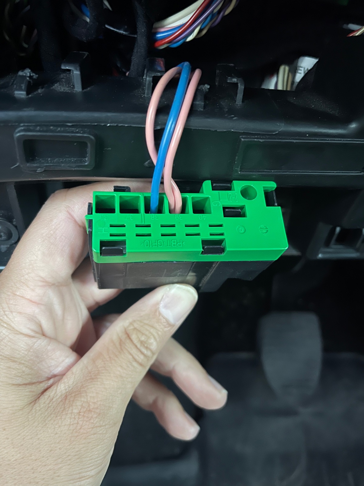

So the maxi fuses are under that first part?
The box are a little small to have two parts.
I have show the pictures of the fuse box inside engine bay.
The cable to connect BFH1 are blue? I have to find that cable. Its very strange not to be there.
x 6956
Re: DS3 Hi-Fi Sistem - Help Needed
Yes, you have the main engine fuse box and another part usually underneath the fuse box or to the side that contain the large maxi fuses.
The Maxi Fuse MF7 supplies power to the BFH1 and this has to be there as you have the heated seats fitted on your vehicle which this also supplies power too.
You already have the 2 fuses there.
F36 would be fitted if you had the trailer relay fuse box.
F37 is Blank
F38 is for the HiFi Amp
F39 is for the Heated Seats
F40 was a second fuse for the Trailer Relay Fuse Box.
So if you have power there, you may be missing the actual wire from F38 top the HiFi Amp due to the incorrect fascia harness that I mentioned back in my early post.

No i have both.
The 2 pink wires are to heated seats and the blue one are to Hi-Fi.
Only thing it misses is the cable to power up that two system’s.
Regards.

Youi have 3 cables there.
What are the codes on the cables? They are printed every few inches on the sheath, so you may need to unwrap the larger insulation tape that covers the bundle of wires to read them. Let me have the codes.

GiveMeABreak wrote: 22 Jul 2022, 10:03 Youi have 3 cables there.
Hello,
I will see that later.
But i find the disconnected cable.
Some low life have hidden the cable. Now i have heated seats and Hi-Fi is now working, but not on multiplex jus normal amplifier, strange.
But i have two versions to test one is A515 and other A515_R1. I have mounted the A515.
On the afternoon i will see the code on the cable to tell you :mrgreen:
Much Thanks on solving that =D>
You Deserve a Large Beer :dom:
Regards.
