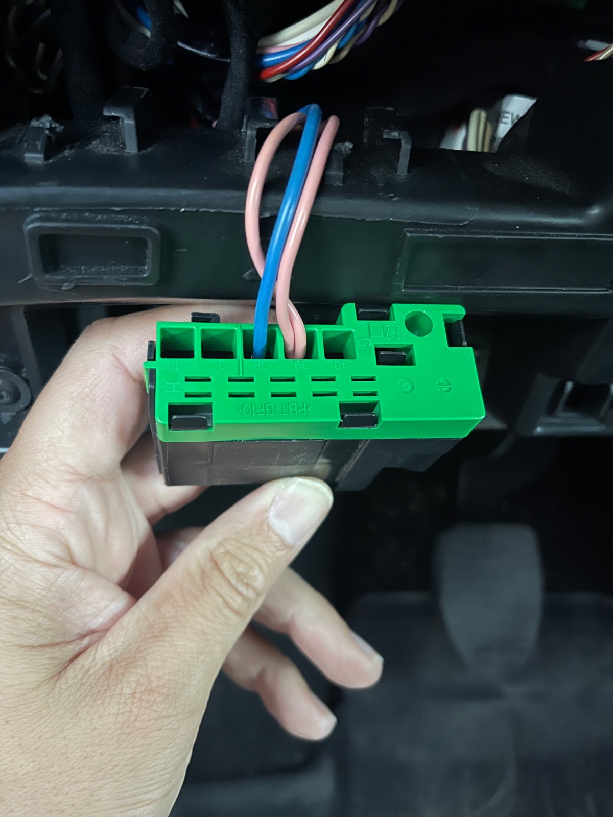

So the maxi fuses are under that first part?GiveMeABreak wrote: 21 Jul 2022, 21:57GiveMeABreak wrote: 21 Jul 2022, 20:17 Yes there has to be a wire from the BFH1 fuse box to the Engine Fuse Box (PSF1) otherwise there will be no power. BFH1 should be connected to Maxi Fuse MF7. That's the larger fuses that are usually under the main engine fuse box.
The box are a little small to have two parts.
I have show the pictures of the fuse box inside engine bay.
The cable to connect BFH1 are blue? I have to find that cable. Its very strange not to be there.

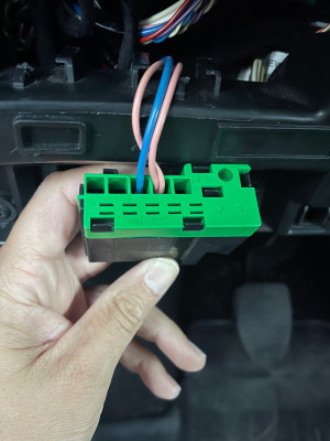

Good Morning,
No i have both.
The 2 pink wires are to heated seats and the blue one are to Hi-Fi.
Only thing it misses is the cable to power up that two system’s.
Regards.

Youi have 3 cables there.
What are the codes on the cables? They are printed every few inches on the sheath, so you may need to unwrap the larger insulation tape that covers the bundle of wires to read them. Let me have the codes.

Hello,GiveMeABreak wrote: 22 Jul 2022, 10:03 Youi have 3 cables there.
I will see that later.
But i find the disconnected cable.
Some low life have hidden the cable. Now i have heated seats and Hi-Fi is now working, but not on multiplex jus normal amplifier, strange.
