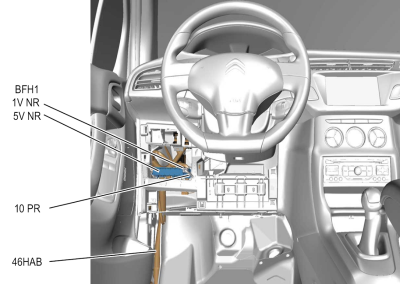

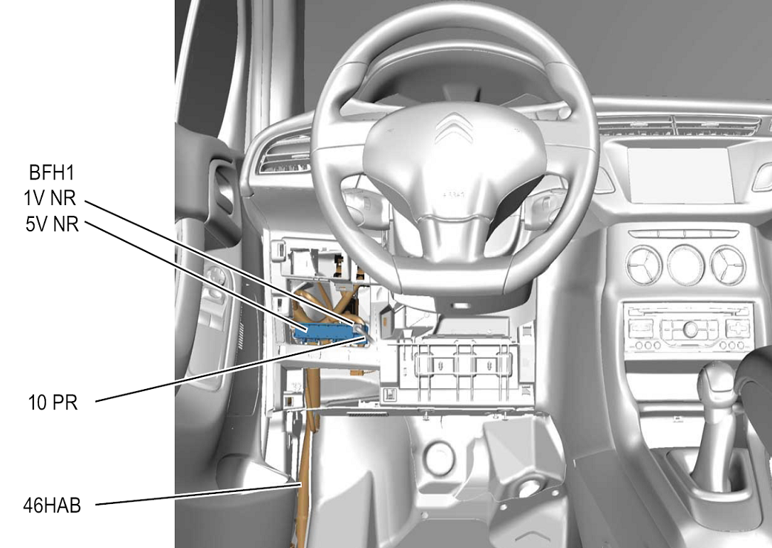

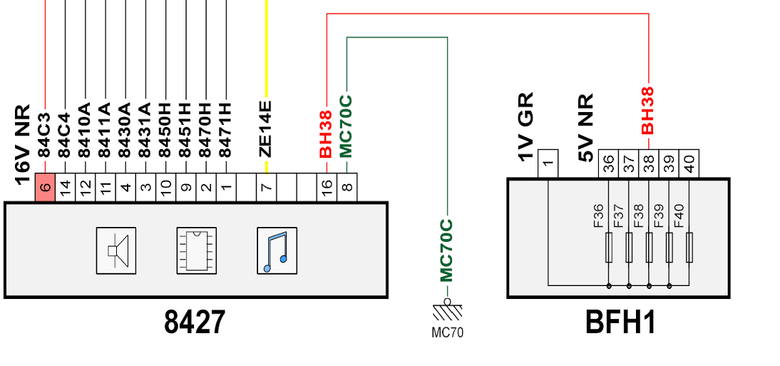

Regarding the fuses, yes the Hi Fi Amplifier has a separate fuse. Now I don't have an updated wiring diagram, but this one is for a previous telematics unit with Hi Fi Amp.
This is the specific fuse box location for BFH1. It is Fuse F38 and is 20A for the HiFi system. Fingers crossed that may be the one.
Here you can see BFH1 is the fuse box in question. 8427 is the Loudspeaker Amp and you can see there is a live that goes to the BFH1

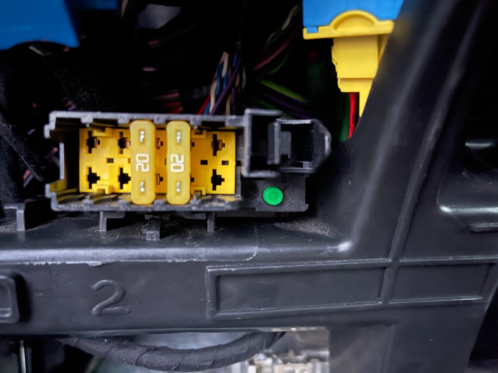

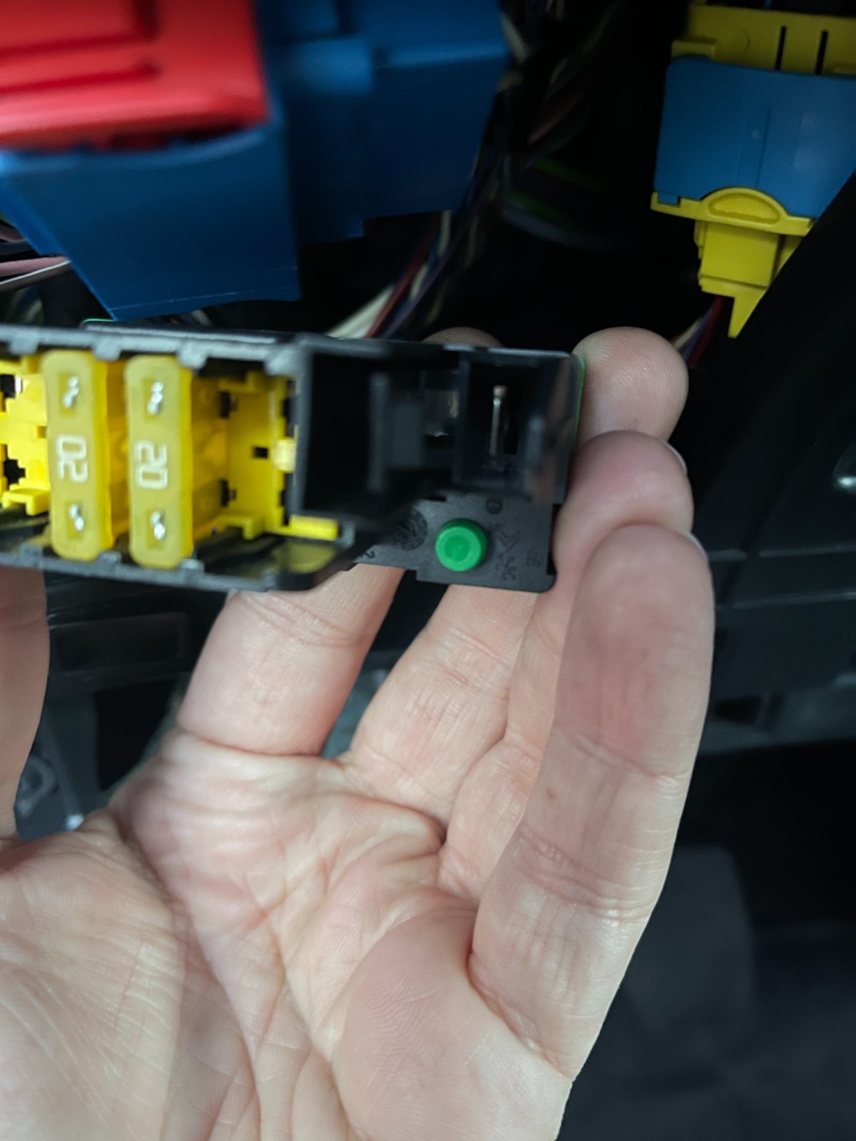

Re: DS3 Hi-Fi Sistem - Help Needed
Yes.
I have that fuse box with two fuses from origin.
One for the Hi-Fi (that was not come from factory) and other for the heated seats that never worked.
F38 - Hi-Fi
F39- Heated Seats
The two fuses of 20A are visually fine, but maybe they are both faulty?
Regards.
Cascabulho
- Posts: 21
- Joined: 21 Jul 2022, 18:35
- x 1

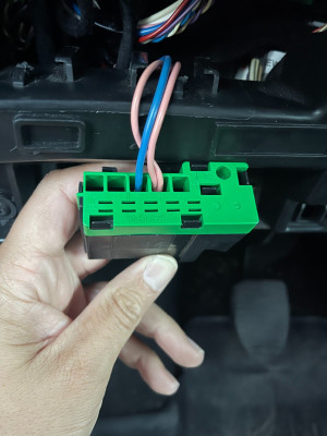

I have consulted several diagrams.
The extra fuse box (BFH1) are connected to the PSF1 or BSM correct?
But the strange things is that i have 2 wires on heated seats, one wire to the Hi-Fi, but no wire to connect the BFH1 to the PSF1 strange....
- x 6956
Yes there has to be a wire from the BFH1 fuse box to the Engine Fuse Box (PSF1) otherwise there will be no power. BFH1 should be connected to Maxi Fuse MF7. That's the larger fuses that are usually under the main engine fuse box.

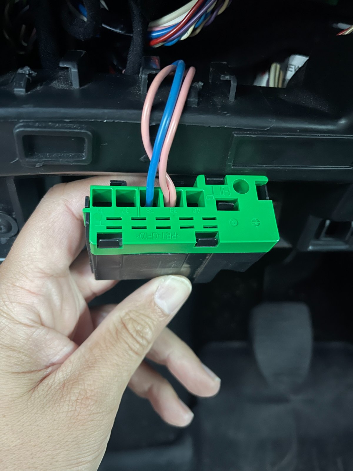

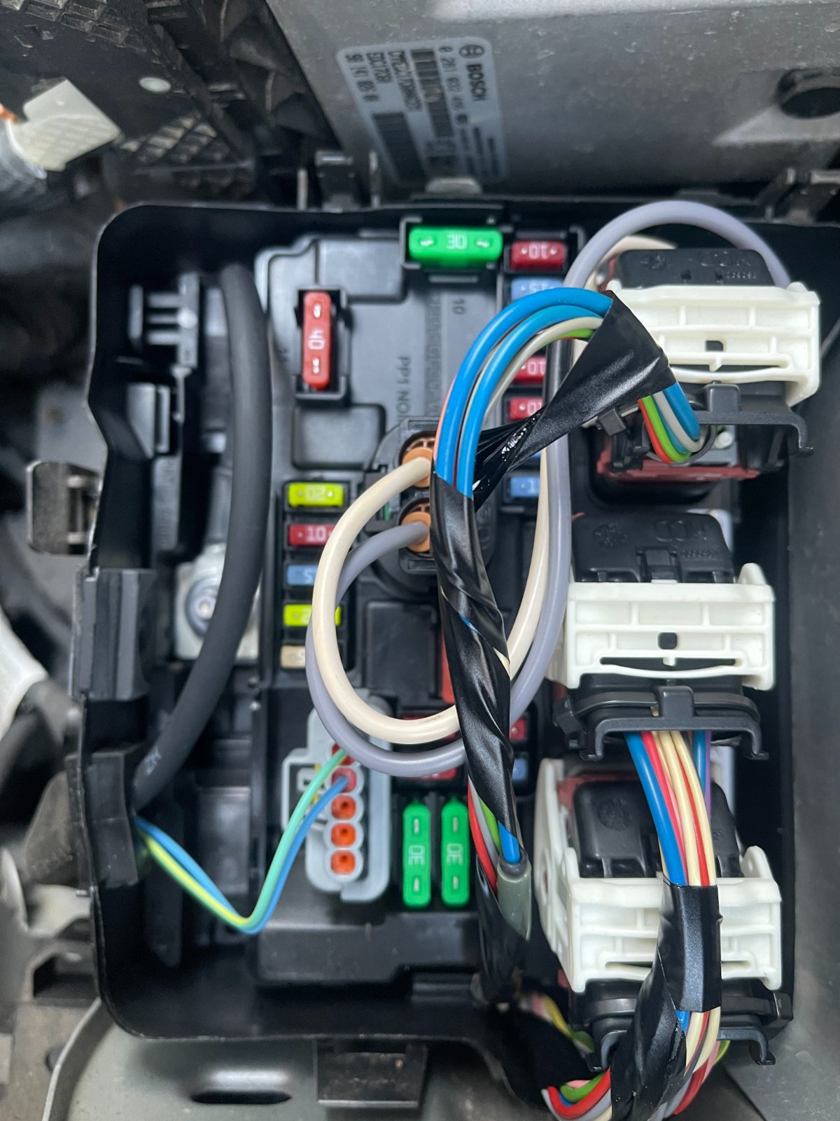

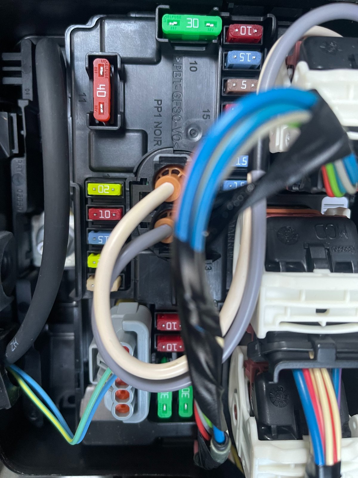

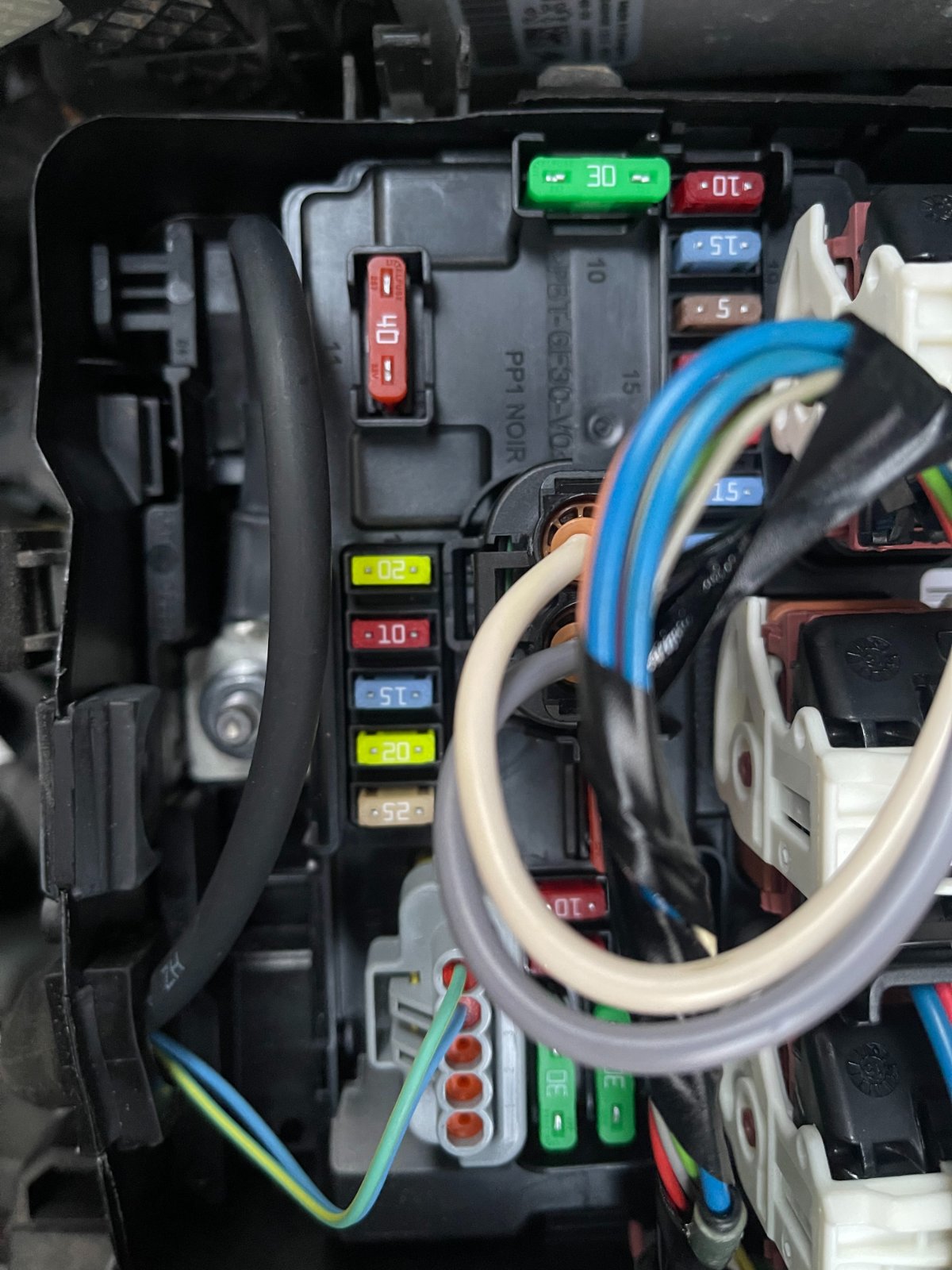

Cascabulho
- Posts: 21
- x 1
Please see my pictures.GiveMeABreak wrote: 21 Jul 2022, 20:17 Yes there has to be a wire from the BFH1 fuse box to the Engine Fuse Box (PSF1) otherwise there will be no power. BFH1 should be connected to Maxi Fuse MF7. That's the larger fuses that are usually under the main engine fuse box.
The cable that is missing is connected on the right end side correct?
I didn't find the 80A MF7. I presume that it will be on another place?
- Posts: 14306
- x 3306
Maxi Fuses are usually somewhere in the engine bay fusebox.
