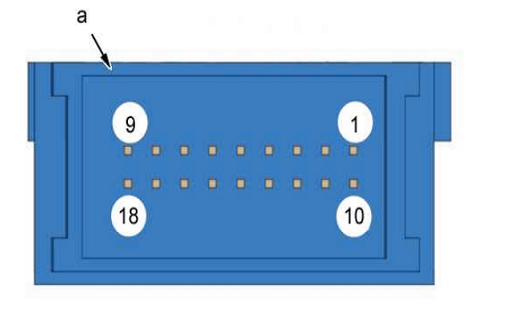

Pin Outs for the Independent Telematic Unit
You had a factory fitted RD4, not RD45.
In addition you have the independent telematic unit fitted that provides geolocation services in the event the airbags are triggered. It also provides the functionality for the Assistance and Emergency call buttons.
Because of this, your microphone will be wired into this telematic unit and not into the quadlock for obvious reasons so the emergency services / assistance can communicate with you. I would leave this alone as you don't want to cripple the system.
I think it's better you try and fit a separate microphone and wire that into the back of the quadlock directly. I would expect that the outputs for the Mic would end up going to the head unit - but I can't say for sure.
This is what the telemaic unit looks like.
"a" 18-way black connector

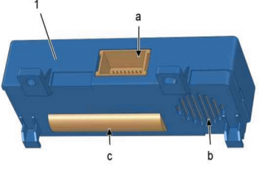

Ok, we need to do a rewind.... this is why we usually ask for the VIN upfront - so it avoids all the confusion.
You had the RD4 basic Head unit, plus
You have the Telephone interface kit fitted
This is where the USB port is connected to and allows depending on level of the unit, streaming of bluetooth files and bluetooth telephone function. This is also where the AUX connections will go
'a' is where the USB port connects to.
Location
The Hands Free / USB Box is located here:
Plus
You have the Independent Telematics unit fitted
This is as I described previously regarding emergency assistance and geolocation.
No. the orange display is the Multifunction screen
The independent telematics unit is hidden and is separate. It is located inside the dash above the passenger (right) side on a left hand drive DS3. It's above the glovebox, and access needs the glovebox lod and air vent removing:
"b" Bonnet locking 18
Plus
I'm off for a large coffee now...

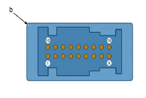

There are 3 systems in play here and they are all interconnected. Obviously I can't advise any bypass of the independent telematic unit as it's a safety device and could save lives in an accident.
What I can tell you is that on the DS3 with an RNEG (MyWay) fitted as standard and with the Independent Telematic unit (ITU) also fitted:
1) The Microphone wires from the Mic go to Pin 1 (+) and Pin 10 (-) on the ITU.
2) From there they exit the ITU on pin 2 (+) and pin 11 (-)
3) They enter the MyWay unit on pin 9 (+) and pin 3 (-) (see relevant diagram on previous post for clock)
This ensures that the emergency call system is kept working.

1) Quality
2) No, because you are forgetting the 3rd piece of kit - the USB connecting Box. On the original setup of your vehicle:
They exit the ITU on pin 2 (+) and pin 11 (-)
They enter the USB Connecting Box on Pin 8 (-) and pin 9 (+) (on the 18 Pin white connector).

So I went on the brown connector and cut the PIN 3 cable. Still rotates sometimes l.
Remember I had the older brown connector from the RD4 display
My RNEG display did not bring a connector and I have found one on my electrician but it's missing PIN 2 and PIN 5
Anyway. I don't know what other ground I should cut away...
Maybe PIN 6?
I think ive managed to make it work (Dont know for sure)
However i plugged PIN 3 to PIN 16
And PIN 1 is connected on the older connector from the RD4 (12v) i guess.
Since i dont have a diagram of the RT4 brown connector display i cant do much
Do you have one? I can´t find it
