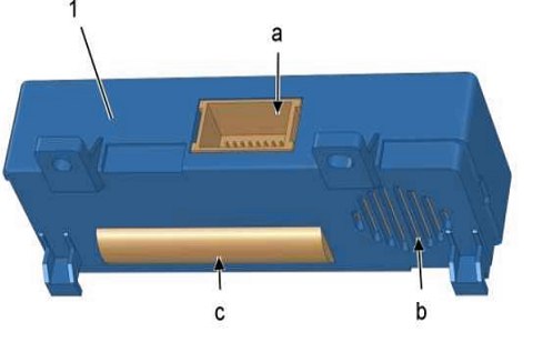

Right, that clarifies things...
You had a factory fitted RD4, not RD45.
In addition you have the independent telematic unit fitted that provides geolocation services in the event the airbags are triggered. It also provides the functionality for the Assistance and Emergency call buttons.
Because of this, your microphone will be wired into this telematic unit and not into the quadlock for obvious reasons so the emergency services / assistance can communicate with you. I would leave this alone as you don't want to cripple the system.
I think it's better you try and fit a separate microphone and wire that into the back of the quadlock directly. I would expect that the outputs for the Mic would end up going to the head unit - but I can't say for sure.
This is what the telemaic unit looks like.
Pin Outs for the Independent Telematic Unit

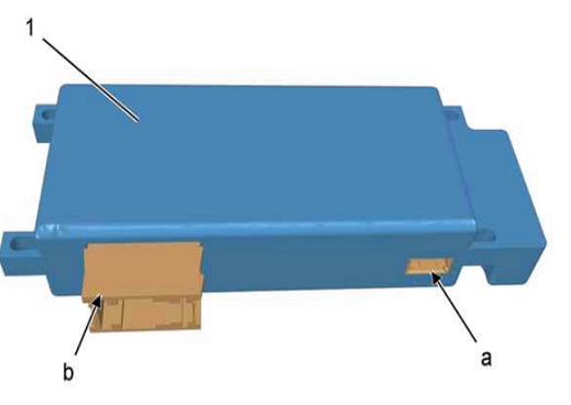

Ok, we need to do a rewind.... this is why we usually ask for the VIN upfront - so it avoids all the confusion.
You had the RD4 basic Head unit, plus
You have the Telephone interface kit fitted
This is where the USB port is connected to and allows depending on level of the unit, streaming of bluetooth files and bluetooth telephone function. This is also where the AUX connections will go
'a' is where the USB port connects to.
Location
The Hands Free / USB Box is located here:
Plus
You have the Independent Telematics unit fitted
This is as I described previously regarding emergency assistance and geolocation.
No. the orange display is the Multifunction screen
The independent telematics unit is hidden and is separate. It is located inside the dash above the passenger (right) side on a left hand drive DS3. It's above the glovebox, and access needs the glovebox lod and air vent removing:
I'm off for a large coffee now...
