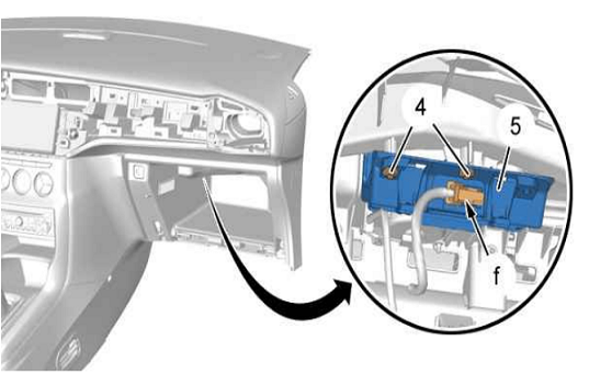

Re: RNEG Doubts!!! Help pls
Ok, we need to do a rewind.... this is why we usually ask for the VIN upfront - so it avoids all the confusion.
You had the RD4 basic Head unit, plus
You have the Telephone interface kit fitted
This is where the USB port is connected to and allows depending on level of the unit, streaming of bluetooth files and bluetooth telephone function. This is also where the AUX connections will go
'a' is where the USB port connects to.
Location
The Hands Free / USB Box is located here:
Plus
You have the Independent Telematics unit fitted
This is as I described previously regarding emergency assistance and geolocation.
No. the orange display is the Multifunction screen
The independent telematics unit is hidden and is separate. It is located inside the dash above the passenger (right) side on a left hand drive DS3. It's above the glovebox, and access needs the glovebox lod and air vent removing:
I'm off for a large coffee now...
Ahhh man! Now i got it!
So now:
You say we should not mess with the original microphone because its connected to the telematics right?
My idea was to remove it from the telematics, and connect to the quadlock (Part B- Pin -3 and +9)
Which pins could i remove from telematics and connect to the quadlock? PIN 1 and PIN 10?
OK now even if i run an external microphone, which i did already! I plugged it on the same pins (3 and 9) and still cannot be heard.
Shouldnt it work? I mean connecting the external microphone directly to the quadlock!
