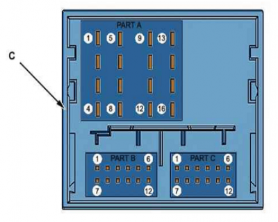

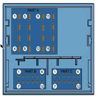

On the RNEG (MyWay) using the same diagram from my previous post:
Part "B": 12-way connector
The Aux Right is on Pin 4
The Aux Left is on Pin 10
Edit: Removed RD45 image (different model).

OK Thanks a lot man i was checking on another website and it showed different pins.
So bottom line in order to get AUX:
Replace PIN 1 ---> PIN 4
PIN 7 ---> PIN 10
And AUX (JACK) Should work?
What about the GND cables? Nothing to change? Just change those 2 cables?
PIN 7 ---> PIN 10

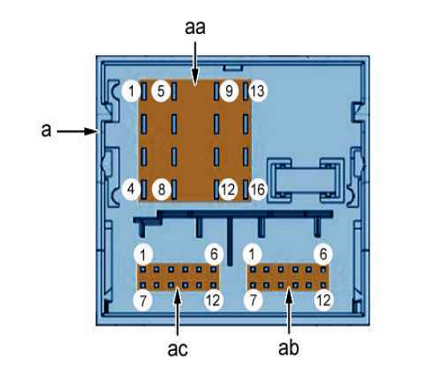

This is the RD45 quad block wiring on a DS3 with RD45:
Normally you would get the wiring connection cables between the screen to the head unit when purchasing.
"ab" 12-way black connector
"aa" 16-way black connector
| "ac" Natural 12-way connector

Ok so for what I see
The microphone is already connected on Pin 3 and 9 so I don't need to change anything for the RNEG??
Also AUX you said that on RD45 it's Pin 1 and 7
They show above not connected..
It shows 4 and 10 PIN..
Or do I need to move the Following?
PIN 4 ----? PIN 1
PIN 10 ---? PIN 7
Am I confusing anything?
PIN 4 ----? PIN 1
PIN 10 ---? PIN 7

Re: RNEG Doubts!!! Help pls
I've think I put up an RD45 from a Peugeot unit - and can see that the pin outs are different on that version, so have removed that image now in my previous post.
The diagram in my post above is correct for a DS3 with RD45.
Below is the complete Pin out for MyWay on a DS3, so now you have both:
MyWay (RNEG) Pin Outs:
Part "A" : Matching the 16 tracks
Part "B": Matching the 12 tracks
| Part "C": Matching the 12 tracks (black) (Only with CD changer)
