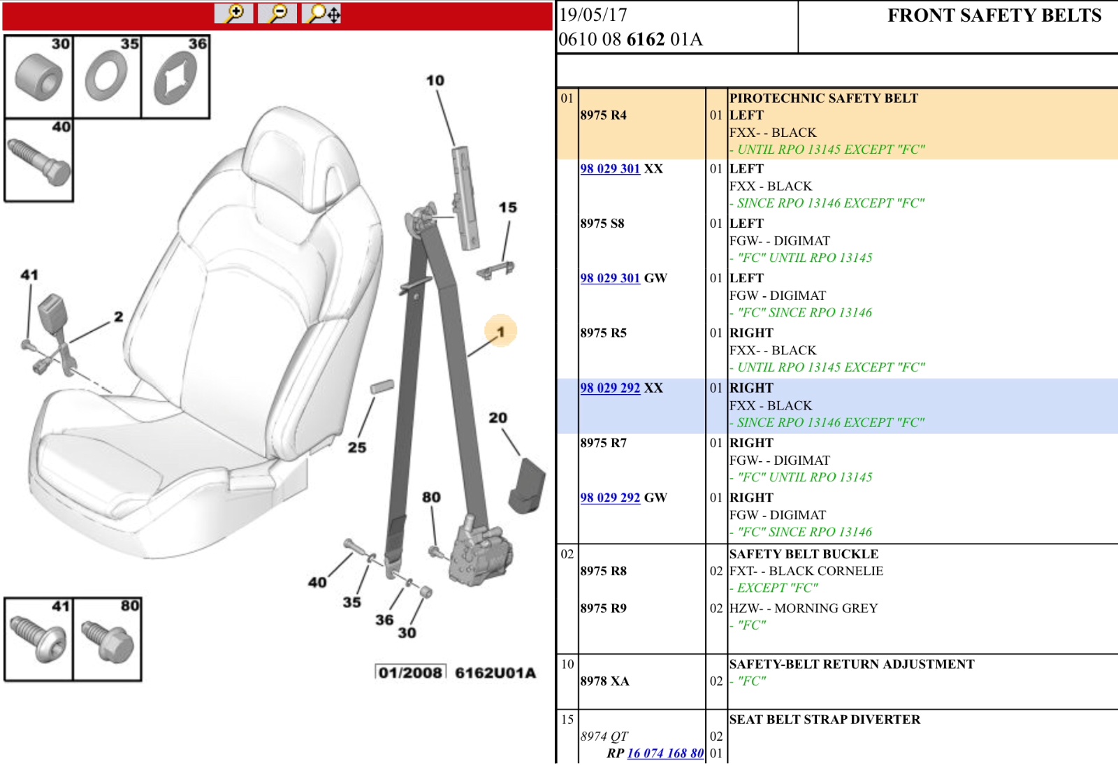

I'm trying to understand and I'm a bit confused. both - Marc and hell razor wrote that the pre tensioner is in the seat. to my humble opinion I think that has to be where the seat belt winding mechanism is, which means that it should be in the base of the column between the front and rear doors, where the seat belt is. I guess so because on the seat, the only thing is the buckle that the seat belt is connected to and you haven't mentioned the "sensor" that indicate the presence of a person in the seat. looking under the seat I can see tow wires that are going to the yellow connector, which I think are the wires from that "sensor". these are all assumptions based on my logic, which might be wrong, of course.

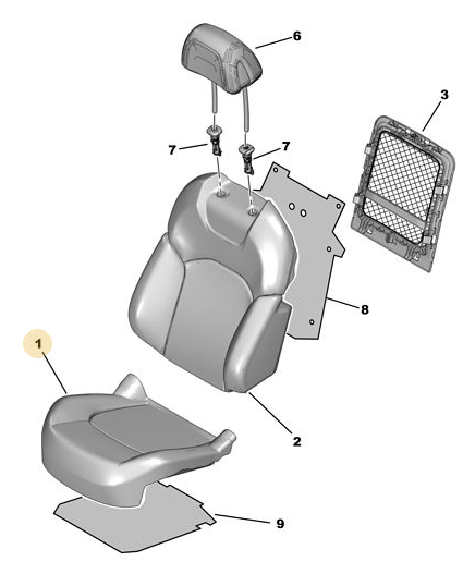

Does seat foam padding exists as spare part - C5 x7

The pre-tensioner is part of the latch strap that the safety belt clips into. It is fastened to the seat (so that, as you move the seat back or forwards it always remains available to clip the belt into). The inertia reel just won't allow the belt to be pulled at speed.

Avi, I didn’t say the pretensioner is in the seat, I said it is in the anchor point. In the X7, the pretensioners are incorporated into the B pillars in the reel system. So yes behind the trims in the pillar between the front and rear seats. The seat belt buckle unit on all seat belts has a switch that informs the seat belt control unit when they are connected or not.atr wrote: 11 May 2019, 19:03 I'm trying to understand and I'm a bit confused. both - Marc and hell razor wrote that the pre tensioner is in the seat. to my humble opinion I think that has to be where the seat belt winding mechanism is, which means that it should be in the base of the column between the front and rear doors, where the seat belt is. I guess so because on the seat, the only thing is the buckle that the seat belt is connected to and you haven't mentioned the "sensor" that indicate the presence of a person in the seat. looking under the seat I can see tow wires that are going to the yellow connector, which I think are the wires from that "sensor". these are all assumptions based on my logic, which might be wrong, of course.
Avi
The wires under the seats will be the airbag connections and the wiring to the buckle switch.

The seat base foam on mine collapsed not long after I got the car. The issue on mine was that the sprung wire frame base had cut right into the foam.

The problem is, Marc, that I've been to a few vehicle upholster shops and was told by every each and one of them that they can't repair the seat because the fabric is somehow glued/combined with the foam, so it can't be taken apart. if you know/have an idea how to overcome this obstacle, please let me know. I was even thinking to buy a seat, even in bad condition as I've mentioned before, just to try and take it apart somehow, trying to learn how it's done.
You've mentioned that it would be bulky to ship it. that's right. what I meant is to buy the seat but only to ship the cushion. if I got it right, it can be separated from the seat and you've even provided me the part number of it.

Yes, the seat base is available (athough no longer available from Citroen parts now) - but it would be a matter of the breakers having to disassemble it for you as you say:
Not great - but a DIY job here - but like I said you would need seat covers if you can't stitch it.

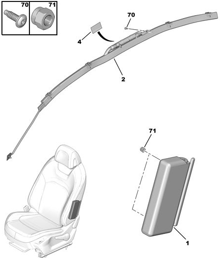

Yes, side air bags and curtain airbags Avi:

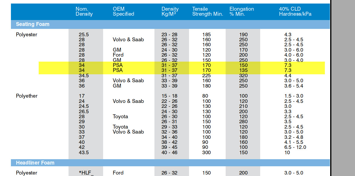

It sounds a lot easier than it actually is........the material is bonded directly onto the foam and unless the repairer/manufacturer has the equipment & ability to re-bond your original cloth onto the new base this is a no goer. I have had my base off and carried out a repair, by filling the void created by the crumbling foam with foam from a local shop (DunelmCutac wrote: 09 Nov 2019, 11:16 Why don't you ask an upholstery shop to make a new base? Give them your old one and using it as a model, they should be able to make a new foam piece and then upholster it.
It wouldn't be cheap, but it's doable.
For those who want to know see the attached in respect to the foam grade required. Taken from here https://www.euromoulders.org/publicatio ... 3084701e1d
Stu
