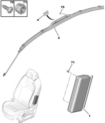

Going to look into this cost wise assuming that Citroen will have put in place different plugs for L/R seats regardless to which seat had the steering wheel in front of it, air bags will be on the outer side so cannot swap them L/R

Are there airbag/s in the seat?Admiral51 wrote:Going to look into this cost wise assuming that Citroen will have put in place different plugs for L/R seats regardless to which seat had the steering wheel in front of it, air bags will be on the outer side so cannot swap them L/R

Yes, side air bags and curtain airbags Avi:
