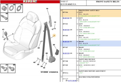

I'm trying to understand and I'm a bit confused. both - Marc and hell razor wrote that the pre tensioner is in the seat. to my humble opinion I think that has to be where the seat belt winding mechanism is, which means that it should be in the base of the column between the front and rear doors, where the seat belt is. I guess so because on the seat, the only thing is the buckle that the seat belt is connected to and you haven't mentioned the "sensor" that indicate the presence of a person in the seat. looking under the seat I can see tow wires that are going to the yellow connector, which I think are the wires from that "sensor". these are all assumptions based on my logic, which might be wrong, of course.

The pre-tensioner is part of the latch strap that the safety belt clips into. It is fastened to the seat (so that, as you move the seat back or forwards it always remains available to clip the belt into). The inertia reel just won't allow the belt to be pulled at speed.

atr wrote: 11 May 2019, 19:03 I'm trying to understand and I'm a bit confused. both - Marc and hell razor wrote that the pre tensioner is in the seat. to my humble opinion I think that has to be where the seat belt winding mechanism is, which means that it should be in the base of the column between the front and rear doors, where the seat belt is. I guess so because on the seat, the only thing is the buckle that the seat belt is connected to and you haven't mentioned the "sensor" that indicate the presence of a person in the seat. looking under the seat I can see tow wires that are going to the yellow connector, which I think are the wires from that "sensor". these are all assumptions based on my logic, which might be wrong, of course.
Avi
Avi, I didn’t say the pretensioner is in the seat, I said it is in the anchor point. In the X7, the pretensioners are incorporated into the B pillars in the reel system. So yes behind the trims in the pillar between the front and rear seats. The seat belt buckle unit on all seat belts has a switch that informs the seat belt control unit when they are connected or not.
The wires under the seats will be the airbag connections and the wiring to the buckle switch.
