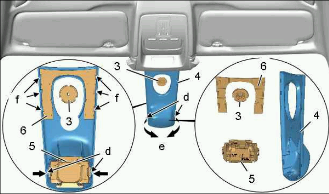

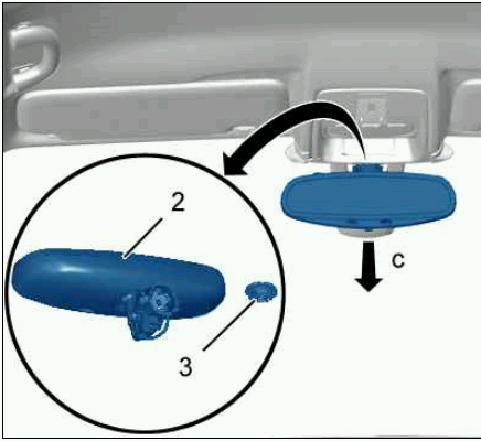

nigelrobson
- Posts: 2
- Joined: 14 Apr 2015, 16:02
Re: Original reversing camera for RT6 - Citroen C5 X7 2015
Very good Marc, can't tell you how helpful this is. I see also that going for a mirror video does away with the necessity of rear bleeping sensors too. And you are right , the price difference is amazing.
As for the estate question (was thinking more difference of saloon or estate) I see now elsewhere that the wiring for the camera doesn't need to go to the tailgate but the camera can be bumper mounted and wiring connected to the reverse cabling in the inside the car not needing wires into the tailgate.
The only thing that bothers me about the example you mentioned with auto dimming lcd mirror and camera http://www.frenchcarforum.co.uk/forum/v ... =3&t=52248 , is the fixing bracket. Mine, unlike the example, is already an auto dimming mirror and doesn't seem (as far as I can make out) to have the same bracket fixing. However if I clarify that I am quite tempted by that option - seems stylistically similar to the original but of course the wiring might be challenging.
Thanks a lot for your comments. If you can point me to a resource that might show the fixings for my existing auto dimming mirror I'd be delighted.
best wishes
Nigel
best wishes
Nigel
- x 6955
Hi Nigel - the following pics should give you some idea of the fitting. From what you've said, I'm assuming you have the electrochrome mirror. If that's the case, then it will have a shell in 2 halves as per the picture below that need to be carefully prised apart (the plastic lugs are delicate). After that, you can carefully disconnect the wiring plug for the rain and brightness sensor (but whatever you do don't remove the sensor pad from the windscreen, or you may up with air bubbles behind it, reducing functionality & they're £240+ a pop!) The mirror itself is removed by tilting it forwards (direction 'C') in the second picture. You should be able to see the type of fixing now.
Failing that - you could go for one of the clip-over types which attach to the existing mirror and only activate when you engage the reverse gear; when not in use it provides a larger viewing ange as I think it's a 7" monitor type.
