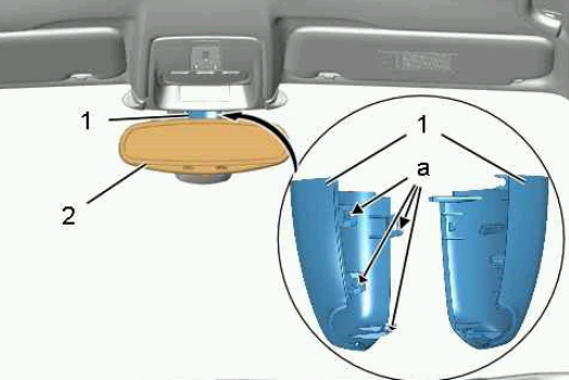

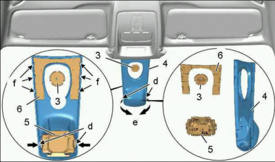

Hi Nigel - the following pics should give you some idea of the fitting. From what you've said, I'm assuming you have the electrochrome mirror. If that's the case, then it will have a shell in 2 halves as per the picture below that need to be carefully prised apart (the plastic lugs are delicate). After that, you can carefully disconnect the wiring plug for the rain and brightness sensor (but whatever you do don't remove the sensor pad from the windscreen, or you may up with air bubbles behind it, reducing functionality & they're £240+ a pop!) The mirror itself is removed by tilting it forwards (direction 'C') in the second picture. You should be able to see the type of fixing now.
Failing that - you could go for one of the clip-over types which attach to the existing mirror and only activate when you engage the reverse gear; when not in use it provides a larger viewing ange as I think it's a 7" monitor type.
