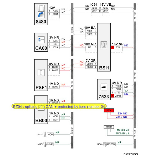

You haven't said why the camera did not come with the car - odd, but you have the correct Parking Assistance ECU (6590 EC or EE) that supports the Camera.
Whilst you are checking the configuration again, here's the wiring for you to check:

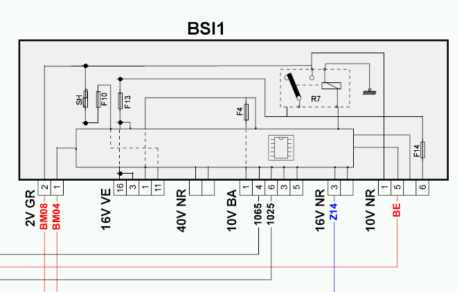

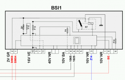

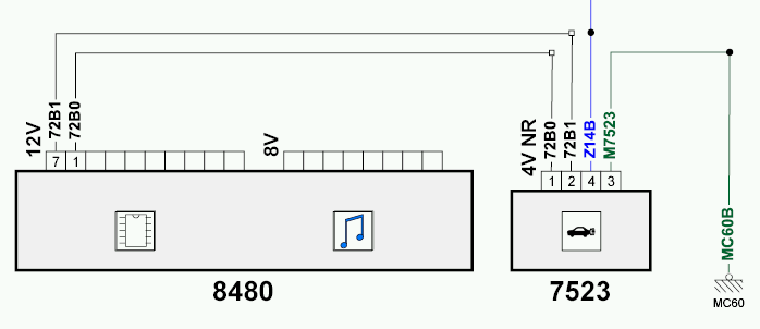

72B0 & 72B1 go from the Camera to the back of your Head Unit - as you've said on pins 7 & 1. Z14B goes to the BSI - should be into a 16 Pin Black Connector as seen in the second picture - so worth checking if that wire is there or not. The green is your earth.
I would certainly get your firmware updated first though - always a good idea.

Let's talk about connection. Pin 1, wire 72B0, is video positive signal which is the middle pin of the usual universal camera Cinch connector. Pin 7, wire 72B1, is video negative signal, which should be the outer pole of that cinch, this is normally earth, minus, in this case signal earth. Pin 3, wire M7523, is the earth. Pin 4, wire Z14B, is marked as CAN+, and this should be the +12V fo the camera.
So, in case the camera will work and iam going to install the original camera, i have to do the wiring myself, because there is original wiring missing anyway.
At least from the dashboard where should be the connector IC91:
