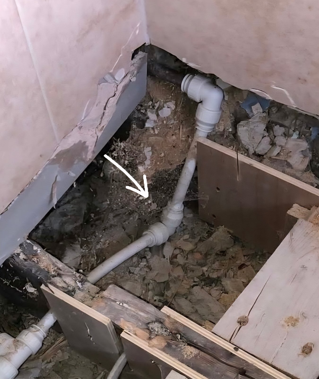

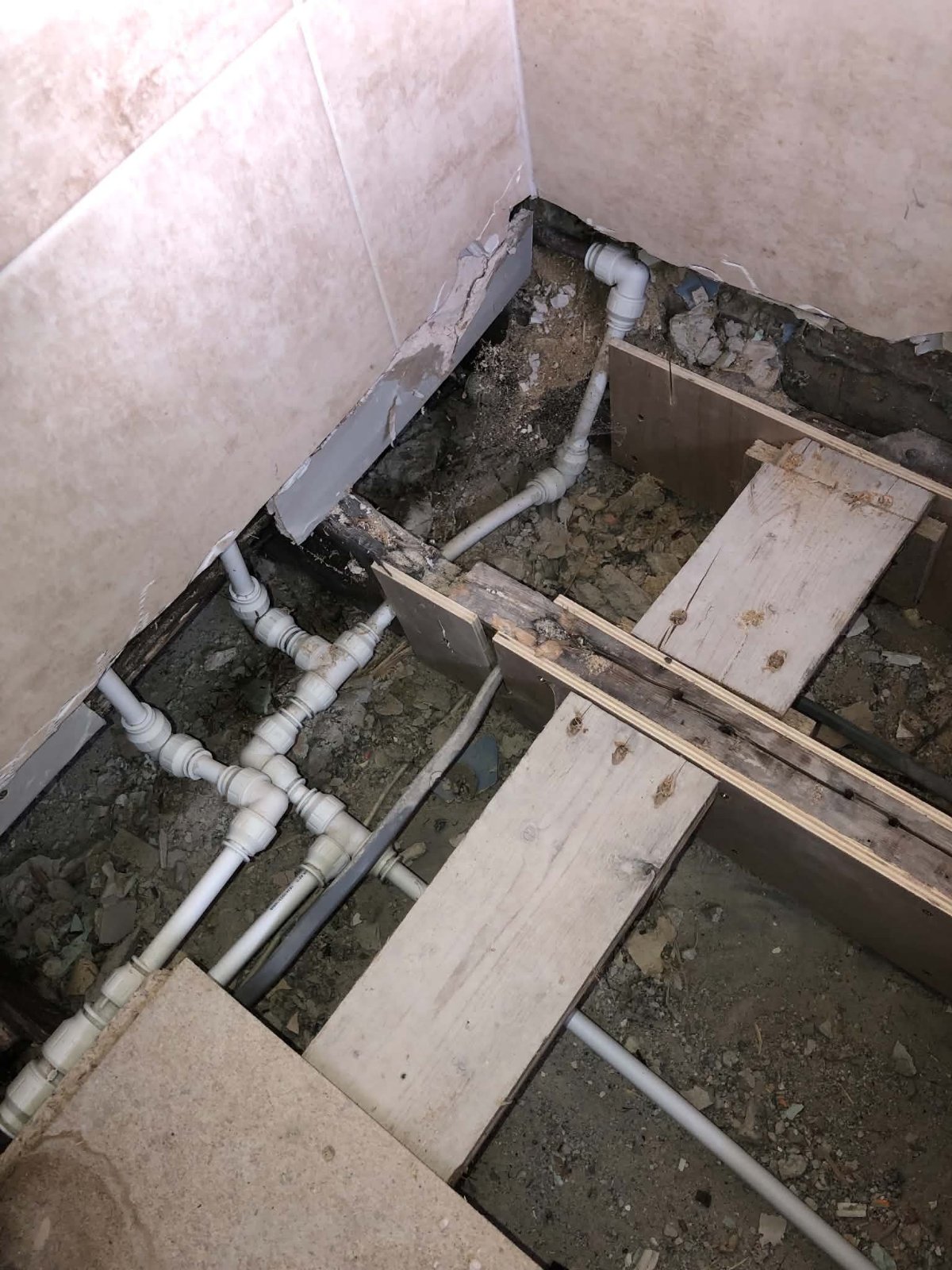

This is going to be my last big DIY job for my Daughter ...the fully tiled shower room was (imo) the best finished room in the house but she want a makeover so I've convinced her to let me do a partial makeover and save a few grand ...

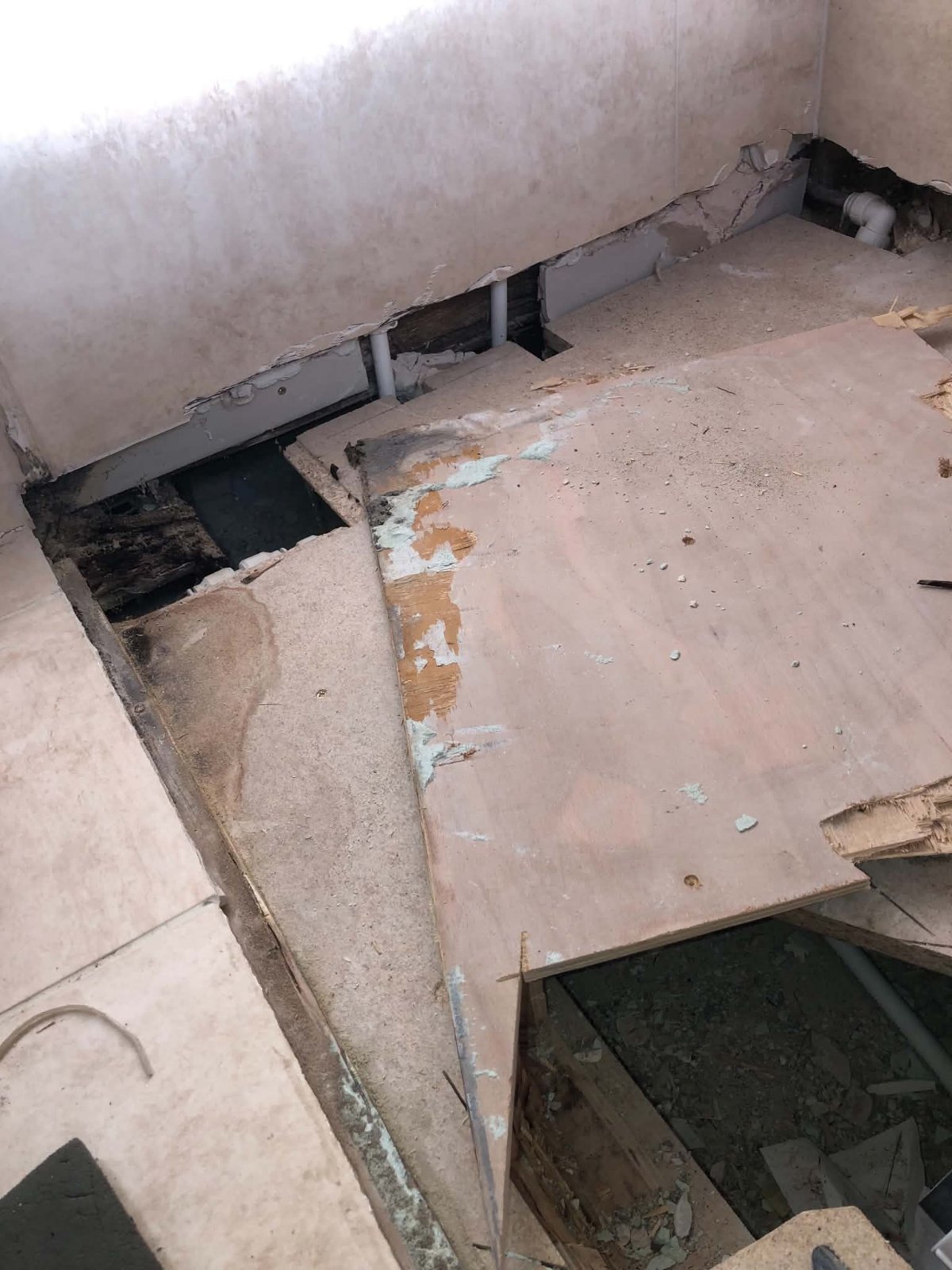

Shower tray removed and the bonding resin and sub floor put up a fight, just so I can tap into the water feeds for a short bath (1400mm) (she loves a bath)
This is what greeted me .... butchered joists re-inforced
with chipboard and plywood, builders rubble/offcuts and plastic speedfit connections
I'm ignoring the state under there and am just going to join on but I don't think I've ever used speedfit fittings before
Wish me luck
Wish me luck

First time I came across a speedfit type of fitting was a student rented house and it had come loose so the kitchen floor was flooded. Important to check they are fitted correctly especially if hidden.

I was very dubious about them first time I ever encountered them but generally they are bloody excellent... My house now has a lot both in my bathroom and on the new central heating. Touch-wood, never a problem.

I've used them once when installing a shower cubicle. Really awkward access to the under floor connections for normal copper fittings but the speedfit worked out well.

Only ever used copper push fit connectors, because my gas bottle run out and could not get a replacement - it was my Dads!
Seen a few plastic pipe installations with sagging pipes, if I were to use it I would add as many clips as possible or even a (as well) a support batton.
And why the elbow.?
And why the elbow.?

I think it was to get the cold pipe below the shower tray, in that corner but there’s also a large chunk of joist missing in that area and a brick missing from the interior wall where I presume the original bath waste pipe went to a hopper outside. Which I will use to run the new bath waste through and tidy up the exterior scab of cement …hopefully I can alter that to take some tension off that area ….
