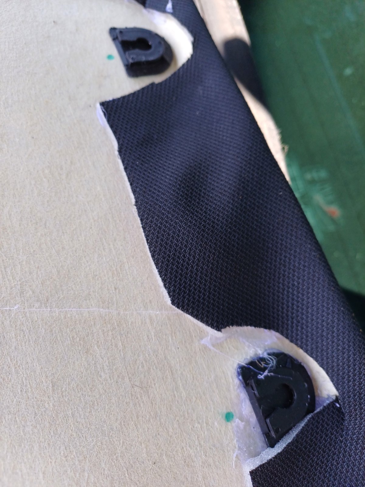

Never saw this till it was removed looks like an old repair this part is tucked away from view .

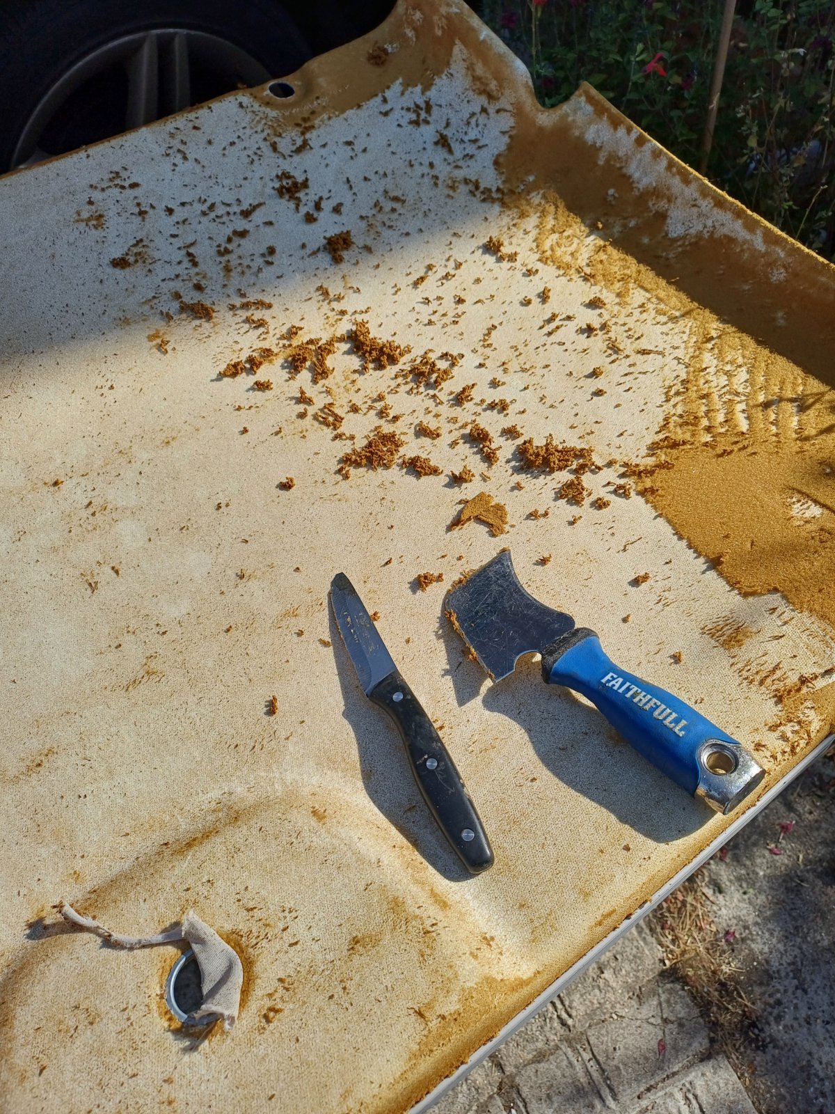

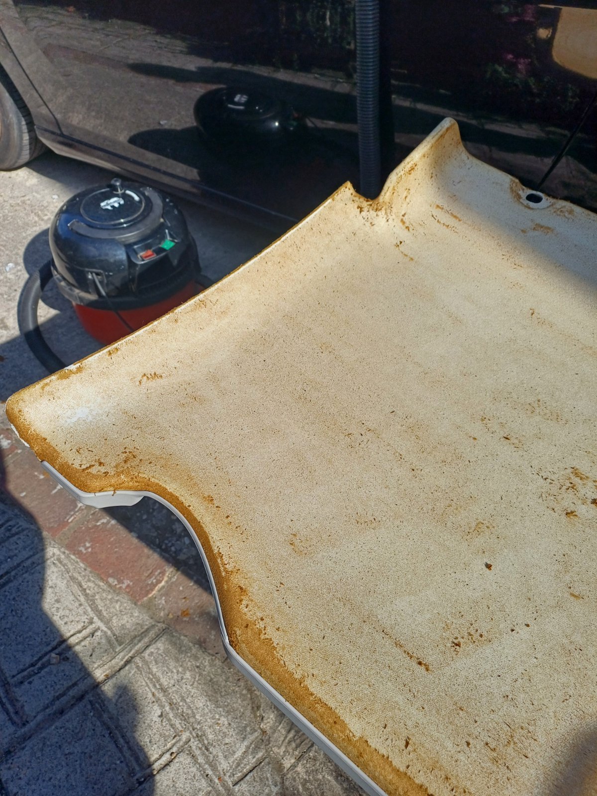

Its slowly coming off ... and the heat is building too
Mucky old foam
Mucky old foam

The knife caught my eye as I have one similar to it. They were used in the factory where I used to work to trim the plastic beads in uPVC window frames.
Bought mine from eBay and found it very useful.

It was left behind when I had a new door fitted to the house 3 years ago its been very handy plus no ones ever come back for it .
So far its going steady ive never done this before but

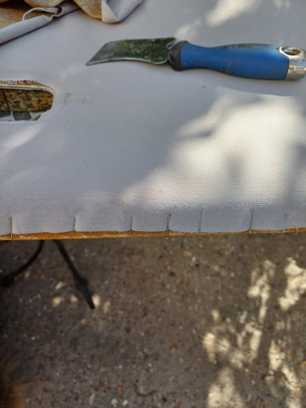

Well that fits nice

Carefully prise these out amd slot back into the housing on the back of the liner then it will clip back in easier, when you remove it you unclip the front first then push the liner back toward the back window and it slides off , clips then needed popping out then fitting back into liner

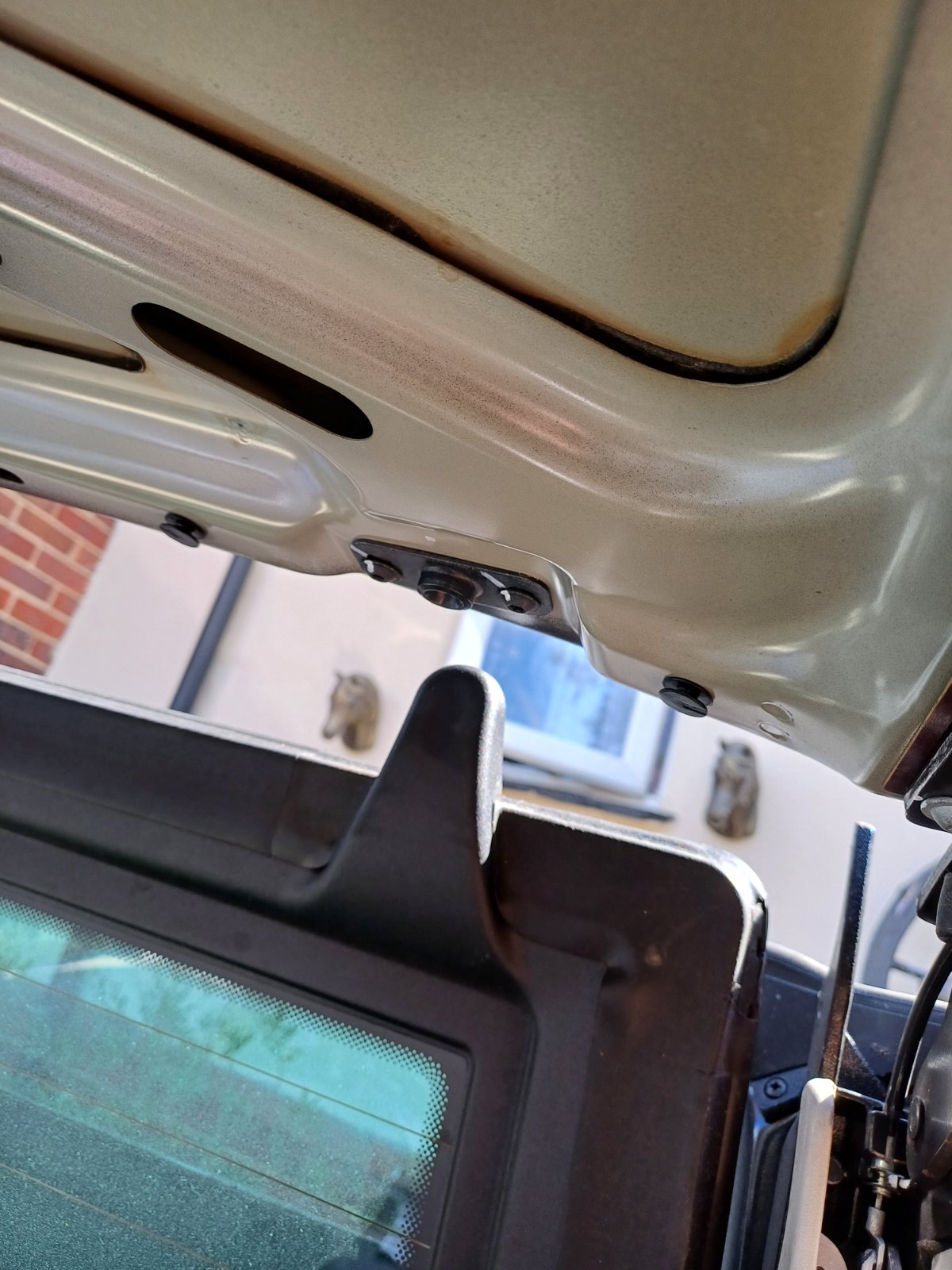

So the roof is almost home the boot has lowered over night , all windows work so thst rules out the know window issue that stops the roof working, tbh wished I'd never bothered doing the liner but it looks so much better than before, the release valve is still open and im leaving it to do its own thing , plus ive a rachet strap doing its thing aswell , it only needs to go another 8 inches .... hurry up , at least its not wet ..... or have I tempted fate !

Thanks matt , ive got the roof almost shut now but found the part that folds behind rear seats, has got caught on the rear window and is stopping full closing , so when I got some free time, and when its cooler yet another manual reset to sort this out , ive covered the car with a tarp as a just incase , its all locked fully and wrapped up , so can wait for a bit.
