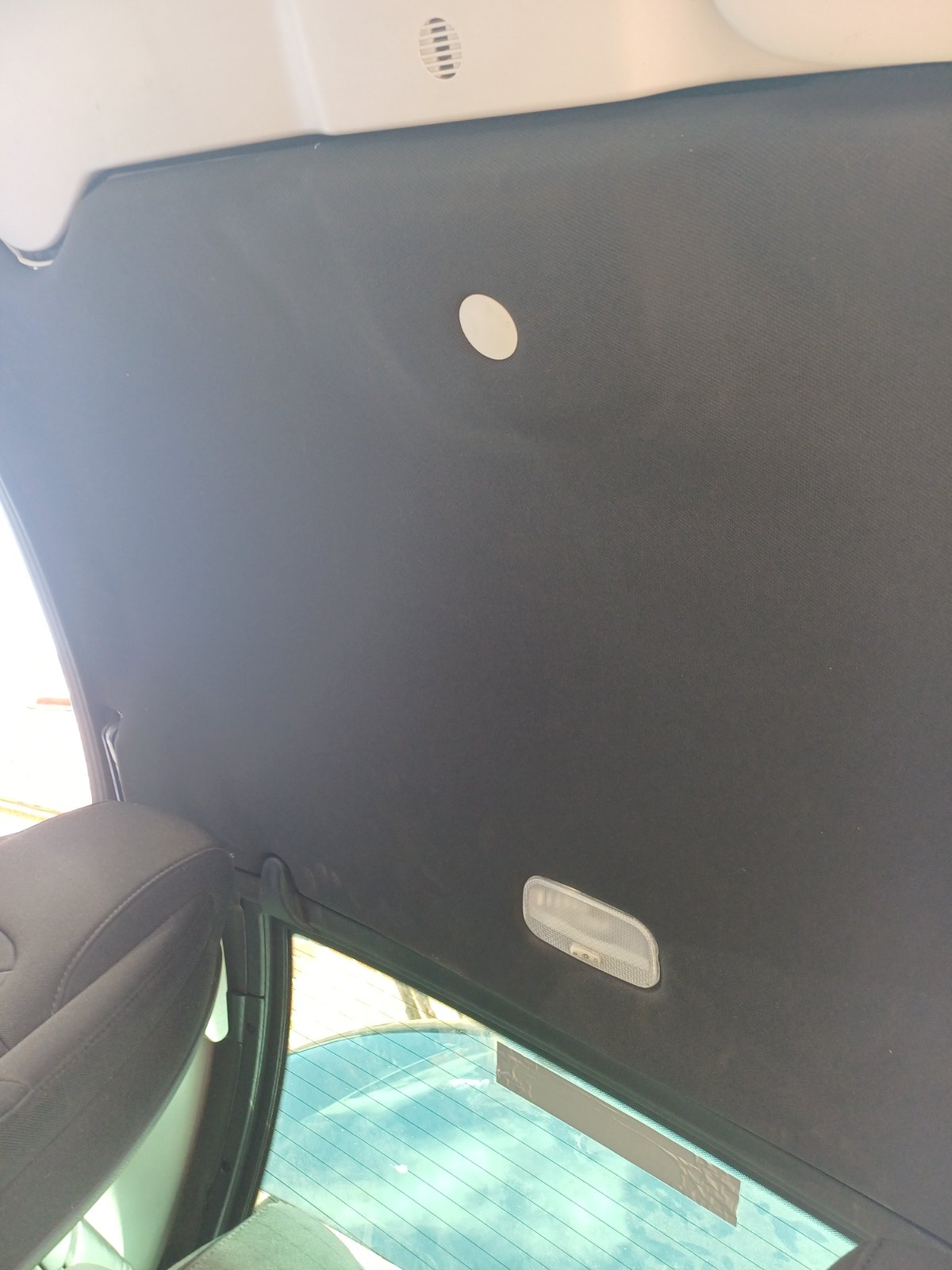

Carefully prise these out amd slot back into the housing on the back of the liner then it will clip back in easier, when you remove it you unclip the front first then push the liner back toward the back window and it slides off , clips then needed popping out then fitting back into liner

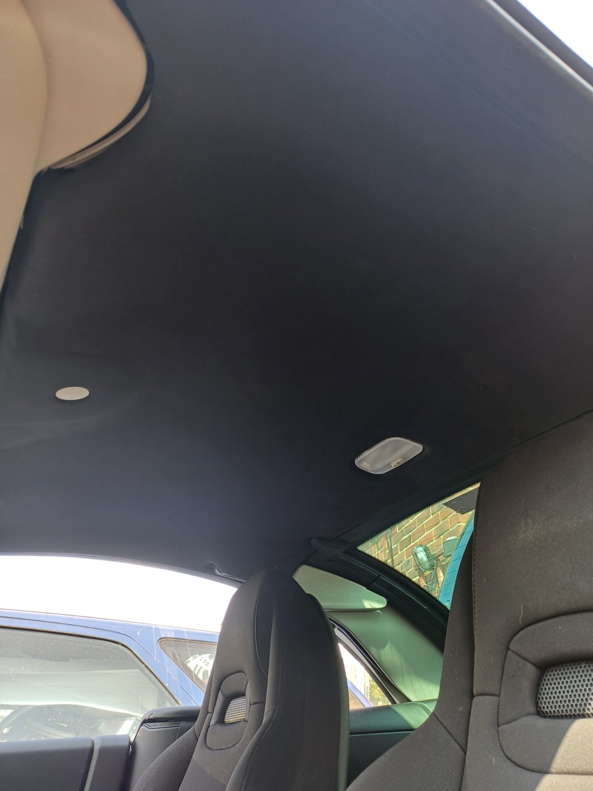

All nice and new looking again , apart from the roof now kicking up a fuss so ive got to do the manual reset . Oh well

So the roof is almost home the boot has lowered over night , all windows work so thst rules out the know window issue that stops the roof working, tbh wished I'd never bothered doing the liner but it looks so much better than before, the release valve is still open and im leaving it to do its own thing , plus ive a rachet strap doing its thing aswell , it only needs to go another 8 inches .... hurry up , at least its not wet ..... or have I tempted fate !

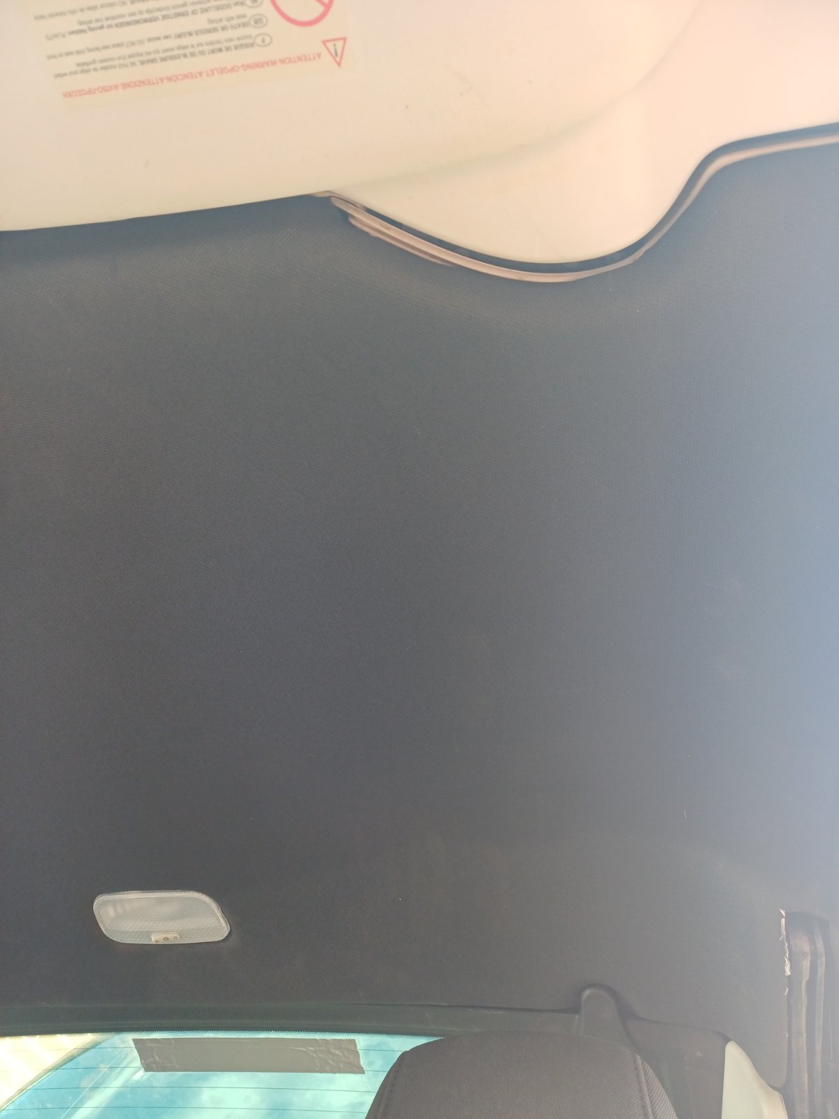

Manually closed the roof finally and the new liner looks ok
