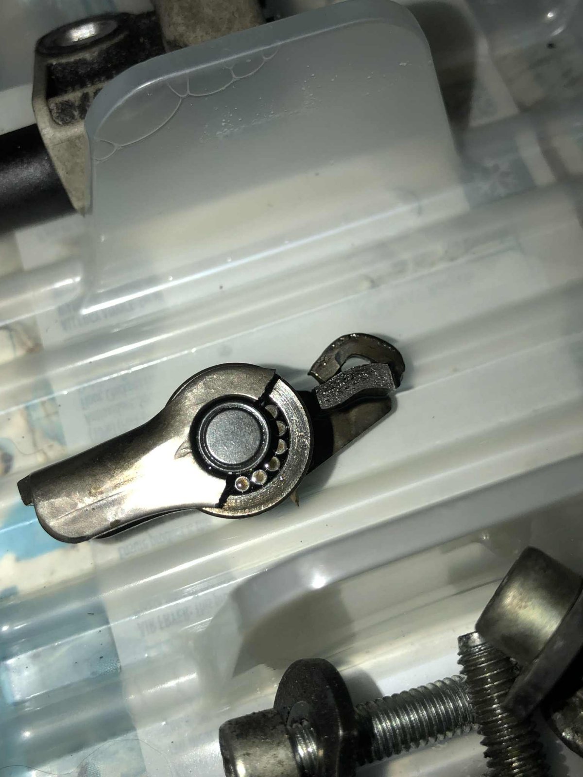

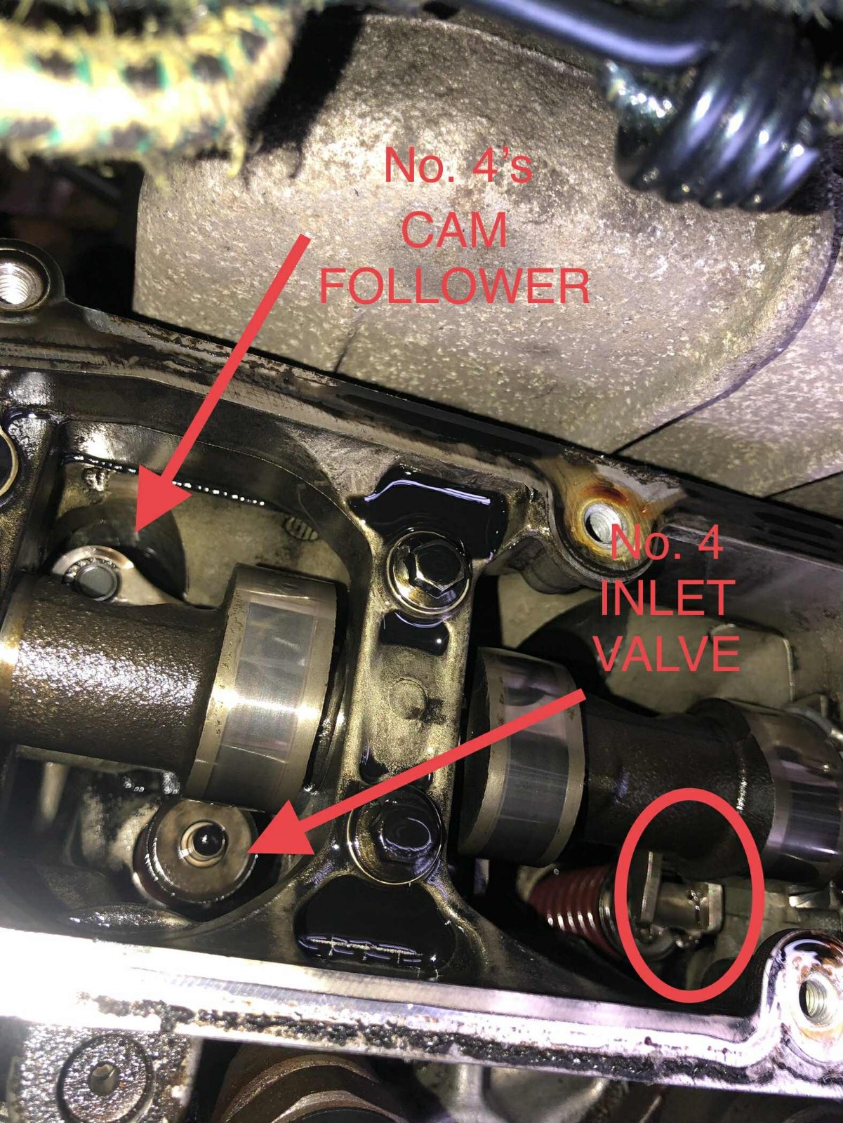

Meanwhile the HDi has yielded another clue ...It's close between Mick and Jim's diagnosis but Mick is looking like the closest ....
Took the Camshaft Cover off and discovered a broken No. 4 inlet cam follower
Hiding in the corner with only one chunk missing and all the needles still in place.
Retrieved with my magnet but no sign of the missing piece yet.
Now
I'm expecting to find some Valve or Piston damage on No. 4 Cylinder to account for that loss of compression, although the engine was running rough there was no mechanical noise to suggest this had taken place. Unburnt fuel getting into the cylinder so maybe inlet valve is bent - hopefully only a tiny bit
I've ordered a cheap endoscope for my iphone to see what I can see down the glow-plug / Fuel Injector holes....
Sorry it's taken so long to get here but this clue is only part of the story, remember it drove home fine, I believe even though these Cam-Followers are designed to fracture to minimise engine damage, there has to be some other damage to account for the lack of compression....

Some real information at last!!
I can of course claim that the No 4 inlet cam follower is the device which makes the spring work, so the idea of the spring being 'broken' is not far off the mark from its cam follower being broken. Certainly closer than a cam sprocket fault so I might have to claim the win on that one!!

On my 2.1 XM there were broken cam followers....but the valves (at first) seemed fine...wrong !
A very very slight bend in two of them only showed up as the valves rotated a little bit at a time (which they normally do I am told) when the engine started/ran.....this caused them to lock up in the guides as the clearance closed up.....and yes it "chuffed" out of the manifold.....so the first attempt was a waste of time !!
A 2nd hand head was skimmed & combined with cam/springs etc from the original as that cheaper than a full rebuild of the "damaged" head which would of needed new guides/re-seated "primary combustion chambers" etc.
