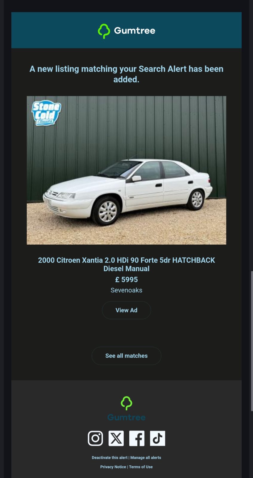

This came to my email last week

WOWSERS! Do you recall how many miles? Got to be well below 100k surely?

Phew, would expect VERY far under 100k miles for that price!
By that logic our old Black, on just under 120k sat in storage needing fairly substantial welding to the sills along with a windscreen (not to mention probably requires 5 spheres 4 tyres, battery & discs/pads maybe calipers by this point, and still then being a ratty base D-auto with dead sunroof, degrading tailgate, replacement engine, weak 2nd gear and S2 leathers) is probably worth what, £895 as she sits?
Any takers? lol just kidding. She'll either live again or donate organs to help another one day, but she's my baby still no matter how neglected at present.
How are folks asking that much though? Have to wonder, what's the top dollar anyone's paid for a Xantia (any config barring Activa) in the last 10 years? My "best" is £200...
