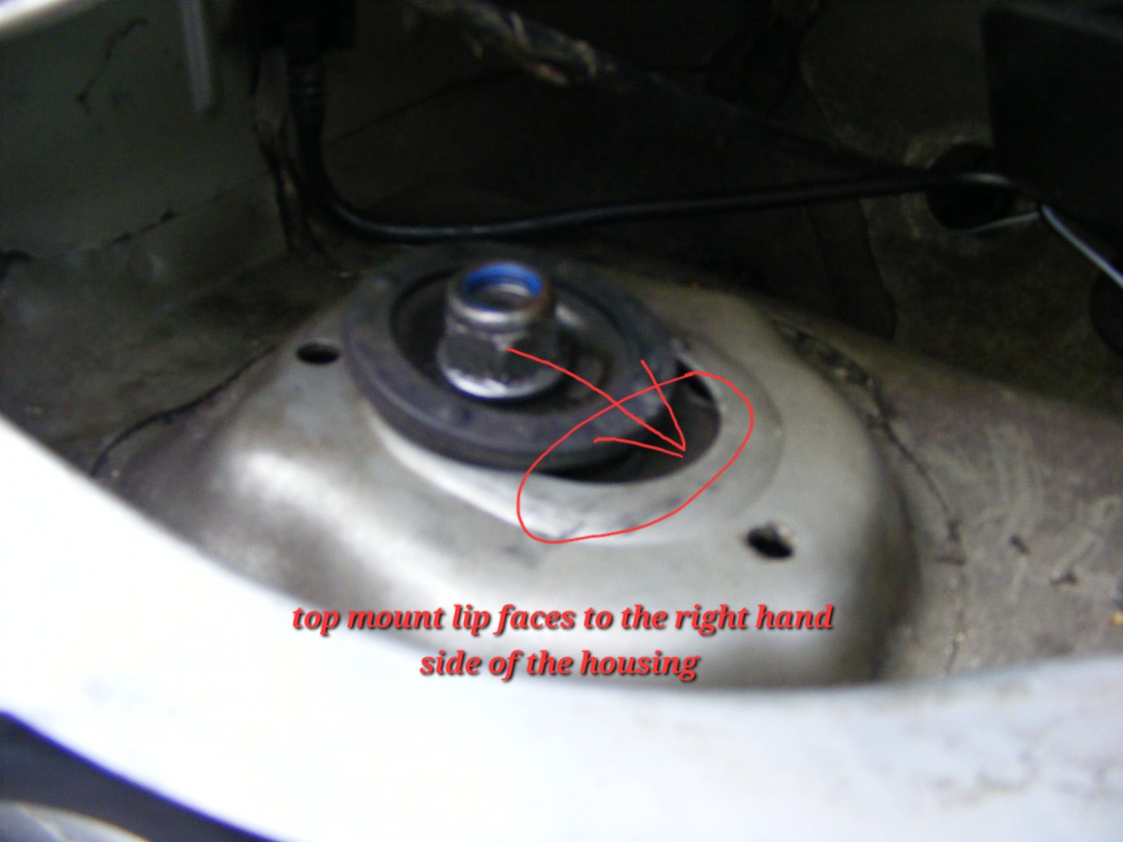

Have a look at this and study the top mount position

Re: lower wish bone arms
I think when I did mine the part that slots into the hub assembly was my reference point to line up the top mount I think there's a little u shaped cut away part in the top mount t that lines up with that bit on the suspension leg then I think its the correct way.
The red circled parts these sit on the inner part of the mount housing (the wing)
The top mount has a rubber part thst stick up , this faces inwards whe its fitting to the suspension turret, facing inwards when looking down at the engine bay while standing out side of the car so the driver side one will point right
and the passenger would face pointing left

Yes looks like there should be a large washer on top of the plastic part that seats the top of spring. then the rubber bearing/Bush goes on
I will remove the strut & see what's going on. but at the moment the top of strut is in too far, giving me a Neg camber \
