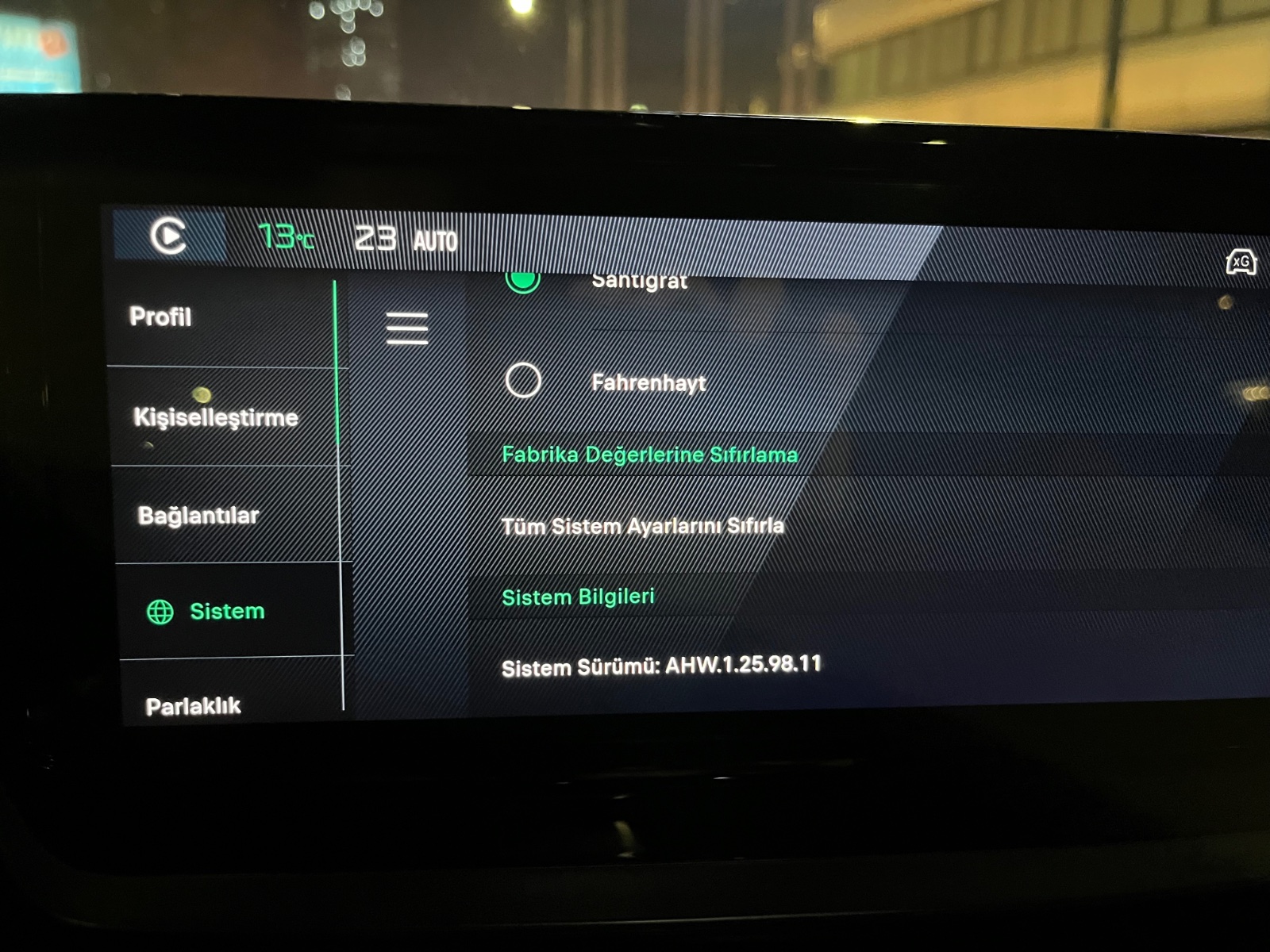

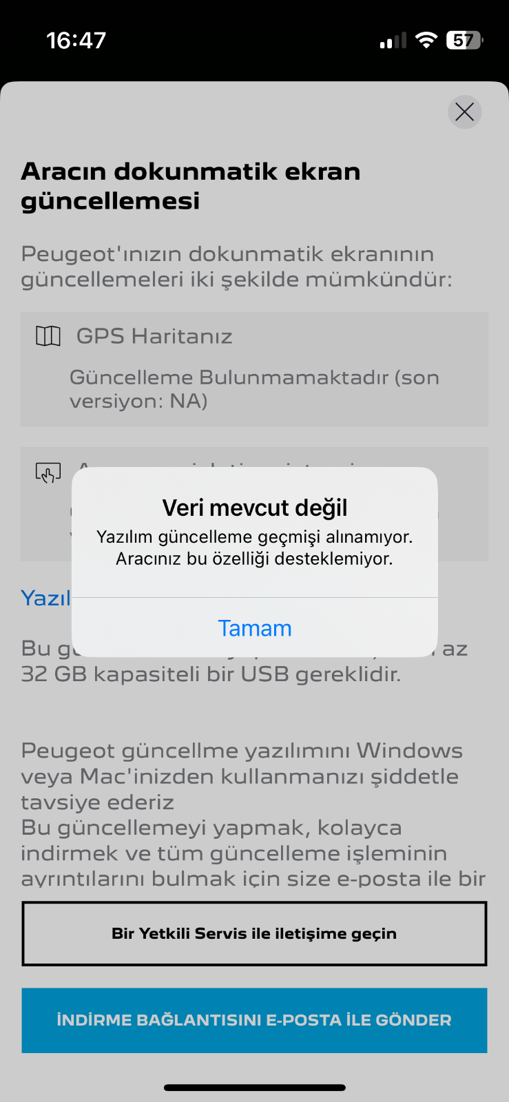

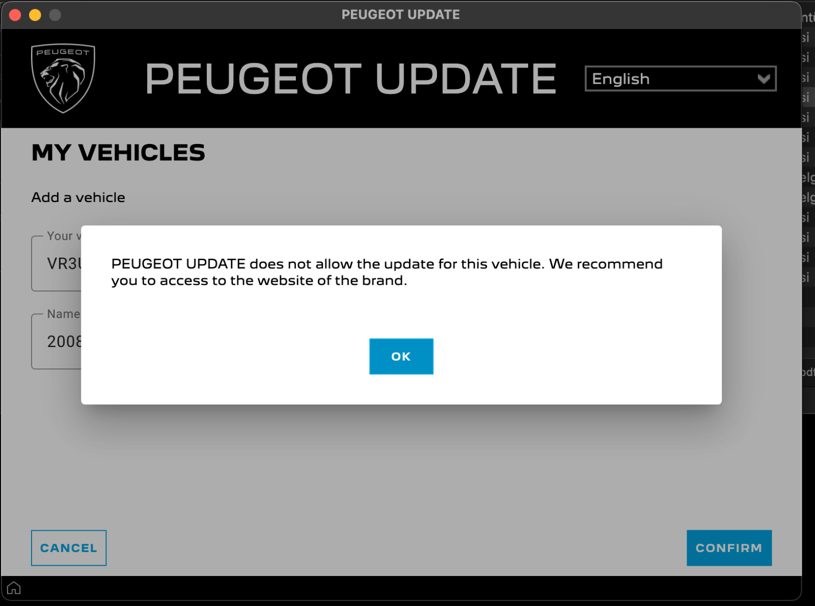

jermy
Posts: 1
Joined: 22 Oct 2024, 11:43
Re: PSA NAC RCC Updates
Unread post by jermy »
Hi, I cant update my car with neither MyPeugeot app nor PeugeotUpdate. (reaching from Turkiye)
App seems cannot even access the version data on car.
Can you help me?
I'm not even mentioning the lack of wifi connection, parking assist, voice assistant, live traffic data and many more.
Thanks in advance.
x 6945
No, can't help you - this thread is for NAC / RCC units, which you don't have - you have an IVI. You will need to take it back to the dealership as a lot of these are faulty.
