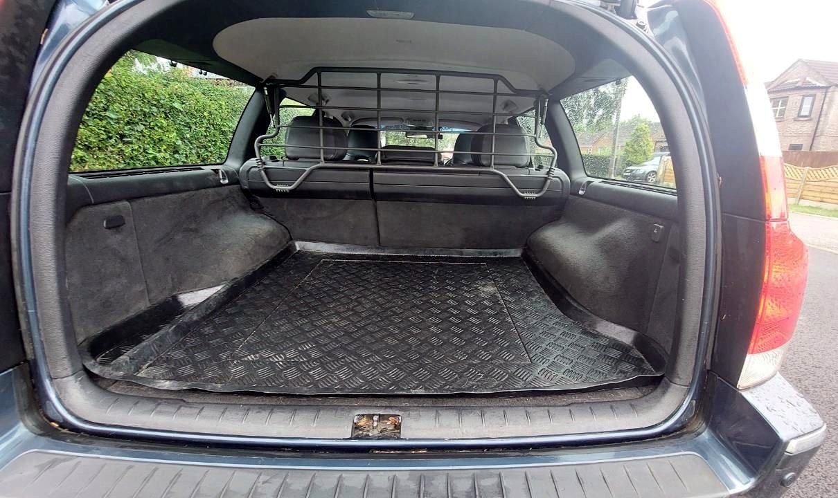

I think the adjective for this is "cavernous" perfect for the dogs, and van-like light haulage duties. Must admit those SUV's supposed to be ideal for dogs, look ridiculously squashed up behind the back row of seats and hardly ever (never?) are shown with 2 large dogs on the publicity photos, at most a Lab and a smaller dog.

Oh those Volvo seats look lovely! Are they are cosseting and squishy as they look?

The other downside of most SUV-like things is that they tend to have a really high loading lip as well, which isn't ideal for dogs. Partner isn't actually great there either as the price you pay for the torsion bar suspension is the axle beam sitting all but level with the top of the rear tyres, there's a lot of empty space underneath the car between the rear wheels.NewcastleFalcon wrote: 08 Jul 2024, 13:48 I think the adjective for this is "cavernous" perfect for the dogs, and van-like light haulage duties. Must admit those SUV's supposed to be ideal for dogs, look ridiculously squashed up behind the back row of seats and hardly ever (never?) are shown with 2 large dogs on the publicity photos, at most a Lab and a smaller dog.![]()
I just absolutely don't see the point in 95% of them. They make virtually all of the compromises that things like an actual Range Rover does, but without any of the advantages...If you want a car you have a load of space in and can haul loads of cargo around in, get a large hatchback or an estate. If you want more vertical volume and a more upright driving experience, get something like the Ford Fusion or PSA Berlingo/Partner. If you want to be able to drive offroad, get something that's actually an off roader. We had an Audi Q5 here as one of the company cars, and it was awful. For a start we had a never ending flow of niggly problems with it that the dealer were absolutely disinterested in doing anything about, and it was just so ridiculously cramped inside. The Xantia had more room in the boot without even thinking about folding the seats down than that did, and it was trying to look like an estate/SUV blob. Have to admit that was one all four of us were glad to see the back of. Usually it's been top trim level Skoda Superbs since, but we had to change with the last two as they've not been on the company car scheme. Not hugely useful for dog transit though given that they also have a no pets policy for the company cars.
Based on my prior experience with Volvos I'm hoping that the answer to that question is a solid yes. Though admittedly it's never going to beat the interior of the 262C. Haven't actually seen the car in person yet, so only have assumptions to work on.MattBLancs wrote: 08 Jul 2024, 14:03Cheeky snip, but I wholeheartedly agree!Zelandeth wrote: 08 Jul 2024, 12:01 I think the Audi Q7 was probably one of the most outright unpleasant things![]()

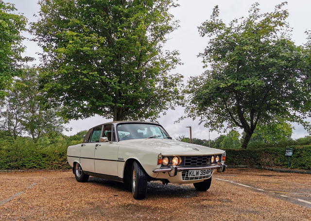

With the Partner in work commuting use, the Invacar still boxed in behind a broken Trabant, the Trabant having only half an engine, and the Renault still as far from being road ready as it was at Christmas, the Rover was placed on Daily duty today.
All things considered, she behaved impeccably today. Yes still running a touch warmer according to the gauge than I'd ideally like, but not alarmingly so, the wiper blades are awful, and in the wet these tyres result in the car being precisely as enthusiastic about going sideways as I had expected. Those definitely need changing before the car goes into properly regular use. The whole not being circular thing gets old in a hurry too.
Oh, and that blasted sidelight has gone out again. The holder in that just needs to be replaced as it's knackered. If I clean the contacts it will work again for a couple of uses before packing in again.
Niggles aside though, we covered thirty miles or so across four or five errands dotted around town, and she didn't miss a beat. Given the history of this car to date this feels like pretty major progress.
Do I dare believe that we're starting to turn a corner with things towards the car being properly usable? Or do we have another exciting random failure waiting to pounce as soon as I let my guard down? Don't know, but I'm sure we'll find out soon enough.
Now that we've got that oil leak under control I think I just need to make a point of using the car a bit more and try to get some miles covered to shake the remaining bugs out.

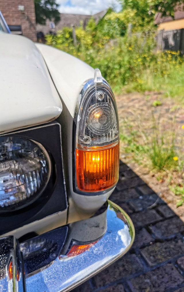

For the third or fourth time I repaired this side light on the Rover today.
The whole back of the cluster is badly corroded though so I don't really expect it to stay fixed for more than five minutes. Replacements are quite expensive, though there is apparently a repair kit which sleeves the areas that usually corrode, so I'll look to get one of those ordered next time I'm picking up parts. Well I'll order two actually as I'm sure the other one isn't going to be far behind. There are I think three different types of metal coming together in a design that's a natural water trap in an area of the car where moisture is going to inevitably gather anyway (the back of the cluster is open to the wheel arch void so will get all manner of road muck thrown at it). So not surprising they rot out for fun.

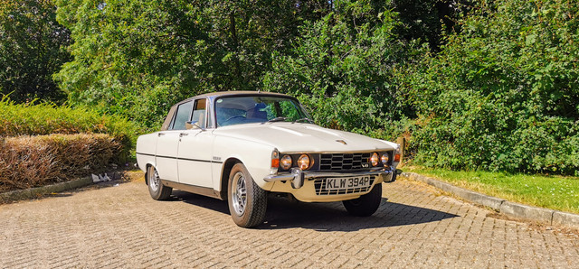

At least it's stayed fixed long enough for me to get a half decent photo of the car.
Still breaks my brain a little to think how long ago this design was drawn up. Not quite as much as it does to drive the car mind you. It absolutely doesn't feel like a 60 year old design.

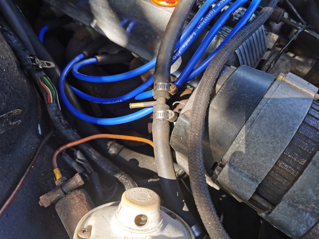

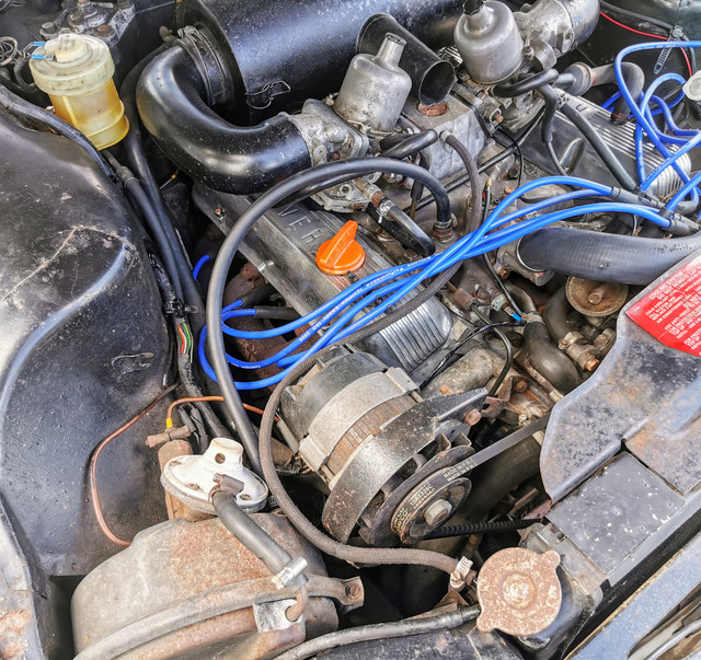

On the subject of vacuum though I'd been wanting to do something about this mess between the inlet manifold and the brake servo for ages.
Aside from the fact that the hose was a good couple of inches too short so was jammed hard up against the back of the alternator, that machine screw that had been used to block off an unused vacuum port wasn't 100% air tight.
Much better. I've also put a couple of hose clips on the hose that bridges the two halves of the brake servo itself as that wasn't a particularly snug fit after this many years. Evidently this has indeed improved the level of vacuum being applied to the servo given that the first time I went for the brakes when leaving the drive I just about put myself through the windscreen. The servo is definitely doing far more work now than it was. Given I knew we had at least some degree of a vacuum leak from there I obviously wanted that sorted out before I went about trying to properly balance things anyway otherwise I'd just have been chasing my tail.
