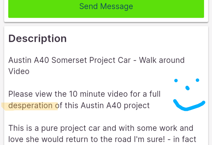

This popped up today, another one to add to the fleet Zel.
https://www.gumtree.com/p/austin/austin ... 1473975824
OnlineMattBLancs
- Posts: 5361
- Joined: 25 Apr 2022, 09:03
- x 2366
Re: Zel's Fleet Blog - BX, Jag XJ-S, Sinclair C5, Mercedes 208D & 230TE, AC Model 70.
Freudian slip on condition of the car?Gibbo2286 wrote: 03 Jul 2024, 19:29 This popped up today, another one to add to the fleet Zel.https://www.gumtree.com/p/austin/austin ... 1473975824

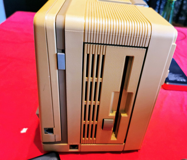

On Sunday the Dunstable Downs Radio Club held their annual car boot sale/swap meet down Luton way. I've missed this the last few years as it has clashed with other events.
I very nearly escaped without buying anything. Nearly.
It's fair to say that if there's anything I need it is not yet more old computers...however this had to be mine the moment I spotted it.

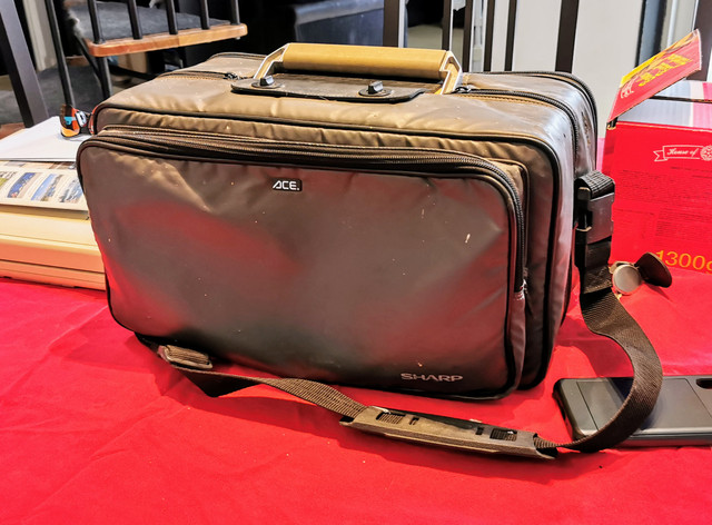

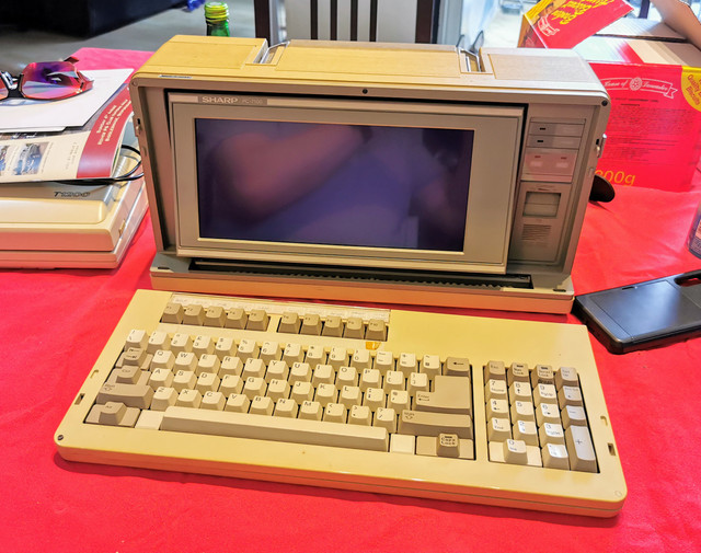

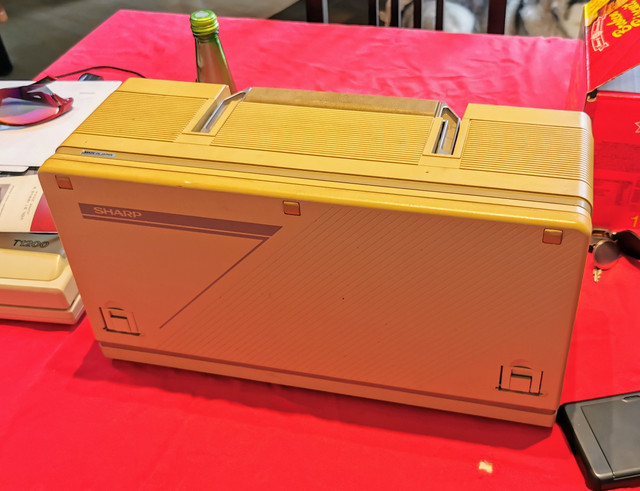

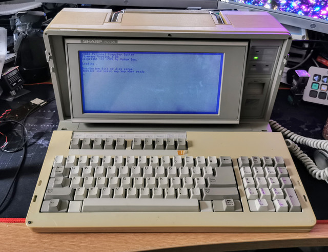

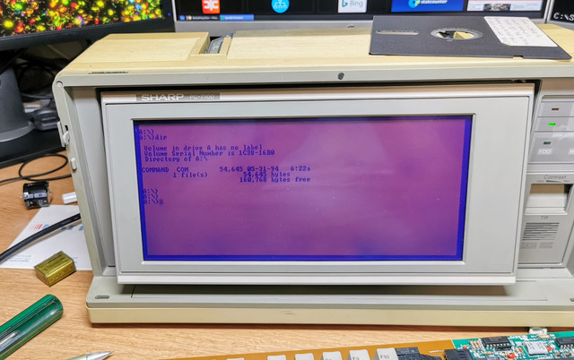

This is a Sharp PC-7100. An 80C86-2 based PC-XT compatible portable machine dating from the mid 80s, this example being from 86 based on the serial number.
The seller indicated that the system was in working condition but couldn't read from the hard disk. They hadn't been able to test further than that due to not having 5.25" floppies on hand to try to boot from. Sure enough, this description was accurate.
Conveniently I do have a PC in my workstation which has a 5.25" drive so I chucked together a DOS boot disk and decided to see what would happen. It tried to boot, but would always hang when it tried to interrogate the hard disk.

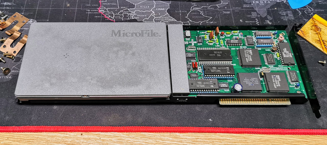

Storage on this is provided by one of these nightmares.
This is a Plus 20 hard card. Basically a very slimline 3.5" MFM hard drive and controller card attached to each other in a single full width ISA card. These things even by the standards of MFM drives from the era were horribly unreliable when they were current, never mind after 30+ years.
They seem to fail in three ways generally. If they won't spin up it's usually because the heads have stuck to the platters. If the drive spins up but won't seek, this is usually because a rubber bumper on a travel limit post has turned to goo and the head actuator arm is physically stuck to it. Or the controller just turns itself into a doorstop.
This one seems to just be struggling to read. So *hopefully* it will work with a fresh low-level format. Unfortunately you need third party software to do this for most of the variants - some will work with Speedstor, but it's a roll of the dice depending on which firmware is on the ROMs. I'll need to stuff that onto a 5.25" disk and see what happens.
The BIOS on this computer is very limited, meaning you can't use any other drive. There's no configuration settings, it just looks for the controller ROM at a set memory location, and it's there or it isn't. The sandwich of drives in this also makes using anything else physically difficult as there isn't space for anything thicker than this.

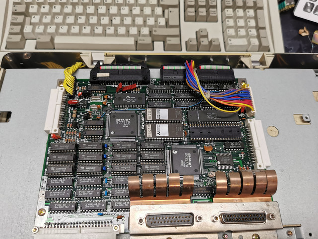

The motherboard on this is really small. Looks like a lot of the heavy lifting is being done by two large custom chips.
Same 80C86 powerhouse of a CPU as the T1200.

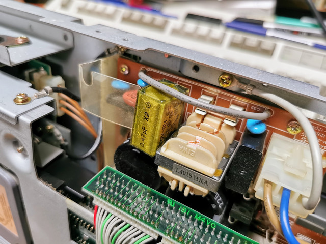

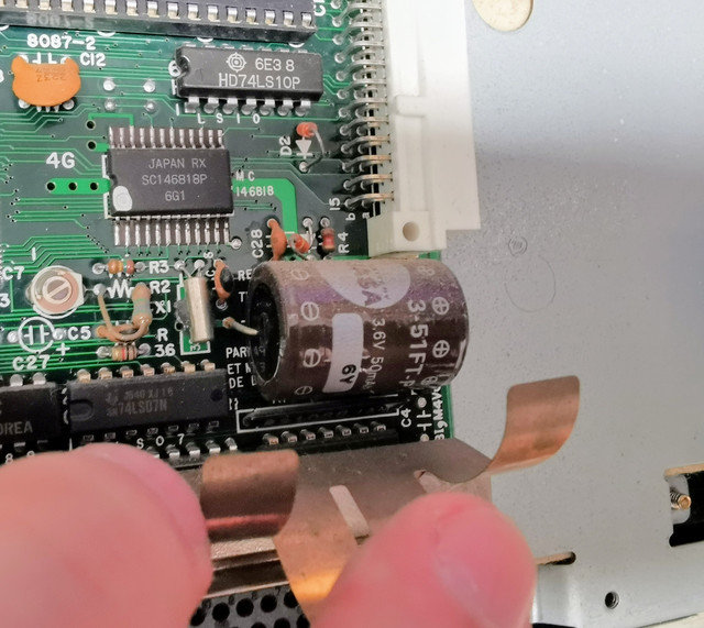

While I was digging my way in to find the hard disk I spotted two things that need to be changed. One large Rifa cap in the power supply.
Also a battery which astonishingly hasn't leaked yet.
I mentally made a note to go back in and change that Rifa capacitor at a later date. Fast forward about ten minutes and there was a loud enough bang to leave my ears ringing and my entire workbench vanished in a comedically large cloud of smoke as the aforementioned capacitor let go. Great, my room was destined to smell of immolated capacitor innards for the next 48 hours. Rookie mistake.

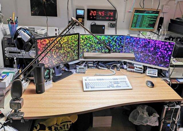

I had been after a proper adjustable fluorescent desk light forever - however the ones I've spotted before on eBay etc have always tended to either go for silly money or be collection only from unhelpful corners of the country. Or were recently made pieces of plastic tat.
This one looked to be in good shape aside from the missing remote ballast, was clearly a well made example and the price was right.

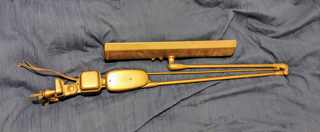

Didn't clock that it was actually a Dazor unit until I got it home and looked a bit closer. I think this badging also suggests it wasn't made yesterday (along with the rating showing 50 cycles rather than Hertz).
Evidently someone else in the past had tried to wire it up without realising it was meant to have a remote ballast given that both tubes in it were completely missing both cathodes. Imagine the resulting flash and bang woke whoever that was up! Tubes in there weren't anything special - just colour 830 2011 era GE Polylux XLs. Still decent tubes though which likely would have lasted ages if it hadn't been for getting nuked.

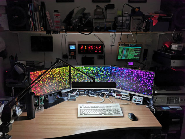

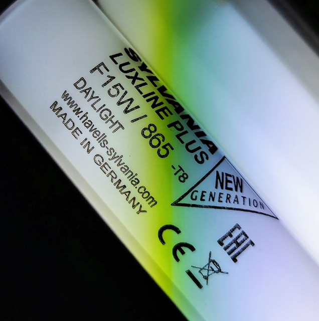

Here we are after the addition of a spare ballast I had in stock and a pair of new Sylvania 865s were put in.
Again with all the other lights in the room off.
Obviously it wouldn't normally be used to illuminate my keyboard - it's mainly for if I'm working on my usual projects of technological necromancy that I'll be grateful for finally being able to not be perpetually working in my own shadow.
The big difference between this and so many of the cheaper versions is that wherever you adjust the head of this to,it just stays there (unlike the hopeless thing you can see just peeking out behind the left hand monitor which is almost purely used as a headphone hook these days). Everything is properly sprung a counterbalanced absolutely perfectly. The head can also be swivelled to pretty much any orientation.
When not in use it folds away completely vertically so takes up no more actual space on the desk than a cup of coffee.

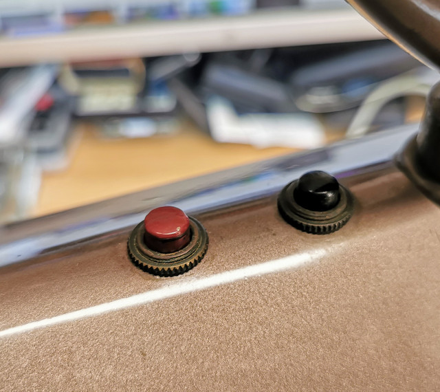

Starting is handled in pretty classical fashion for a fixture of this type of US origin in that it has a manual preheat.
The black button is pressed to turn the fixture off, to start it you press and hold the red button for a couple of seconds then release to turn it on.
Only modification I'll be making will be to add an earth connection to the case for safety's sake, but otherwise it will be left well alone and just used as it was designed to be.

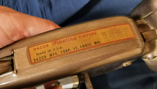

If anyone can actually date this for definite I'd be really curious. I know that the styling can't really tell you all that much, but the typeface on the ratings tag tends to suggest to me that we're probably talking 60s or 70s.
Definitely one that the lighting nerd in me is happy to have grabbed - but both because it's a bit of an oddity to find fixtures like this in the UK, but also because it will be really bloody useful when I'm doing electronics work.

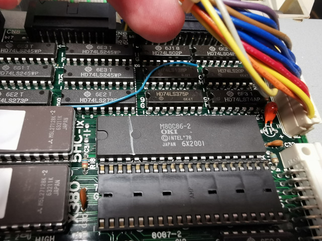

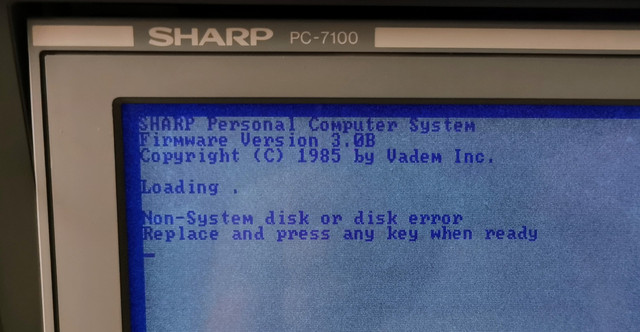

Had a little bit of time this evening to poke around with the little Sharp.
Got the offending smoke bomb - I mean Rifa cap - in the PSU replaced and everything back together. I'd like to get the scope on the output to make sure we don't have any excess ripple/noise on the outputs. However that means digging the scope out, and it's pretty well buried at the moment.

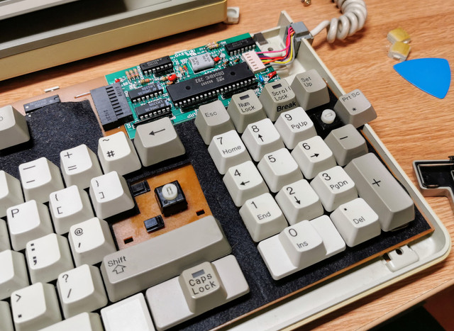

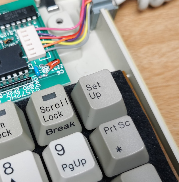

A couple of discoveries. Firstly was that it *will* actually boot off a floppy if you wait long enough. I thought it was hanging when attempting to access the hard drive, but it does eventually time out. At which point it asked me to enter a date. New problem...dead enter key on the keyboard! Every other one on the keyboard worked, just not enter. Of course being an XT layout we don't have a second one on the number pad, there's a + where you'd expect enter to be. Two screws being already missing from the keyboard suggests to me that I'm not the first person to look in to this.
This was quickly traced to being a problem with the key switch itself. Maybe I can revive it...but with good access to the back of the PCB I decided to just swap it for one that's rarely used. I nicked the one from Sys Rq.
Absolutely don't want to have to remove the enter key again. It has not one but two stabiliser bars on it, and getting the horizontal one back in the slots was an absolute swine of a job. It did however get us a working enter key.

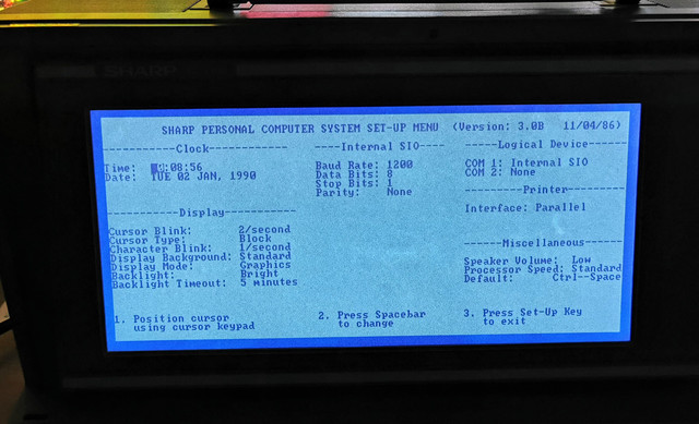

Was while putting things back together I spotted a non standard key legend. One at the top right is labelled "Set Up."
Intrigued, I obviously pressed it.
Turns out I was wrong, this system does have a BIOS config menu, albeit a very basic one.
Interesting to see that this can be pulled up at any time and the changes applied immediately, rather than needing a reboot. I really am glad to be able to change the speaker volume - it was previously set to high, and the system beep was LOUD on this sucker, despite the speaker being tiny. Having tamed that somewhat has made tasks requiring frequent reboots less tiresome.
One feature this machine does have over the Toshibas from the same era is an option to flip the screen colours so you get the normal bright on dark text in DOS*. Though that looks quite odd on this screen unless you're in a dark room relying on the backlight. The panel itself is very similar to the one on the Toshiba T1200 (in fact, that's a Sharp made panel, so could even be the same one), though the Toshiba definitely has a far brighter backlight. For text based applications though they're both entirely usable. The deep, saturated cobalt blue on grey colour is really quite striking to look at and pleasing to look at. Even if my camera hates it.
* Not entirely missing on the Toshibas. There is an application - VCHAD.EXE if I remember right - which allows any of the onscreen colours to be redefined, so technically you could flip the colours if you wanted. That's handled at the application level though rather than in the hardware.
Having a working keyboard meant we have been able to actually get to a usable DOS prompt.
I did try running both SpeedStor and Spinrite, but the former couldn't make any sense of the drive, and Spinrite just hung on startup. This isn't entirely surprising. I've read in a few places that the Plus hard cards use some odd BIOS routines so tend to behave unpredictably if you're not using their own utilities, especially the earlier revisions, which this appears to be based on the branding. So that will be my next task, track down their utilities and see if that will let me low level the drive.
The error I'm getting in DOS is "Sector not found reading drive C" which suggests a formatting issue rather than the dreaded "General failure reading drive C" which usually means doom at the hardware level.
I have found that MFM/RLL era drives do just seem to need to be low levelled periodically (we're talking like 10 years, so we'll outside their original design life). My theory is that it's down to the magnetic data on the disk literally fading as the coercity of the media is relatively low. Spinrite is usually great for this as it allows you to read data off, format and rewrite data on the fly without having to faff around and actually wipe and reformat things. I'm *hoping* that's the issue we're facing here and that I'll be able to get this drive going if I can find a way to properly low level it. As with only a single 5.25" (I think 360K) floppy this system isn't really all that usable as it stands.
Still an *interesting* machine either way, but I'd really like to get it fully working.
Probably had it on for an hour or so this evening and the system seemed to be stable - and we had no further smoke shows, which my nose and smoke alarm appreciated.

The issue here I think is that we need to low level format this, rather than just rebuilding the file system, this is to lay down the actual physical sectors and tracks on the drive (not an issue with IDE or later drives as you didn't have access to the "bare metal" so to speak as the controller handles it all). Usually there's a program built into the controller card for most of these drives which is accessed via the DOS debug command G=C800:5 if memory serves. Alternatively the third party programs Spinrite or SpeedStor also handle this, without needing to remember oddball debug commands and with a rather more user friendly user interface.
Unfortunately, these hard card style drives (which are essentially just an MFM drive and the controller card both bolted onto the same frame) often required their own flavours of proprietary software. The Plus drives fall into this category - which is most likely why Spinrite hangs when it tries to start up. Unfortunately, the company never let their low levelling software into the wild (wanting you to send the drive back to them for warranty repair if something went awry to the extent of needing a low level format), which may well explain why among collectors they seem to have such a poor reputation for reliability. So I may be a bit stuck here. For now anyway.
