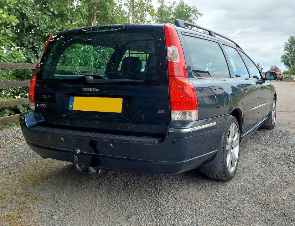

In other news, we may actually have some fleet news coming up in the daily category. Unexpectedly.
I absolutely haven't been looking for anything in that area as the Partner has been doing an absolutely fine job of what I've been asking of it. Few niggles here and there, and she will want a couple of jobs done in future, but nothing dire. Probably the biggest gripe we had, if we could call it that is that Abby doesn't find it particularly comfortable to drive. Which isn't ideal given that she needs to make a 2+ hour drive each way to work once every couple of weeks. Not enough of a gripe to make me actively look for anything, but it's always been in the back of my mind that we might look at something a year or two down the line. Whether that be a newer generation Parlingo or something different, hadn't even thought about that really.
Today however I stumbled across something which was such a joke run as far as our wish list was concerned that I felt that I needed to fully investigate.
The wishlist off the top of my head in no particular order.
[] Load area suitable for transport of two large dogs.
[] Automatic.
[] AC.
[] Cruise.
[] Heated seats.
[] Enough space to transport four adults in comfort.
[] As not Audi-like suspension as possible.
[] Modern, safe & dependable enough I can trust others to use it regularly. So made this side of 2000.
[] Mainstream manufacturer so finding parts isn't a huge pain.
[] Not absolutely ruinous fuel economy.
[] Not resale silver.
[] Warm/light coloured interior.
The last item is the only one which we strike out on sadly. I'm not going to quibble over that though. Bit more expensive than my usual fare, but seems potentially a nice enough upgrade that I'm willing to entertain it. It's also nice enough condition that it should be possible to just look after it and *keep* it nice, rather than starting out with a substantial to do list.
Nothing has been confronted yet, but open to guesses what I'm looking at.
