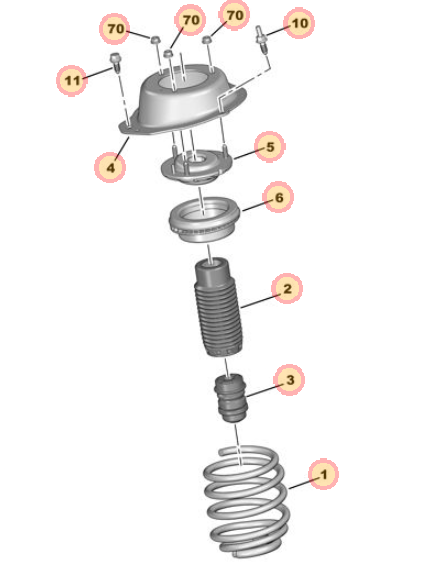

Front Springs
(1) Spring, (2 White, 1 Blue), part: 500440, £184.86
(2) Shock Rod Protector, part: 525453, £18.37
(3) Susp Bump Stop, part: 5033F5, £38.42
(4) Susp Bracket, Left part: 5038H7, £105.05
Right, part: 5038H8, £105.05
(5) Shock Bracket, Left, part: 5038H9, £73.37
Right, part: 5038J0, £73.37
(6) Shock Ball Thrust Bearing, part: 503562, £86.69
(10) Pillar Screw, part: 364819, £2.42
(11) Flanged Bolt, part: 364820, £2.10
(70) Nut & Captive Washer, part: 693680, £3.19

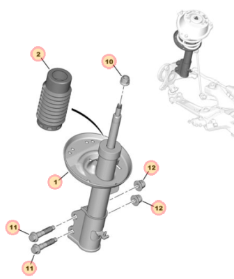

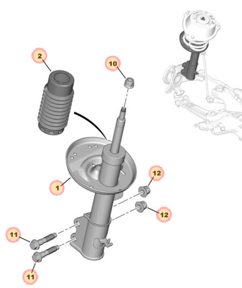

Front Strut
(1) Front Damper Original
Left, part: 5208Y7, £122.75
Right, part: 5208Y8, £122.75
Cheaper Peugeot Alternative
Left, part: 1675682280. £144.73
Right: 1675682380, £144.73
(10) Hex Nut, part: 503615. £5.14
(11) Shock Fixing Screw, part: 521113, £5.74
(12) Shock Fixing Nut, part: 521114, £1.51

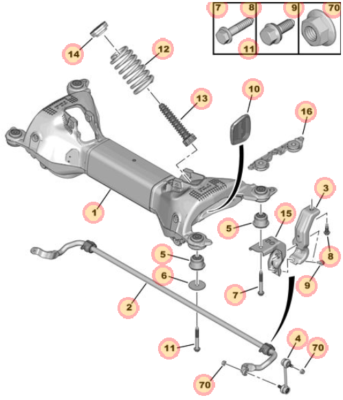

Rear Springs
(1) Crossmember, part: 5148Y6, £1225.48
(2) Rear Anti Roll Bar, part: 5170E8, £414.17
(3) ARB Clamp
Left, part: 517259, £49.10
Right, part: 517260, £49.10
(4) ARB Rod, part: 9807130080, £76.27
(5) Rear Crossmember Mountings, part: 515266, £43.18
(6) Rear Crossmember Retainer, part: 516531, £5.72
(7) Bolt, part: 9800917880, £7.30
(8) Flanged Bolt, part: 517322, £2.42
(9) Flanged Bolt, part: 364820, £2.10
(10) Crossmember Plug, part: 515418, £6.80
(11) Flanged Bolt, part: 513276, £4.38
(12) Suspension Spring, part: 5102FS, £157.88
(13) Shock Rod Protector, part: 525457, £16.74
(14) Spring Upper Cup, part: 516533, £22.46
(15) ARB Bearing Clamp,
Left, part: 517261, £48.85
Right, part: 517262, £45.85
(16) Spacer, part: 9810767480, £156.37
(70) Flanged Nut, part: 693686, £

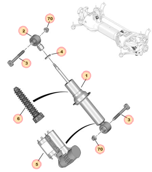

Rear Strut
[/b]
(1) Rear Damper, OEM part: 5206ZC, £
Cheaper Alternative, part: 1623322280
(2) Shock Eye, part: 522074, £
(3) Shock Fixing Screw, part: 1687270780, £
(4) Flat Washer, part: 522439, £
(5) Arm Mounting Protector
Left, part: 521806, £
Right, part: 521807, £
(70) Flanged Nit, part: 693665, £

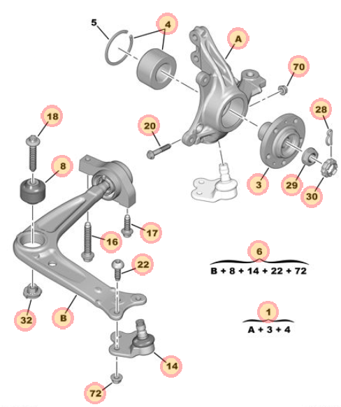

Front Pivot / Hub
(1) Front Stub Axle Carrier
Left, part: 1640790380, £
Right, part: 1640790580, £
(6) Front Wishbone
OEM Original Left, part: 9666681480, £
OEM Original Right, part: 9666681380, £
Cheaper Left, part: 1682737280, £
Cheaper Right, part: 1682736680, £
(16) Flanged Bolt, part: 364816, £
(17) Flanged Bolt, part: 364817, £
(18) Flanged Bolt, part: 364818, £
(20) Shaft Screw, part: 364824, £
(28) Holding Pin, part: 329703, £
(29) Wheel Hub Fixing Nut: 329433, £
(30) Locking Nut, part: 9808870380, £
(32) Cage Nut, part: 362267, £
(70) Flanged Nut, part: 693686, £2.09
(72) Flanged Nut, part: 693665, £3.19

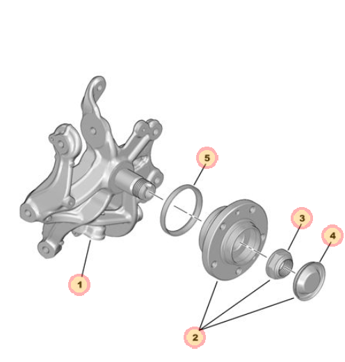

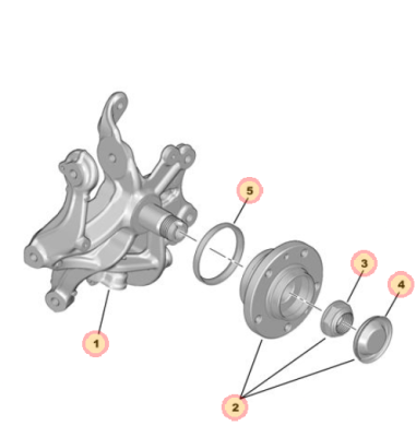

Rear Hub
(1) Rear Swivel Pin
Left, part: 517654, £600.53
Right, part: 517655, £600.53
(2) Rear Hub Bearing, part: 3748A6, £92.69
(3) Rear Wheel Bearing Nut, part: 373928, £
(4) Wheel Hub Plug, part: 374045, £6.76
(5) ABS Radial Target, part: 454919, £20.02

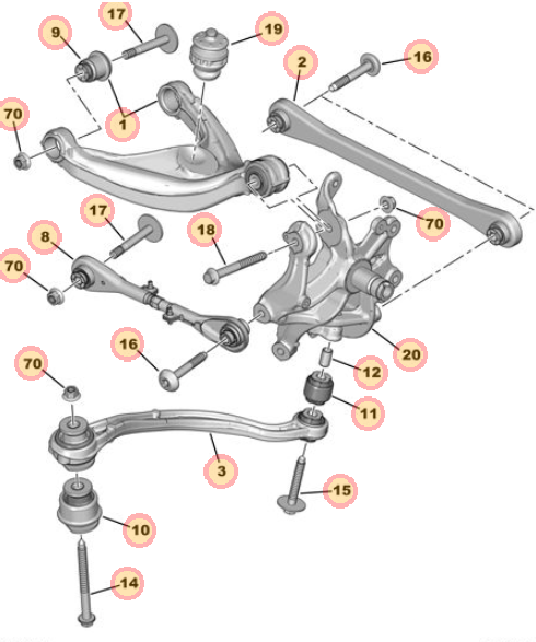

Rear Trailing Arm
(1) Trailing Arm
Left, part: 9650668480, £407.64
Right, part: 9650668380, £407.64
(2) Rear Suspension Arm
OEM, part:, 5175CF, £225.41
Alternative, part: 1682738780, £29.52
(3) Rear Longitudinal Arm
OEM Left, part: 9801145880, £223.44
Cheaper Left, part: 1682739180, £64.19
OEM Right, part: 9801145780, £223.44
Cheaper Right, part: 1682739280, £64.19
(8) Rear Suspension Link
OEM: part: 517847, £125.41
Cheaper, part: 1682739080, £72.28
(9) Rear Susp Mountings, part: 5131E0, £38.26
(10) Rear Susp Mountings, part: 9801049980, £40.55
(11) Rear Susp Mountings, part: 5131C3, £31.82
(12) Rear Suspension Support Pin, part: 516907, £5.28
(14) Flanged Bolt, part: 5132C4, £6.14
(15) Flanged Bolt, part: 1687270880, £4.52
(16) Shaft Screw, part: 513278, £4.70
(17) Shaft Screw, part: 513280, £4.09
(18) Shaft Screw, part: 513279, £4.48
(19) Buffer, part: 5166C6, £47.89
(20) Rear Swivel Pin
(70) Flanged Nut, part: 693665 £3.19

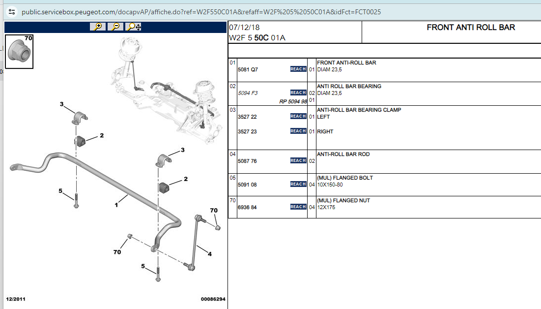

Can you also post up part numbers for the front sway bar bushings, Sway bar links and the steering rack tie rods and rod ends? there seems to be a few variations when i look it up on partsouq and i'm unsure which one to get.

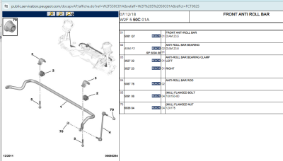

Front anti roll bar:
Bushing used to be 5094F3, but have been replaced by 509498.

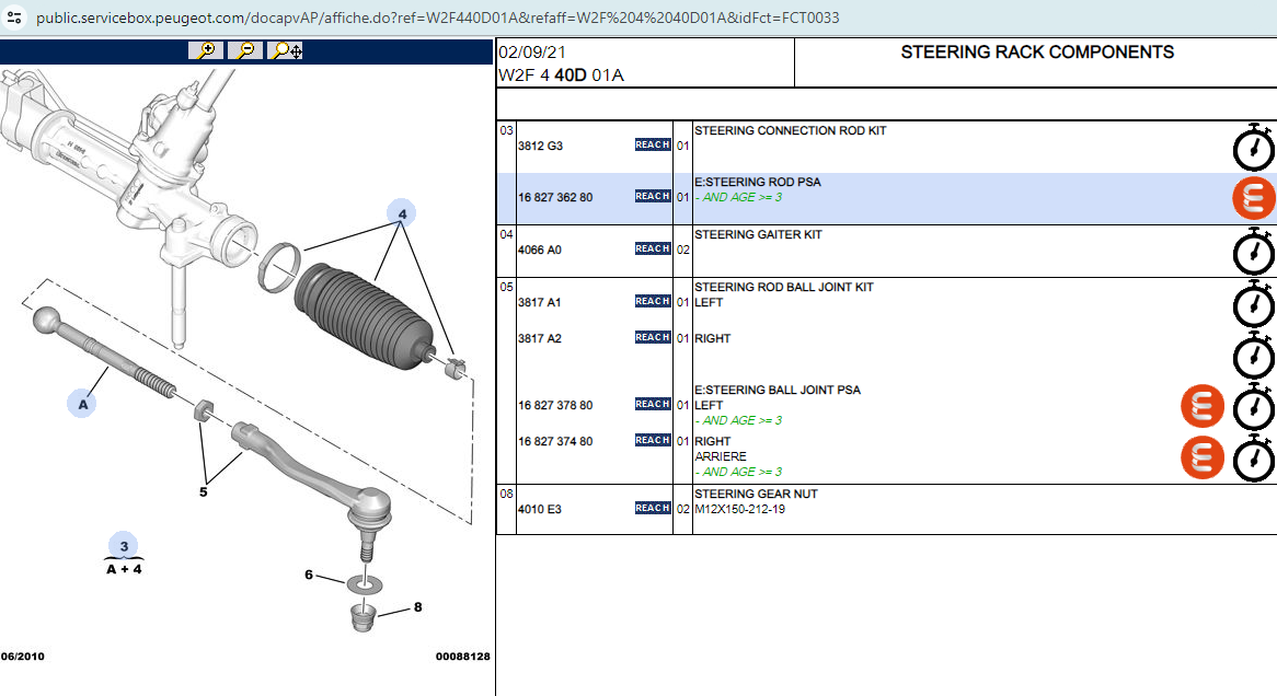

Steering rack end components:
