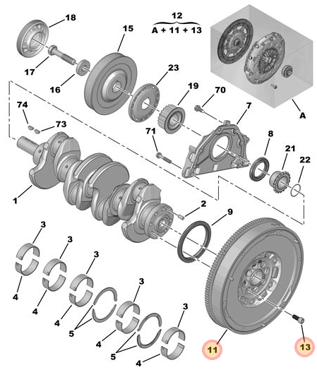

Dual Mass Flywheel
(11) Original OEM, part: 9800982980, £904.91
(11) Standard Exchange Flywheel, part: 1613939080, £558.66
(13) Bolts (all 8 must be changed), part: 1682800980, £1.57 each

Note Flywheel and Clutch kits will also require a deposit, refundable on return of the used part.
