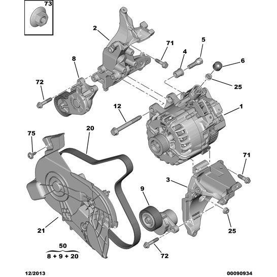

Oh I forget to ask, do you know the part numbers for the two tensioners? I'll be looking to replace these with the belt as they advise you to do that I believe.
I take it is part 8 and 9 in the diagram below?
