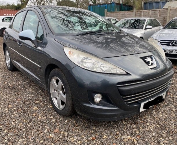

So i did a px my old 307sw 2002 reg for a 207 1.6hdi 2010
Reason ? i wanted a lighter car smaller engine lower tax so ive cut my road tax nearly £200 pa halved my emissions & lowered my insurance , hope ive done the right thing
I will post here about everything re this car.
