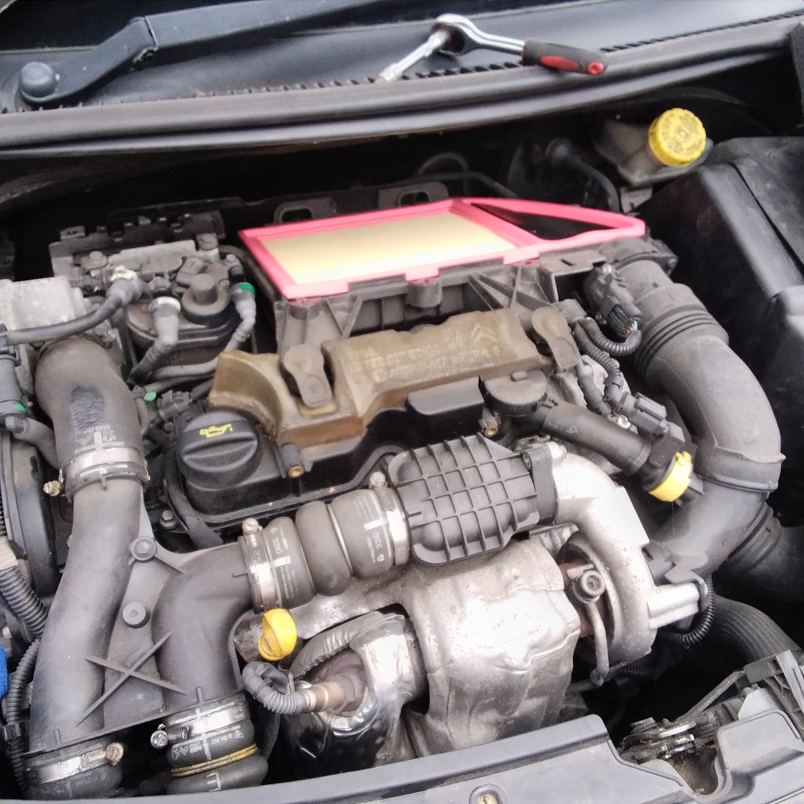

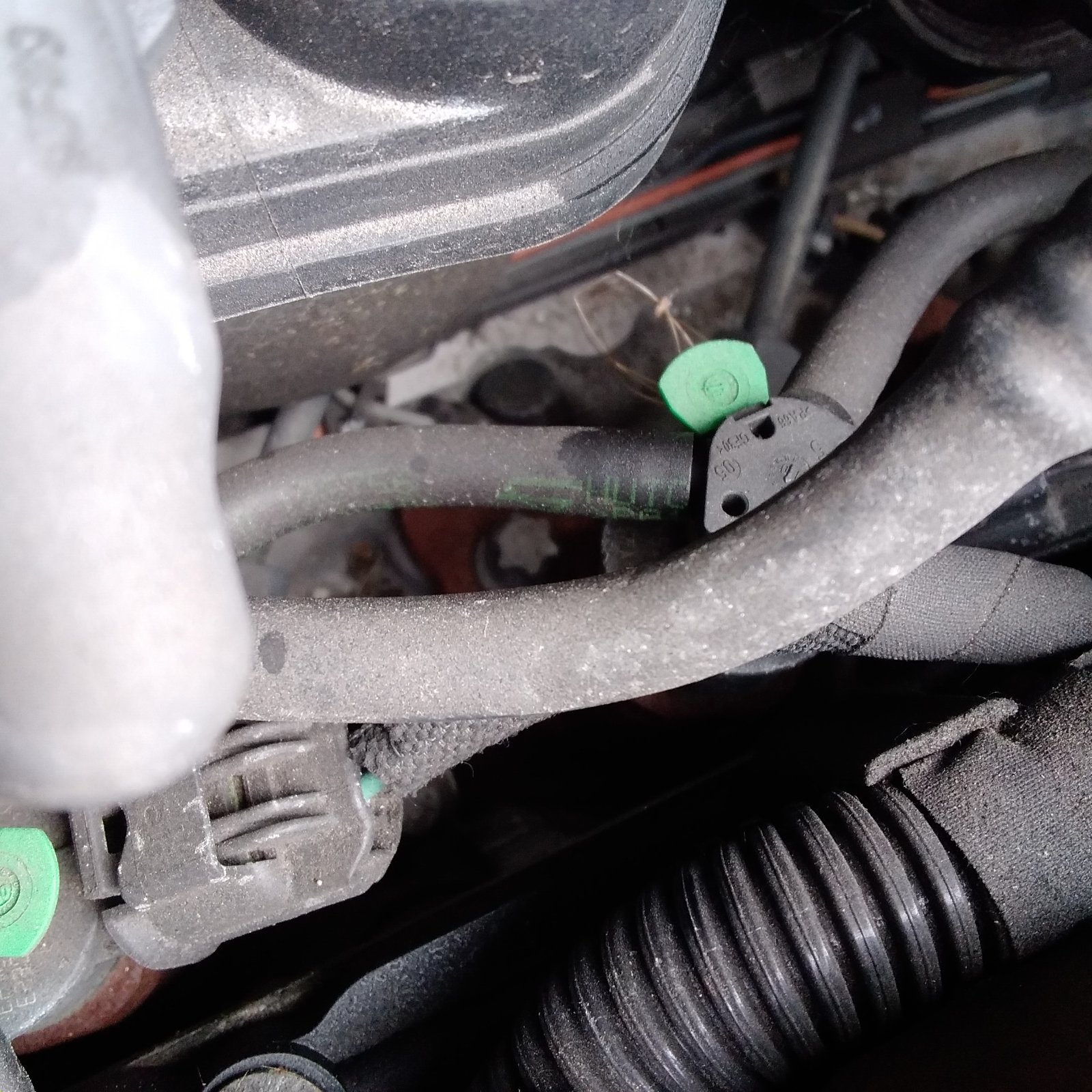

My clamp bolts are like my old 2.0hdi type
Bottom caption should be for the top
Part service today was beat by the rain
Air & fuel filter done plus checking of the dpf all good.
Oil change when next dry.

Ah yes see what you mean, a Torx head bolt rather than an Allen key head nut
