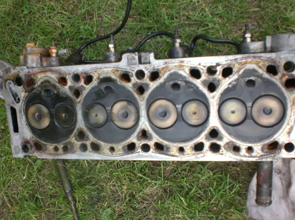

Head is off now-I see the dowel thing now I didnt exactly pull it out but the various bits of leverage I applied effectively achieved the same result.
Just for the record here is the head
The valve which failed the push down test is protruding very slightly.
