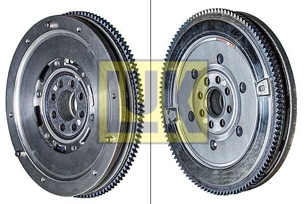

Hi Kenny,
Ok, I had the starter out checked for a whole on the fly wheel there is none. There is a hole in the block but what my car has is a luk type flywheel see image below. There only the counter weights hence why I didn't lock flywheel it's not possible to do so
Thanks for your help and advice as always much appreciated, I bought it in November drove home have been working on it since. 😔

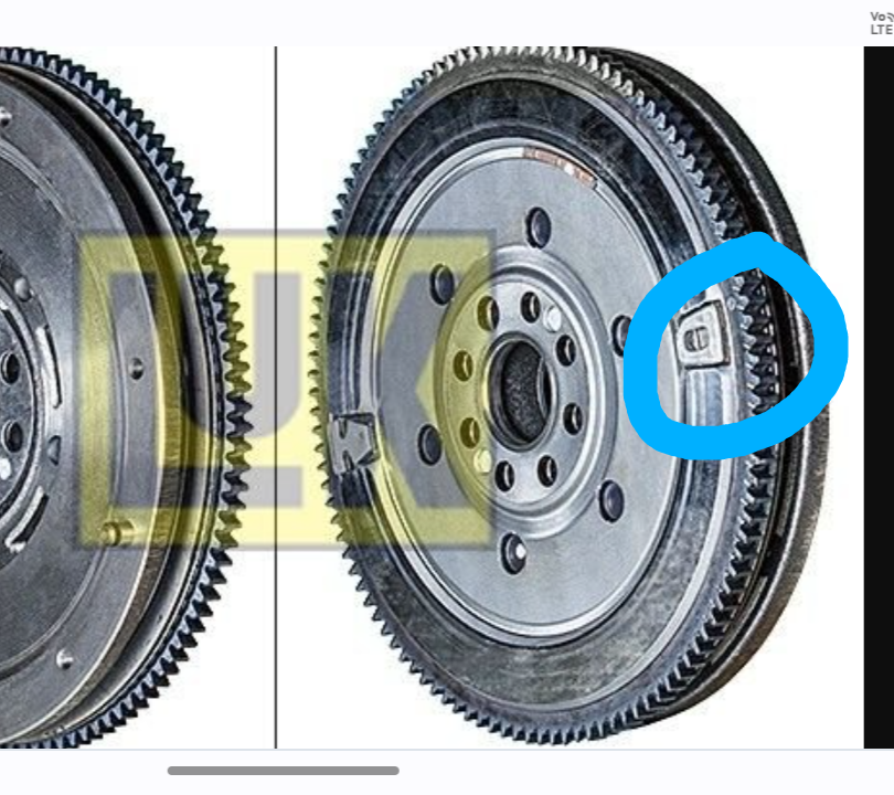

:oops: :shock: Hi Matt, I thought that was just a counter weight. I have just been out plugged it in no cam crank synch according to read out and fuel pressure is 40,000kpa at full crank 250rpm. I will pull it apart at the weekend and see try it. I thought it was a circular hole.

That's why it won't start then. Plenty fuel pressure but if it doesn't see cam / crank in synch it won't start injection.

On mine there were two holes, just to confuse further!
The proper flywheel hole (viewed from removed starter motor position) is actually almost square. Hole in block is round. Think was 9mm diameter rod to fit both (details in my post) the "decoy" flywheel hole was smaller.
As described above, the toothed tool is to hold crankshaft whilst pulley bolt is undone (and official procedure is wind it out with torque wrench to avoid risk of shearing it! Head back tightening then out again if torque wrench clicks on the way out)
