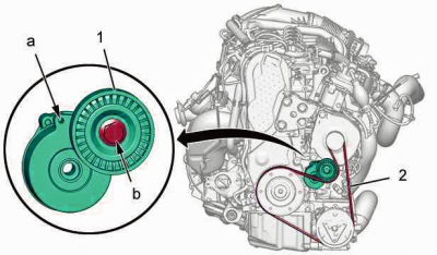

My aux belt snapped, so some advices,please.
Could someone show me the diagram for the belt route.
Is there any tips or tricks? I suppose I need to remove the front right wheel, but anything else?
My car is C5 X7 2009, 2.0hdi automatic.

Here you go:
Yes, you'll need to remove the front right wheel and mud shield.

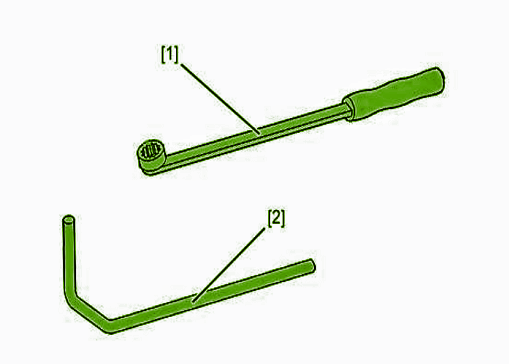

Compress the dynamic tensioner (1) in the anti-clockwise direction ( as "b"), using tool [1].
Peg the dynamic tensioner (1) at "a", using tool [2].
Remove the accessories drive belt (2).
ESSENTIAL: Check that the roller (1) turns freely (no play or tight spot).
Refitting
Refit the ancillary belt (Observe the following order):
Support the dynamic roller tensioner (1) ( as "b"), using tool [1].
Remove the tool [2].
Progressively decompress the dynamic tensioner to tension the accessories belt.
Refit the mud shield and wheel, tightening to 10 ± 1 daN.m

| Recommended Tools |
| [1] Dynamic tensioner compression lever (-).0188-Z. [2] 4 mm diameter pin (-).0188-Q1. |
Refitting
- Accessories Drive Pulley
- Compressor
- Alternator
- Roller Tensioner
