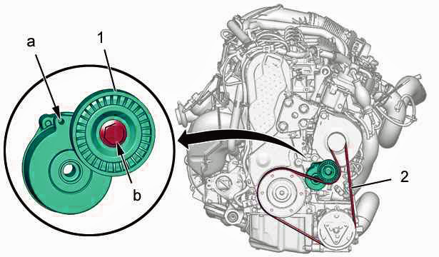

My aux belt snapped, so some advices,please.
Could someone show me the diagram for the belt route.
Is there any tips or tricks? I suppose I need to remove the front right wheel, but anything else?

Here you go:
Yes, you'll need to remove the front right wheel and mud shield.
Compress the dynamic tensioner (1) in the anti-clockwise direction ( as "b"), using tool [1].
Peg the dynamic tensioner (1) at "a", using tool [2].
Remove the accessories drive belt (2).
ESSENTIAL: Check that the roller (1) turns freely (no play or tight spot).

Refit the ancillary belt (Observe the following order):
Support the dynamic roller tensioner (1) ( as "b"), using tool [1].
Remove the tool [2].
Progressively decompress the dynamic tensioner to tension the accessories belt.
Refit the mud shield and wheel, tightening to 10 ± 1 daN.m
- Accessories Drive Pulley
- Compressor
- Alternator
- Roller Tensioner

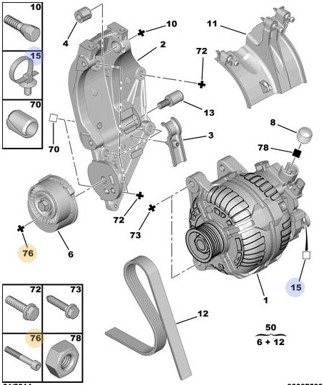

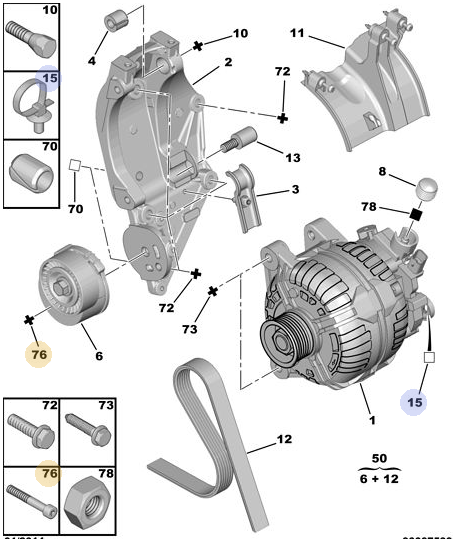

The tensioner is also broken, it is not spinning freely. Bought a new one, but my question is:
Does anyone remember the size of the hex bolt? Does it have normal or opposite threads?
- x 6956
Re: Citroen C5 X7 aux belt diagram?
If it's (76) then details below.
(MUL) SOCKET CHEESEHEAD SCREW (DIAM 10X150-60)
Replacement part number: 7903009248 from Citroen.
Thank you! It is indeed that #76. I didn’t realize it is so big, a 10mm hex!

Just to add clarity for future reference:Viitonen wrote: 08 Oct 2019, 14:46 The tensioner is also broken, it is not spinning freely. Bought a new one, but my question is:
The mounting bolt (number 76 on Marc's diagram below) is conventional thread.
It is possible to find replacement pulleys (literally pulley and integral sealed ball bearing) online. If only the pulley is giving up.
Note the bolt in the centre of the pulley itself, usually a 15mm hex, is an anticlockwise thread and also has threadlock applied.
