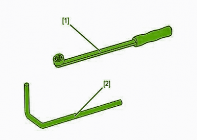

Here you go:
Yes, you'll need to remove the front right wheel and mud shield.
Compress the dynamic tensioner (1) in the anti-clockwise direction ( as "b"), using tool [1].
Peg the dynamic tensioner (1) at "a", using tool [2].
Remove the accessories drive belt (2).
ESSENTIAL: Check that the roller (1) turns freely (no play or tight spot).
| Recommended Tools |
| [1] Dynamic tensioner compression lever (-).0188-Z. [2] 4 mm diameter pin (-).0188-Q1. |

Support the dynamic roller tensioner (1) ( as "b"), using tool [1].
Remove the tool [2].
Progressively decompress the dynamic tensioner to tension the accessories belt.
Refit the mud shield and wheel, tightening to 10 ± 1 daN.m
