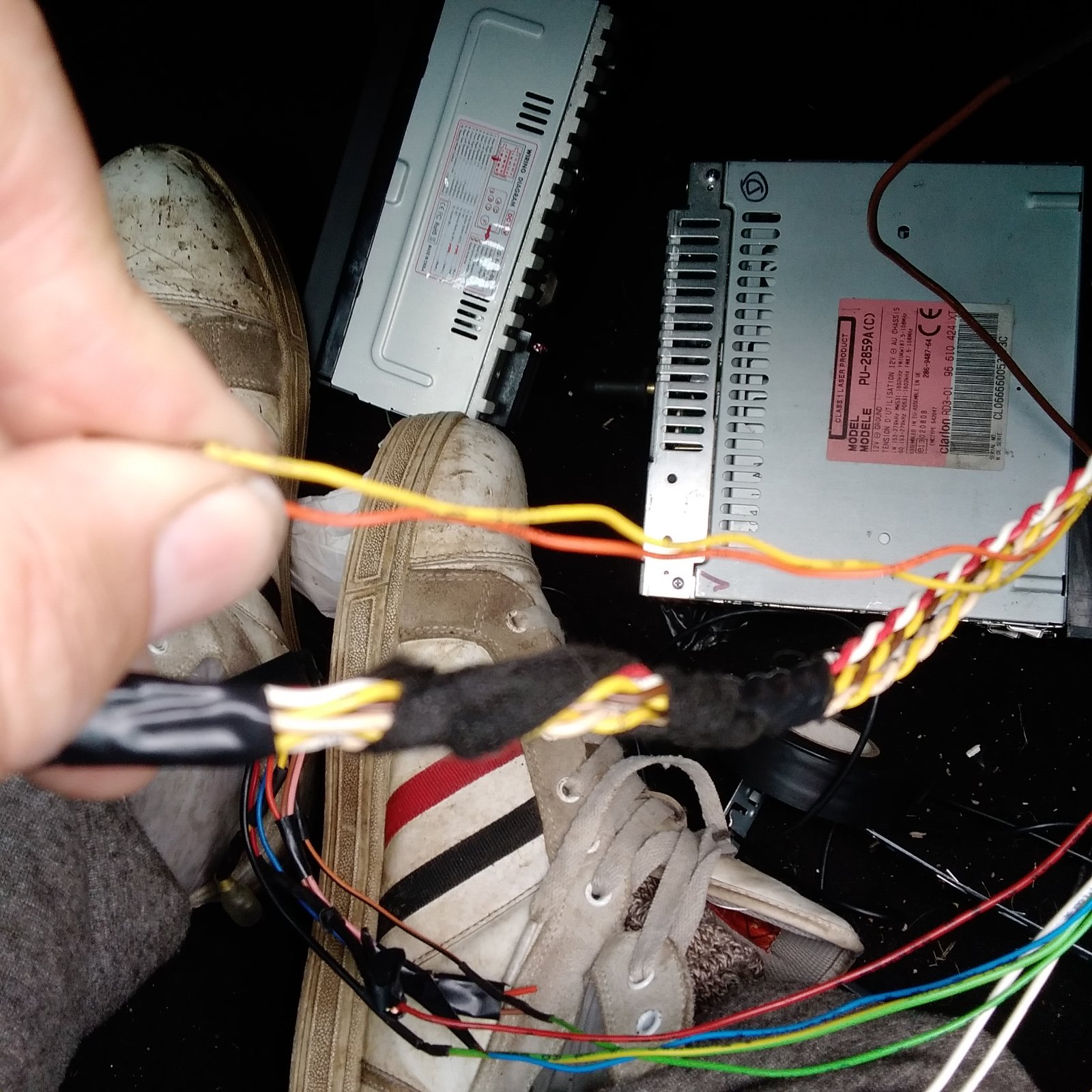

I know only BE10C as wheeler posted is battery live how do i find what the other codes on the wires do ?
Ok rechecked the wire codes & as follows
BE11A WHITE
XE24*D BLUE
CE18*D GREEN
MC30R GREEN/YELLOW
8454D 64AO RED
I have now found a yellow and an orange wire in the speaker loom taped off see attached photo, codes are what looks like as follows 6002 orange wire.
Ecce yellow wire
BE11A WHITE
XE24*D BLUE
CE18*D GREEN
MC30R GREEN/YELLOW
8454D 64AO RED
Ecce yellow wire

Pin 6 if im right on my diagram is 8454 ignition live ?
Husky.
- x 6947
Re: Refitting 206cc car cd stereo thing !
Can we confirm you are working with the Head Unit and also the equaliser Amplifier first of all as these 2 are linked together.
The speaker outputs from the head unit (8 pin white connector) go to the amp (16 pin black connector) and from there to the speakers.
In addition, the amplifier has the battery positive on pin 9 and the earth on pin 16 (This will be the 16 pin black connector on the amplifier).
8454 on pin 7 of the same connector on the amp is the switched positive. So this is the ignition positive that is connected to pin 5 of the audio head unit 8 pin black connector.

OK I dont have a stereo diagram for your specific car but just had a look at a late Xsara model which should be very similar & also seems to tie up with that RD3 diagram you posted although all terminals may not be used on every model.
you should have
battery live this wire code identifier should start with a B. pin 7
your VAN+ supply that goes live when the network is awake. pin 4
Data & Data B wires, these wire codes should start with a 9 7 are normally a twisted pair. pins 2 & 3
Earth wire starts with MC. pin 8
amp switch on wire 8454 (listed as electric aerial output on your picture) Pin 5 (not this will normally be powered from the stereo itself & probably not an ignition live so you may not see any power on this wire till the radio is plugged in)
there will likely be no true ignition live at your radio as its switched on via the multiplex network, this is part of the reason why some people can have issues installing aftermarket radios & the VAN+ (pin 4) wire often gets mistaken for an ignition live.

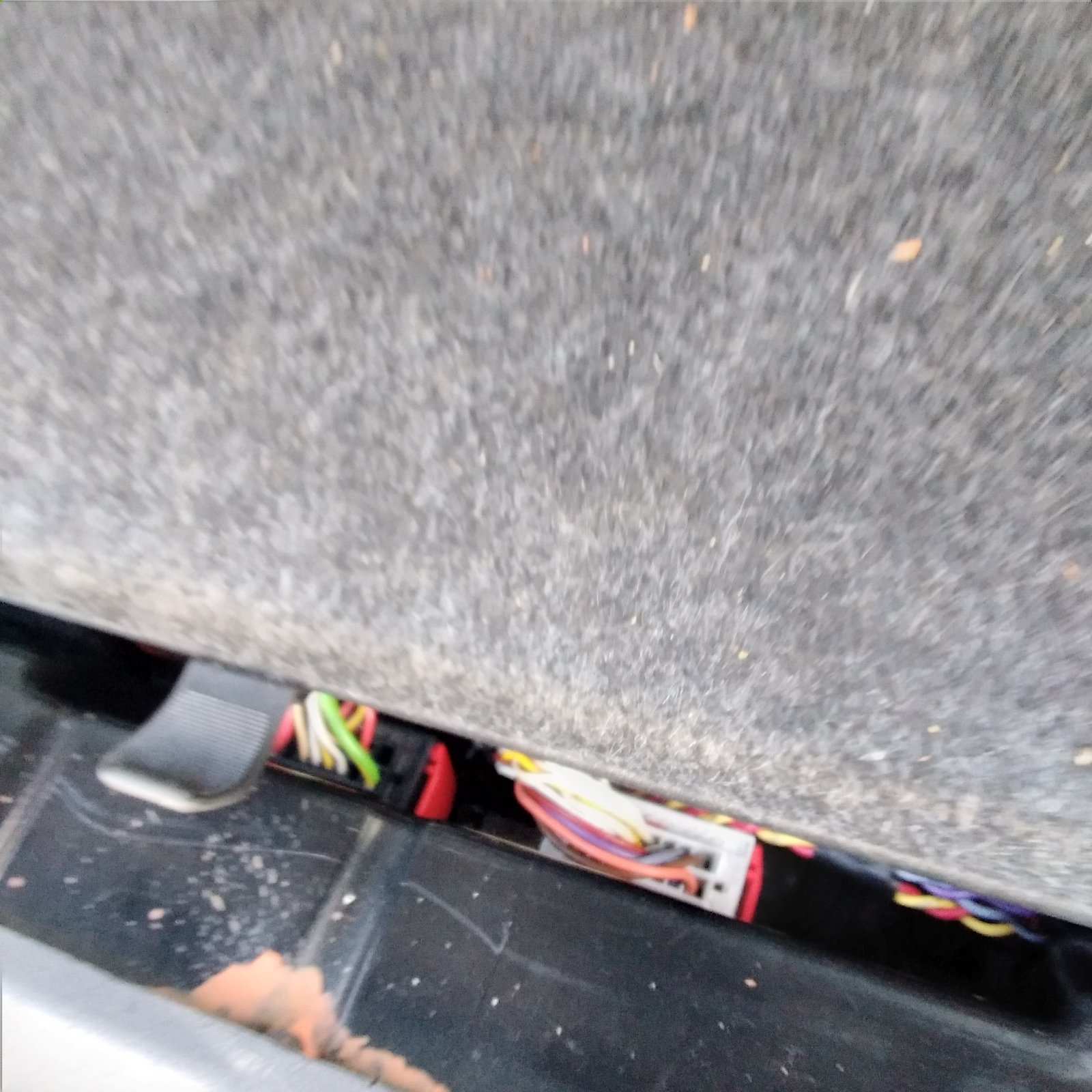

Plugs on back of boot speaker sub box
Husky.
