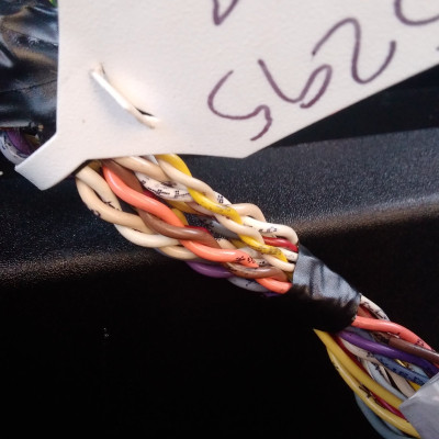

Hello,
Help urgently needed regarding refitting hopefully an original clarion PU-2859A(C) cd radio back to the 2006 206cc
The speaker plug is ok its the one with the power and such im stuck as the original plug was cut off and replaced with an aftermarket job. I need to know what color wire goes to where in the socket photos to show what i mean thanks for any help

Without looking it up i would be pretty certain that that will come as a complete interior harness. The repair plugs & terminals can be bought separately from PSA but they dont come wired, you need to crimp & wire them yourself.
The actual plugs themselves are just standard ISO plug readily available in ant car spares shop or ebay
https://www.ebay.co.uk/itm/153413072717 ... Sw9zdch9Fk
Try & look at the wires that have been cut & see if you can identify the codes printed on the wires, these take priority over colours on PSA cars. once you have the codes we can work out what goes where.

I updated this a bit on the parts request thread, PSA dont prioritise wire colours but use the codes printed on the wire for identification.
You can see some already in the pictures, BE10C for example is the battery live. Identify the codes on the wires then we can work out what goes where.

Heres my findings
Red 64AO 0446
Solid green CE18*D0666
Green/yellow 64 AO 0456
Blue 48 UX 0536
Thick white wire BE 11A * D* 55HX 0416
Thinner white wire BE10C*D 62 RP 0456
Hope that sheds some light.
:-D
Huskyxantia
Posts: 3435
Joined: 30 Jul 2018, 22:11
x 757
Re: Refitting 206cc car cd stereo thing !
Unread post by Huskyxantia »
Some photos of the wires. Difficult with a tablet and sorry for so many hope these help, all this hassle due to former owner cutting off the factory fitted plugs.
