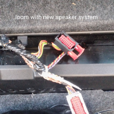

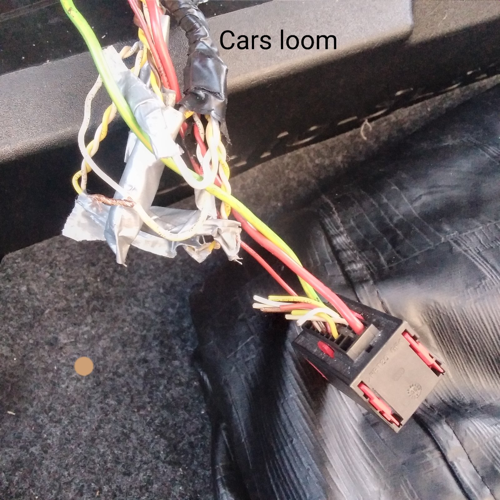

When i got my 206cc last yr someone had taken the rear bass speaker box out that bolts to the floor of the car so ive got an reclaimed fully working one to put back in its rightful place , my loom has been cut and the loom with this replacement has also been cut
Photos attached show what im trying to explain

All sorted they looped from one plug to the other .

Brought a part from a 206cc being broken up think ive sorted the wires now they went from one plug to the other.wheeler wrote: 25 May 2022, 19:01 Bit more info needed, what exactly have you bought? Dont understand what you mean by a rear speaker box.

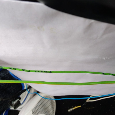

Heres my findings
Red 64AO 0446
Solid green CE18*D0666
Green/yellow 64 AO 0456
Blue 48 UX 0536
Thick white wire BE 11A * D* 55HX 0416
Thinner white wire BE10C*D 62 RP 0456
Hope that sheds some light.
Red 64AO 0446
Blue 48 UX 0536
Husky.
Huskyxantia
- Posts: 3942
- Joined: 30 Jul 2018, 22:11
- x 927
Re: Refitting 206cc car cd stereo thing !
