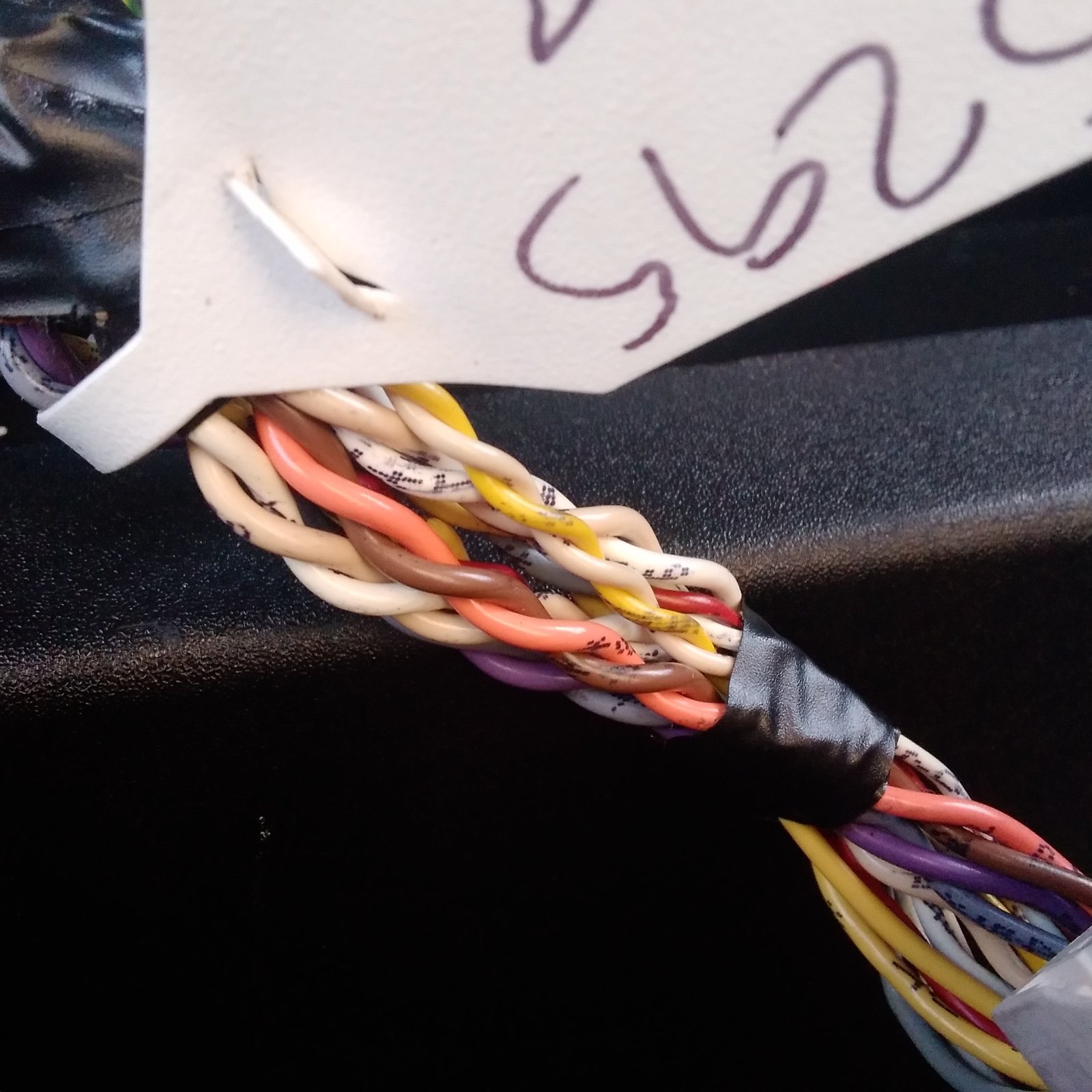

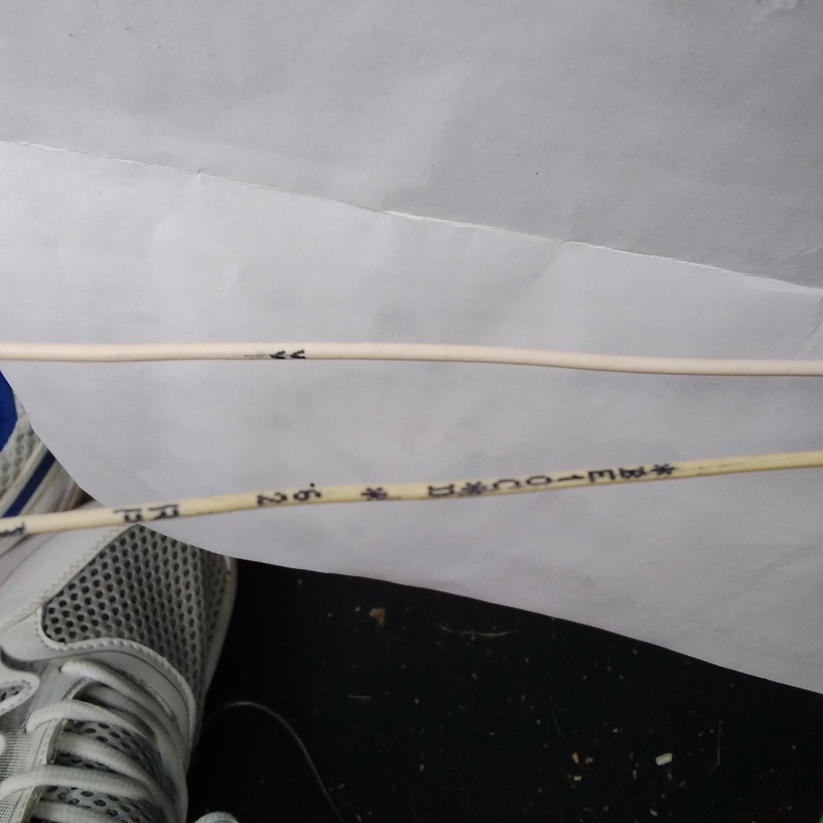

PU-2859 A Plugs
Hi marc, im looking for the loom plugs for a recently purchased clarion PU-2859 A(C) and where the colors corresponded to what pin on the unit for my 206cc, as im returning the original features back to it, fingers crossed, thanks.
Edit... The ones in the car have been cut by previous owner and ive no idea what wire is for which pin this is as one can imagine doing ones head in !

Without looking it up i would be pretty certain that that will come as a complete interior harness. The repair plugs & terminals can be bought separately from PSA but they dont come wired, you need to crimp & wire them yourself.
The actual plugs themselves are just standard ISO plug readily available in ant car spares shop or ebay
https://www.ebay.co.uk/itm/153413072717 ... Sw9zdch9Fk
Try & look at the wires that have been cut & see if you can identify the codes printed on the wires, these take priority over colours on PSA cars. once you have the codes we can work out what goes where.
Re: Refitting 206cc car cd stereo thing !
I updated this a bit on the parts request thread, PSA dont prioritise wire colours but use the codes printed on the wire for identification.Huskyxantia wrote: ↑29 May 2022, 09:16 Anyone know color wire to which pin , im not finding much on my searches.
You can see some already in the pictures, BE10C for example is the battery live. Identify the codes on the wires then we can work out what goes where.

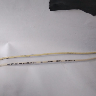

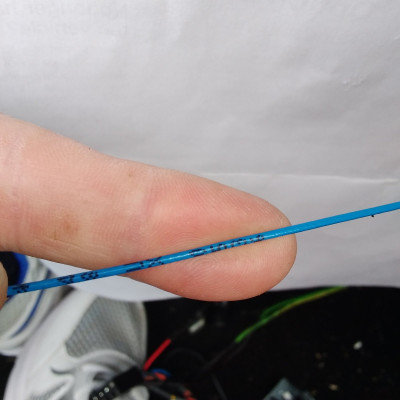

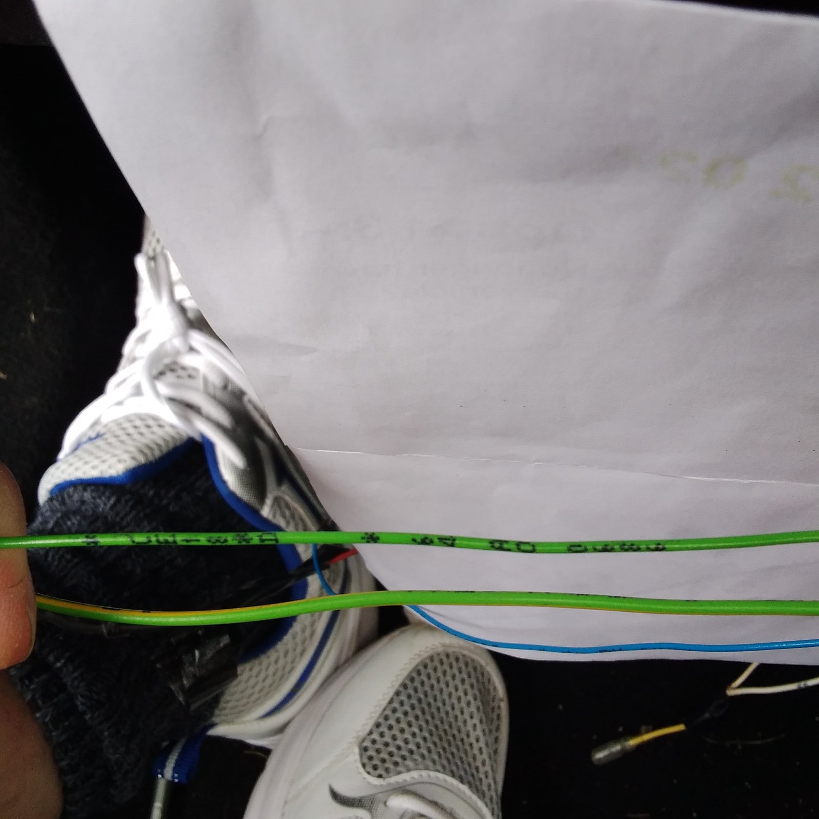

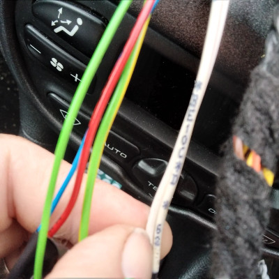

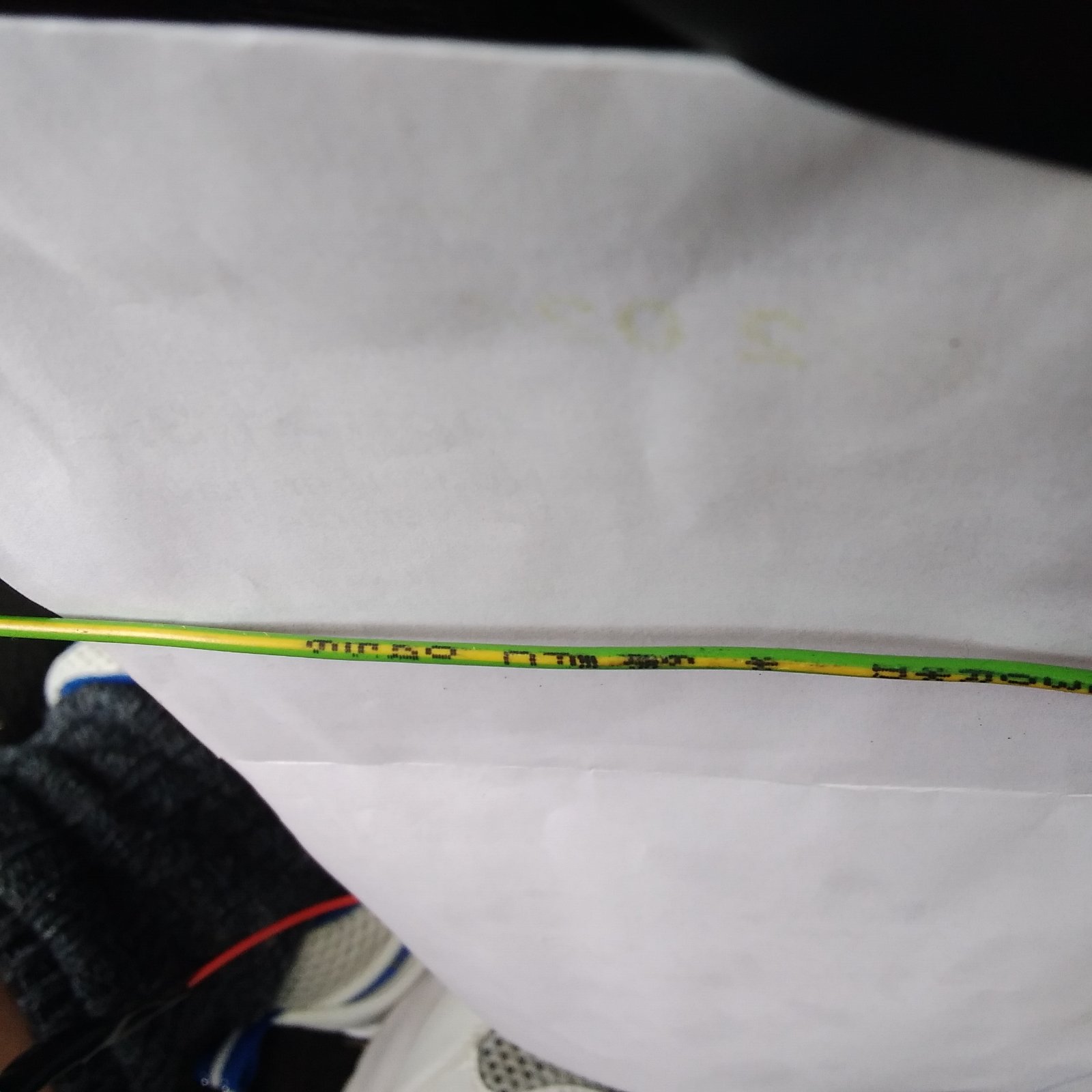

Heres my findings
Red 64AO 0446
Solid green CE18*D0666
Green/yellow 64 AO 0456
Blue 48 UX 0536
Thick white wire BE 11A * D* 55HX 0416
Thinner white wire BE10C*D 62 RP 0456
Hope that sheds some light.

Some photos of the wires. Difficult with a tablet and sorry for so many hope these help, all this hassle due to former owner cutting off the factory fitted plugs.
