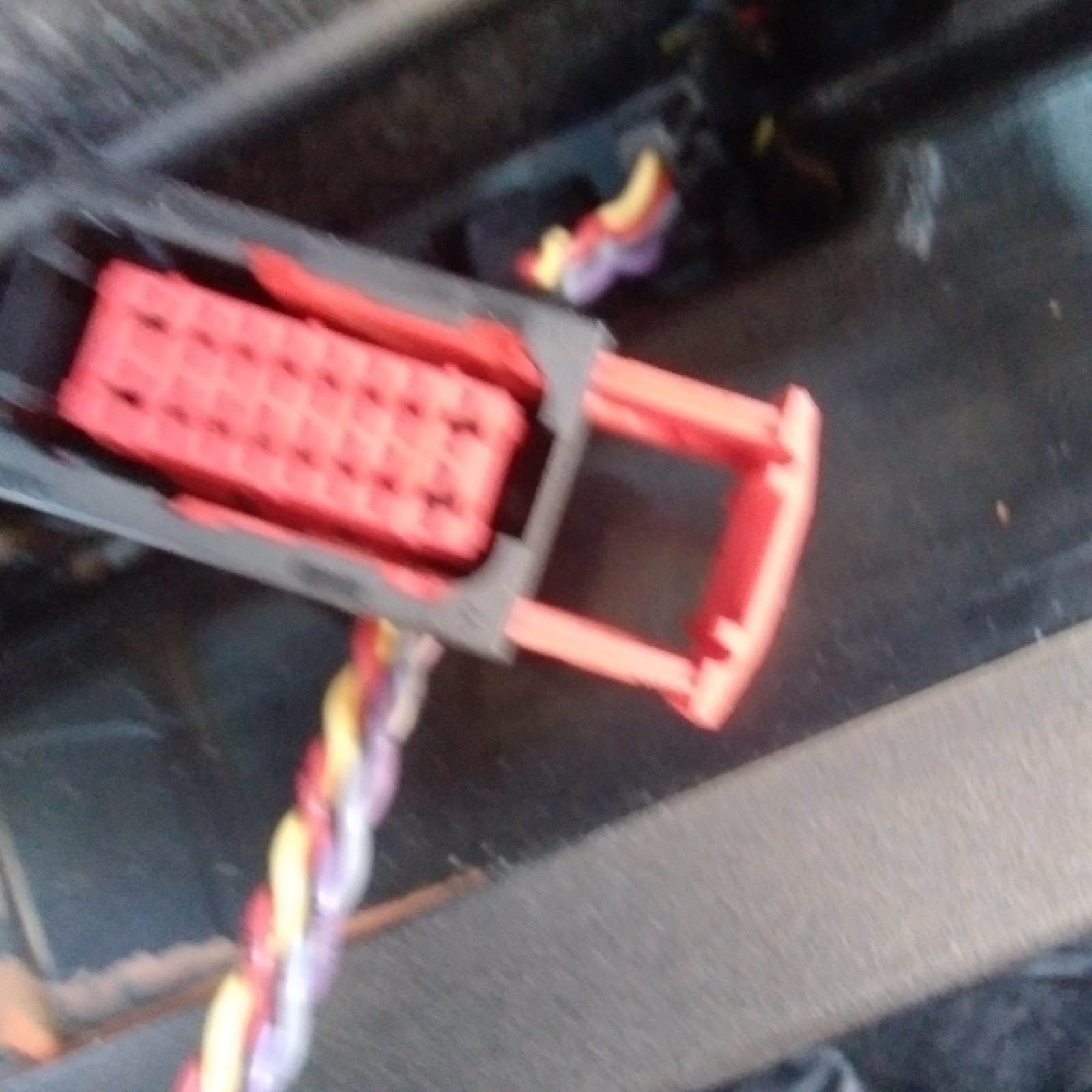

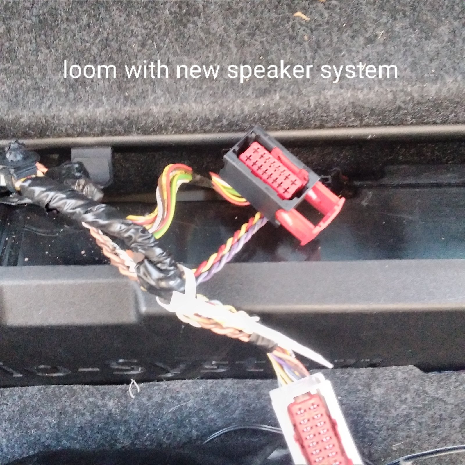

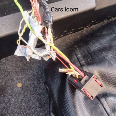

When i got my 206cc last yr someone had taken the rear bass speaker box out that bolts to the floor of the car so ive got an reclaimed fully working one to put back in its rightful place , my loom has been cut and the loom with this replacement has also been cut
Photos attached show what im trying to explain

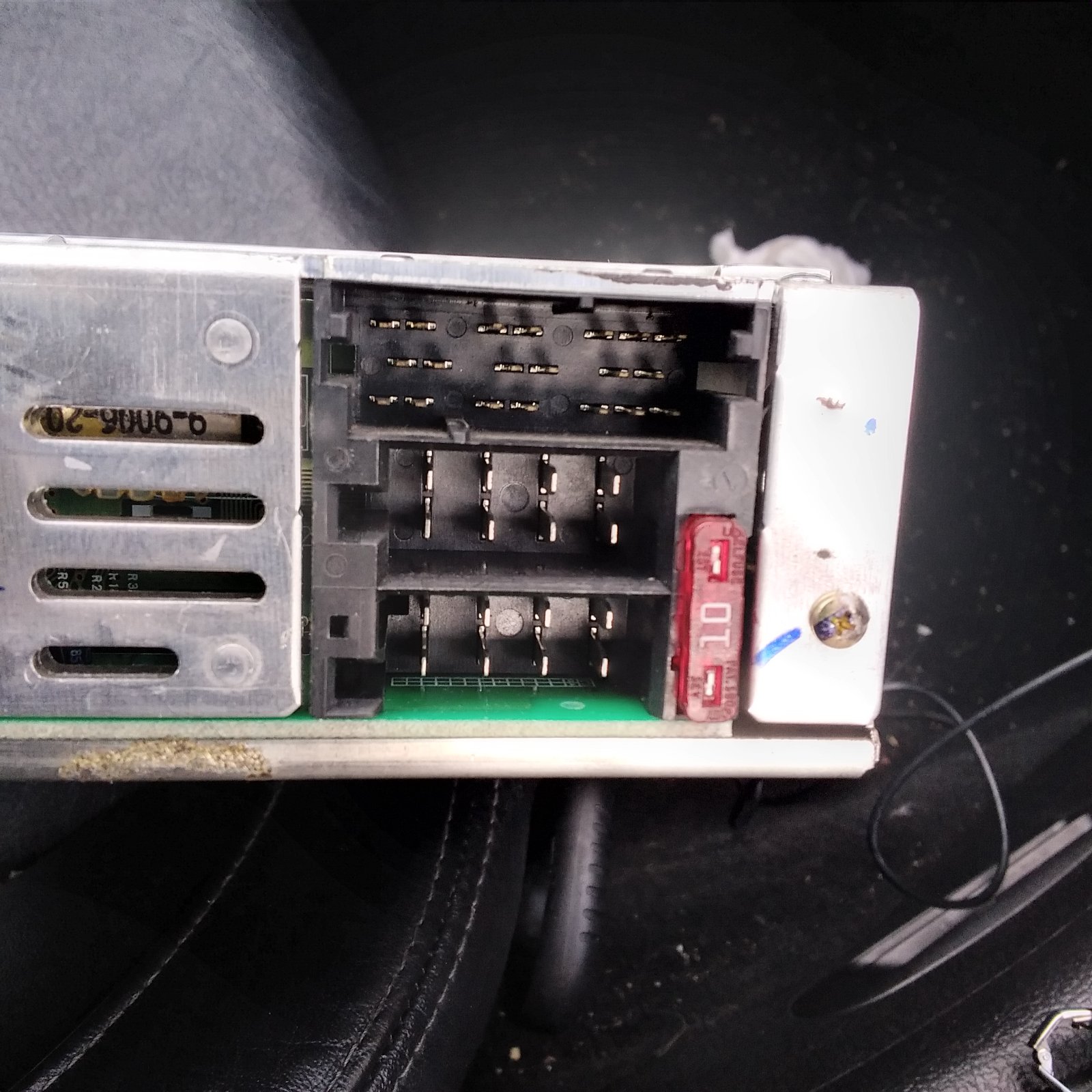

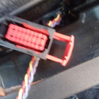

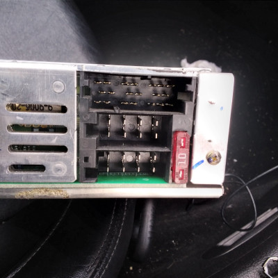

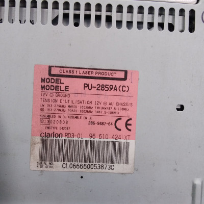

Hello,
Help urgently needed regarding refitting hopefully an original clarion PU-2859A(C) cd radio back to the 2006 206cc
The speaker plug is ok its the one with the power and such im stuck as the original plug was cut off and replaced with an aftermarket job. I need to know what color wire goes to where in the socket photos to show what i mean thanks for any help

Re: Rear boot speaker system
Unread post by Huskyxantia »
All sorted they looped from one plug to the other .

Brought a part from a 206cc being broken up think ive sorted the wires now they went from one plug to the other.

PU-2859 A Plugs
Hi marc, im looking for the loom plugs for a recently purchased clarion PU-2859 A(C) and where the colors corresponded to what pin on the unit for my 206cc, as im returning the original features back to it, fingers crossed, thanks.
Edit... The ones in the car have been cut by previous owner and ive no idea what wire is for which pin this is as one can imagine doing ones head in !

wheeler
Posts: 7927
Joined: 21 Sep 2002, 19:07
x 1056
Unread post by wheeler »
Huskyxantia wrote: 29 May 2022, 09:29 Hi marc, im looking for the loom plugs for a recently purchased clarion PU-2859 A(C) and where the colors corresponded to what pin on the unit for my 206cc, as im returning the original features back to it, fingers crossed, thanks.
Without looking it up i would be pretty certain that that will come as a complete interior harness. The repair plugs & terminals can be bought separately from PSA but they dont come wired, you need to crimp & wire them yourself.
The actual plugs themselves are just standard ISO plug readily available in ant car spares shop or ebay
https://www.ebay.co.uk/itm/153413072717 ... Sw9zdch9Fk

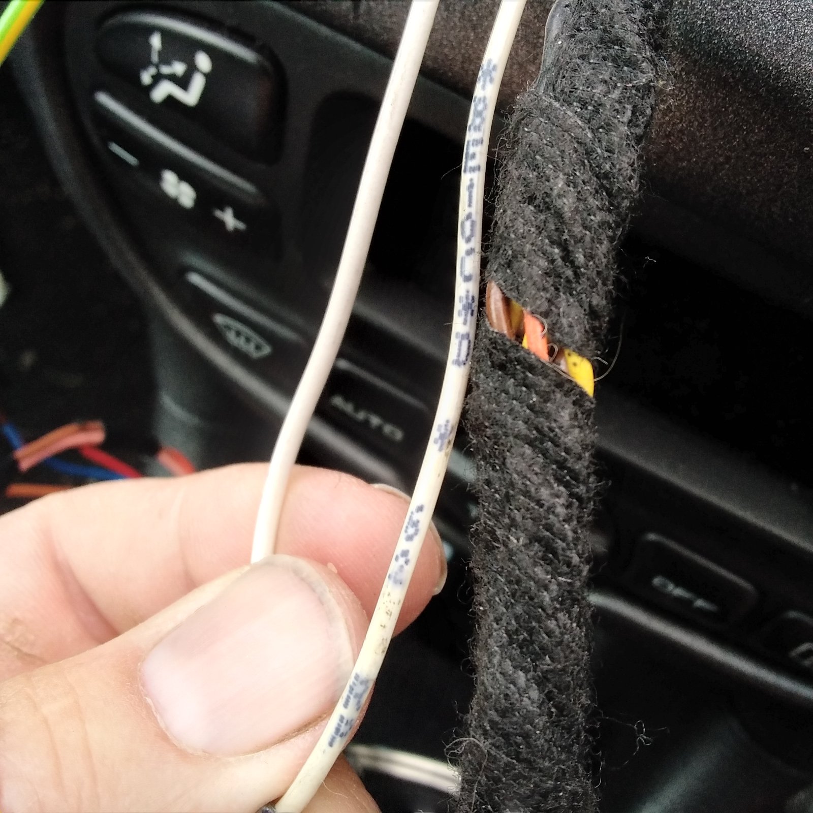

Try & look at the wires that have been cut & see if you can identify the codes printed on the wires, these take priority over colours on PSA cars. once you have the codes we can work out what goes where.

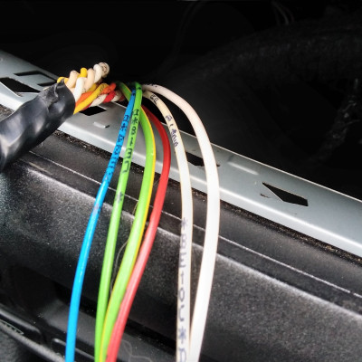

wheeler
Posts: 7927
x 1056
Re: Refitting 206cc car cd stereo thing !
Huskyxantia wrote: 29 May 2022, 09:16 Anyone know color wire to which pin , im not finding much on my searches.
I updated this a bit on the parts request thread, PSA dont prioritise wire colours but use the codes printed on the wire for identification.
You can see some already in the pictures, BE10C for example is the battery live. Identify the codes on the wires then we can work out what goes where.

I've moved this out of parts requests as it's likely to lead onto further posts outside the scope of the official parts thread.
The looms are only available separately, so as Wheeler mentioned, you may be able to pick up a suitable connector elsewhere as they are not sold.
As for the Pin Outs:
You have the RD3 system fitted from factory, with the Equaliser Amp option.
Here are the pinouts for these two:
Hardware
8410 : audio system /
8408 : radio amplifier
BM34 : engine slave unit 34 fuse(s)
Wiring
8454 : Ampli + switch command
8472 : Ampli + right-hand rear output command
8473 : Ampli - right-hand rear output command
8434 : Ampli + right-hand front output command
8435 : Ampli - right-hand front output command
8414 : Ampli + left-hand front output command
8415 : Ampli - left-hand front output command
8452 : Ampli + left-hand rear output command
8453 : Ampli - left-hand rear output command
MC20X: Earth
BE11F: Battery Positive

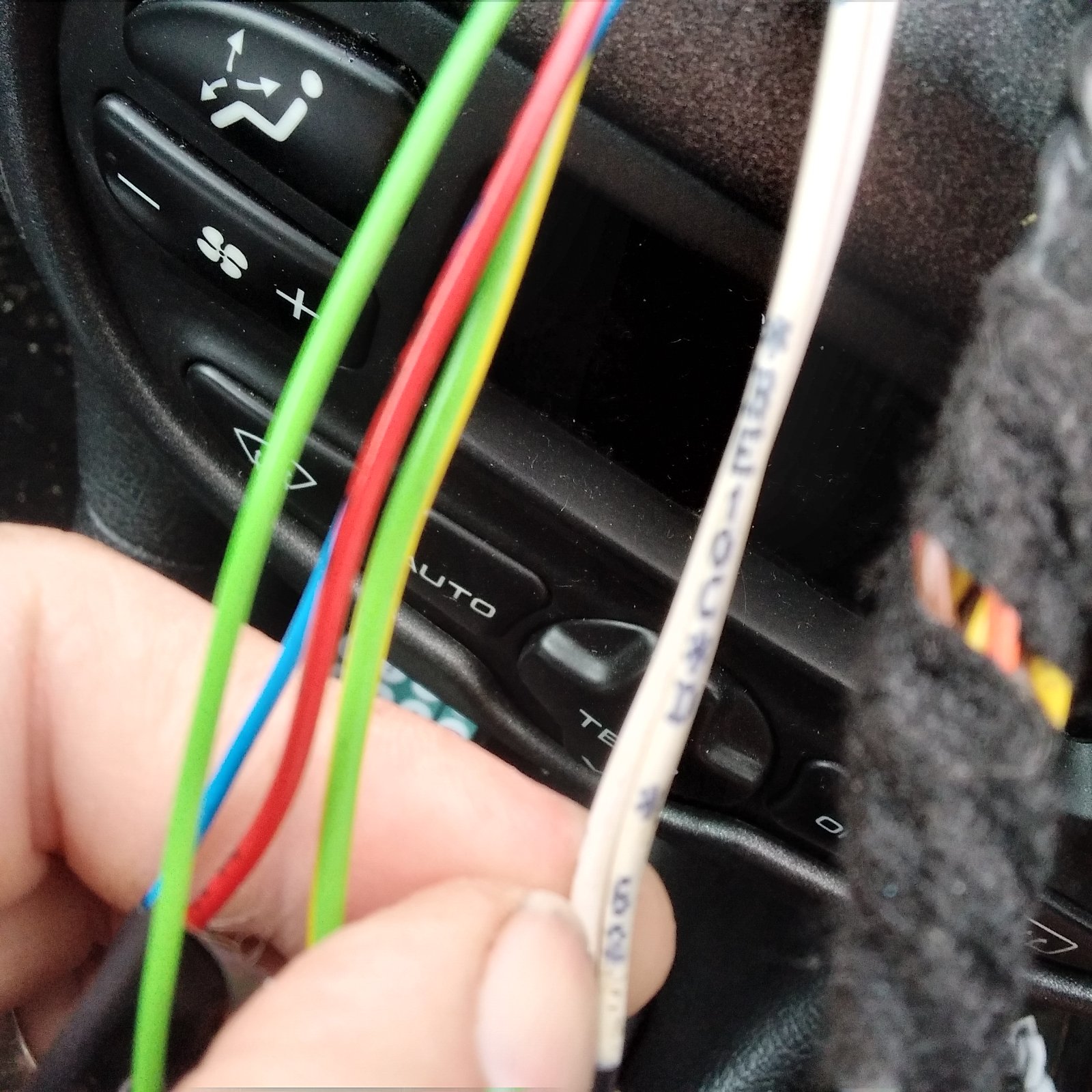

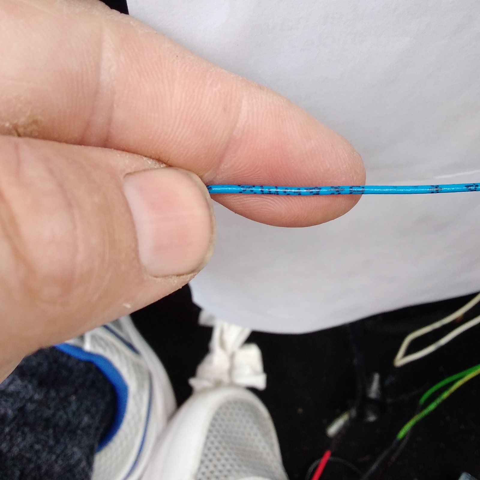

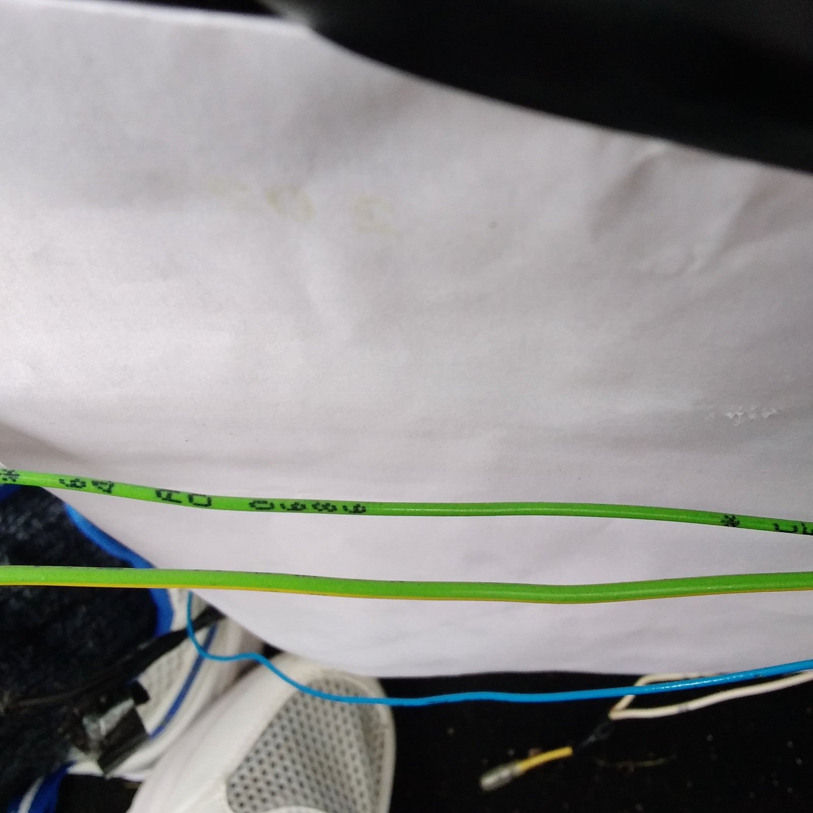

Heres my findings
Red 64AO 0446
Solid green CE18*D0666
Green/yellow 64 AO 0456
Blue 48 UX 0536
Thick white wire BE 11A * D* 55HX 0416
Thinner white wire BE10C*D 62 RP 0456
Hope that sheds some light.

Huskyxantia
Posts: 3858
Joined: 30 Jul 2018, 22:11
x 893
Some photos of the wires. Difficult with a tablet and sorry for so many hope these help, all this hassle due to former owner cutting off the factory fitted plugs.
