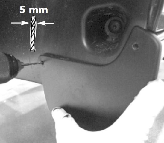

Hi guys, i just received a full set of moulded mud flaps for my C4GP (2014).
Instructions seem straightforward, but one thing I'm not sure about is where to screw into to fix them in place!.
Do i attach the flap by screwing into the metal 18mm lip of the wheel arch (which means i would need to drill small pilot holes) or do i screw onto the plastic splashguard that seems to be clipped onto the metal lip?
My splash lining has no screws showing so i cant remove screws and use them, im guessing the splash guard just clips on?
Any info much appreciated!

Are these the original Citroen Accessory mudflaps for you specific C4 GP? If so, they should come with illustrated instructions on how to fit - hence my question.
Re: C4 Grand Picasso (Mud flaps/guards) ?
I would have thoughit unlikely they would have you drill into the metal lip on the wheelarch. Normally if they are attaching to the metal lip they normally get clamped on.
Just the other week i fitted a genuine Peugeot set of front mudflaps to my uncles car for him & they get pop riveted on, first i had seen that. A metal pop rivet into a plastic wheelarch liner.

ok i got a screenshot of the mud flap with the issue i have, I've circled the screw hole in red colour where the issue is, this is the screw hole that just hangs out in thin air (nothing to fix to behind it!).
I've also outlined in green colour the section of the mud flap that has nothing to fix to, this is the part of mud flap that hangs over beyond the splash guard in my wheel arch. So I'm thinking i may have to trim this part of the mud flap?

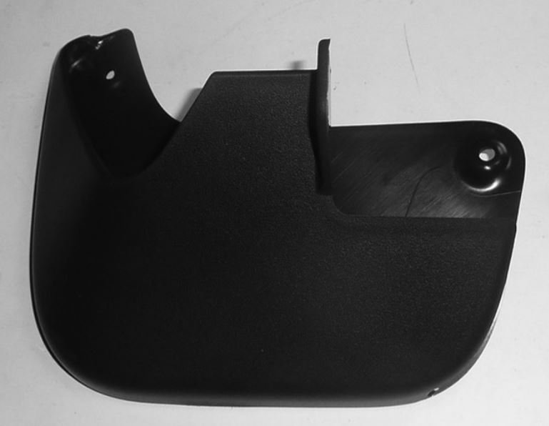

Yes, they are are a completely different shape and in the case of you vehicle-specific ones come with a single bracket and 2 rivets. That's why I only ever buy original mud flaps as they are designed specifically for the vehicle.
Citroen ones have 2 specific holes that are drilled only and these are rivetted on and a single clamping bracket fitted on the other side on the sill ridge. So you are only drilling 2 small holes at specific locations through the wheel arch splash shield only and then attaching the rear with a bracket over the sill to secure. That's how the custom ones are fitted at the front.
Here are some pics the front ones:
So either bodge it with the ones you have in the knowledge that these are not designed for your vehicle, or send them back and get a proper set. Expect to pay around £50 for the fronts and similar for the rears if you want bespoke OEM sets. They usually last the life of the car if you don't go over raised kerbs or similar.
