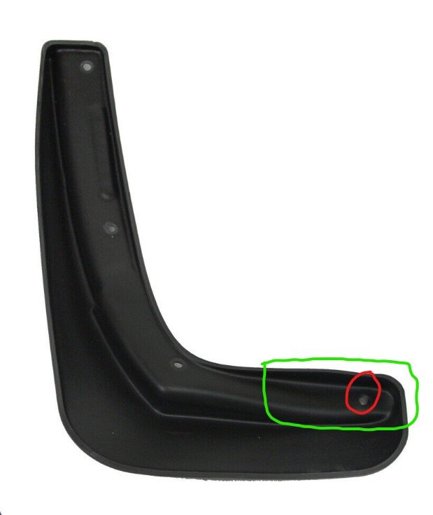

ok i got a screenshot of the mud flap with the issue i have, I've circled the screw hole in red colour where the issue is, this is the screw hole that just hangs out in thin air (nothing to fix to behind it!).
I've also outlined in green colour the section of the mud flap that has nothing to fix to, this is the part of mud flap that hangs over beyond the splash guard in my wheel arch. So I'm thinking i may have to trim this part of the mud flap?

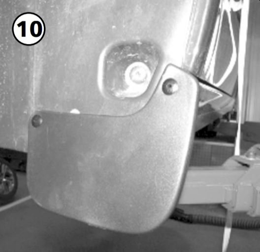

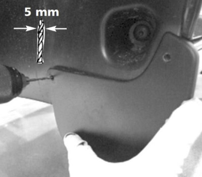

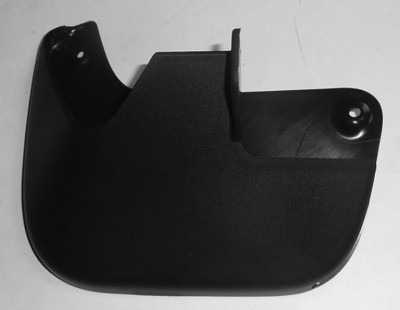

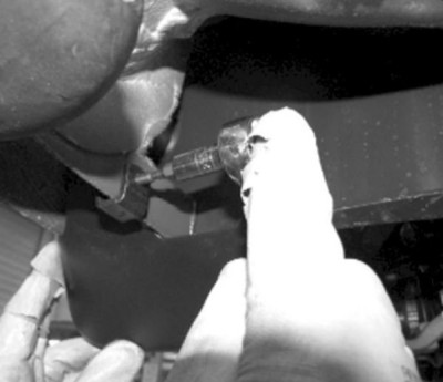

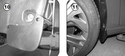

Yes, they are are a completely different shape and in the case of you vehicle-specific ones come with a single bracket and 2 rivets. That's why I only ever buy original mud flaps as they are designed specifically for the vehicle.
Citroen ones have 2 specific holes that are drilled only and these are rivetted on and a single clamping bracket fitted on the other side on the sill ridge. So you are only drilling 2 small holes at specific locations through the wheel arch splash shield only and then attaching the rear with a bracket over the sill to secure. That's how the custom ones are fitted at the front.
Here are some pics the front ones:
So either bodge it with the ones you have in the knowledge that these are not designed for your vehicle, or send them back and get a proper set. Expect to pay around £50 for the fronts and similar for the rears if you want bespoke OEM sets. They usually last the life of the car if you don't go over raised kerbs or similar.
