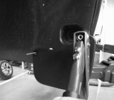

ok i got a screenshot of the mud flap with the issue i have, I've circled the screw hole in red colour where the issue is, this is the screw hole that just hangs out in thin air (nothing to fix to behind it!).
I've also outlined in green colour the section of the mud flap that has nothing to fix to, this is the part of mud flap that hangs over beyond the splash guard in my wheel arch. So I'm thinking i may have to trim this part of the mud flap?
bit of a long shot, but does anyone have any image of the actual OEM front mud flap for the 2014 Grand Picasso for me to compare?

I had a go today at fitting the mud front flaps, turns out the left hand side splashguard that the mud flap is meant to fasten to is damaged!! ...this was the reason why i thought i had the wrong type of mud flaps, the other side (driver side) went on perfectly
So i now need a new splashguard (passenger side front) I'm going to have a go at replacing it myself, I've had a little look online for tutorials etc but cant really find any info on replacing it, Is it a straight forward job? I know i have to remove the wheel, but other than this, is this the only thing i need to remove to remove & replace the splashguard?
Or do i need to remove more to fit it?

tizdaz
- Posts: 64
- Joined: 06 Mar 2022, 00:53
- x 4
Re: C4 Grand Picasso (Mud flaps/guards) ?
all this section on my splash guard is broken away
