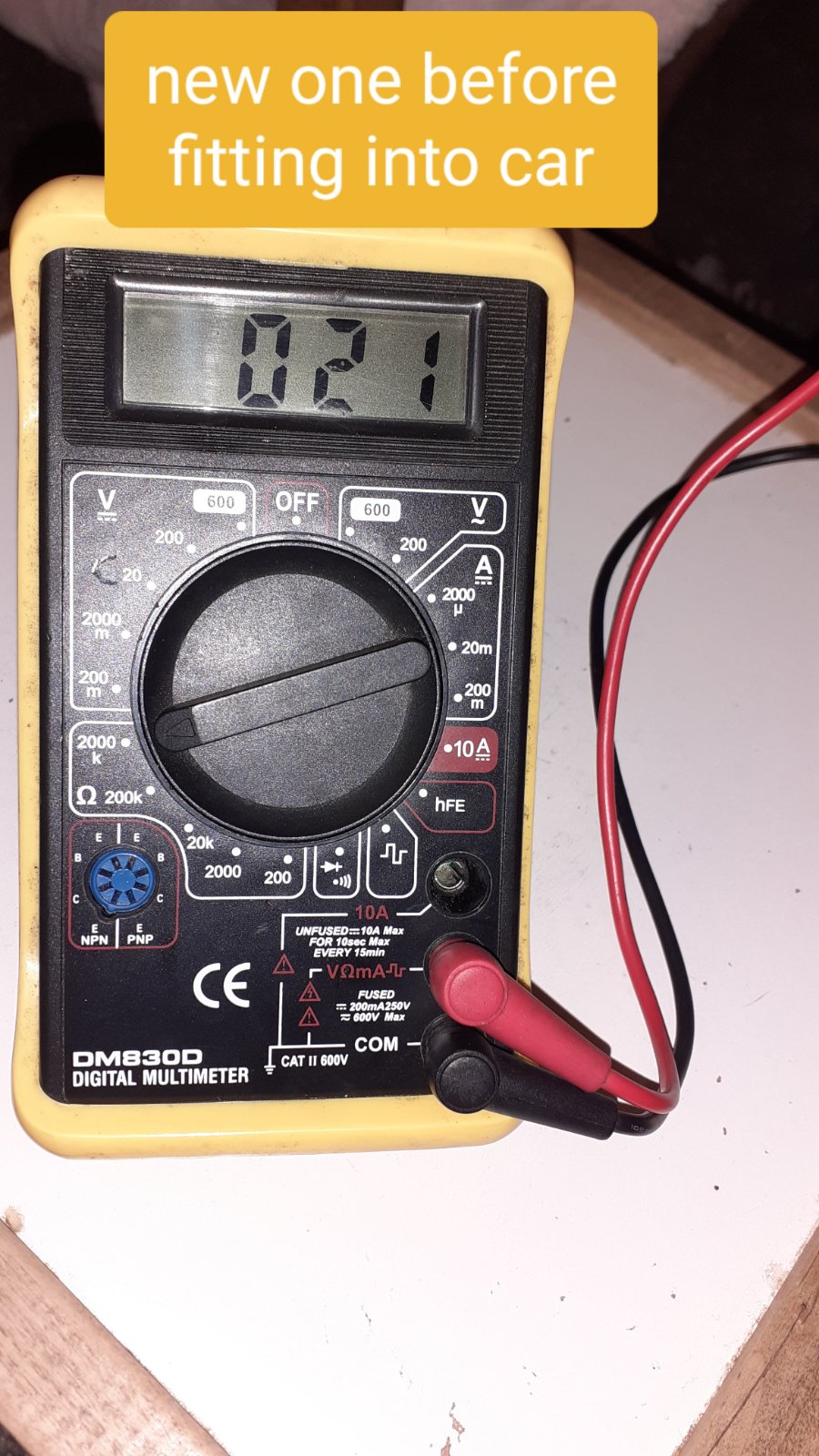

I would think so, but you've got the meter on 200 ohms only, did you try any of the larger scales? It might be more than that, but since it's giving a duff reading, I'd be inclined to think it was dead!

RichardW wrote: 14 Dec 2021, 13:01 I would think so, but you've got the meter on 200 ohms only, did you try any of the larger scales? It might be more than that, but since it's giving a duff reading, I'd be inclined to think it was dead!
Apologies Richard
What should i have it set on please
Many thanks

Just go through the various resistance settings and see if you get a reading on any of them.

Ok this may help, so the exhaust gas temp sensor is '4' below. The resistance is measured in KiloOhms (1000 Ohms = 1Kohm). So the resistance you are getting '1' would be about right for a temperature of 149 °C if you look at the graph below. The higher the resistance, the colder the gases are. There's not much room after about the 150 °C temp, as the line bottoms out. So the only way to tell of the temp sensor is faulty is allowing the car to completely cool down (say overnight and be ready to test it with everything connected) so that you can re-check the reading. If it's the same as before, then you may well have a faulty sensor.
You would need to let the car completely cool down, get it set up ready and then test it when the engine is cold to see of the Resistance goes up as shown in the table depending on exhaust gas temperature.

Useful info Marc, the meter needs to be set to 200k setting to get a sensible reading.

RichardW wrote: 14 Dec 2021, 21:33 Just go through the various resistance settings and see if you get a reading on any of them.
Ok slow reply again apologies
Few pictures to show my findings, no other readings on other settings.
Also found this tread online so looks like someone else has the same issue.
https://citroenc3owners.com/questions-a ... t4590.html
I've a 200 mile round trip tomorrow so will see what happens, but i scanned the car straight after fitting a new sensor and the scan showed the temperature of the sensor was 149°C ...

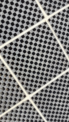

Well finally made some progress, removed the DPF to clean it loads of red Ash came out of it and it was amazing to see.
It was like if you had a red house brick and ground it down to dust that came out of the DPF when washing it.
I left it to stand in a container for 24 hours submerged in wynns off car DPF cleaner.
Came up a treat, I refitted back onto car and reset the car saying a replacement DPF fitted, and cleared previous fault codes,
Cars running fine now not getting any fault codes, no limp mode, and car is doing a regeneration fine.
Would just like to say a massive thank you to you all for your help.

Well done - cracking job. A lot of the stuff that blocks the filter is the Cerine in the additive. It's this that can't be burned off during regeneration and eventually leads to blocking. It is iron based, so hence the red tinge.
