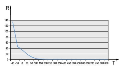

Ok this may help, so the exhaust gas temp sensor is '4' below. The resistance is measured in KiloOhms (1000 Ohms = 1Kohm). So the resistance you are getting '1' would be about right for a temperature of 149 °C if you look at the graph below. The higher the resistance, the colder the gases are. There's not much room after about the 150 °C temp, as the line bottoms out. So the only way to tell of the temp sensor is faulty is allowing the car to completely cool down (say overnight and be ready to test it with everything connected) so that you can re-check the reading. If it's the same as before, then you may well have a faulty sensor.
You would need to let the car completely cool down, get it set up ready and then test it when the engine is cold to see of the Resistance goes up as shown in the table depending on exhaust gas temperature.
(4) Particle filter upstream temperature sensor.
"a" Pressure take-off upstream of the particle filter.
"b" Pressure take-off downstream of the particle filter.
"R" Resistance R (In Kohms ).
"T" Coolant temperature (°C).
The NTC (Negative Temperature Coefficient) resistance value "R" changes in relation to the change in the temperature "T":
When the temperature "T" increases, the resistance value "R" decreases
When the temperature "T" decreases, the resistance value "R" increases

Useful info Marc, the meter needs to be set to 200k setting to get a sensible reading.
