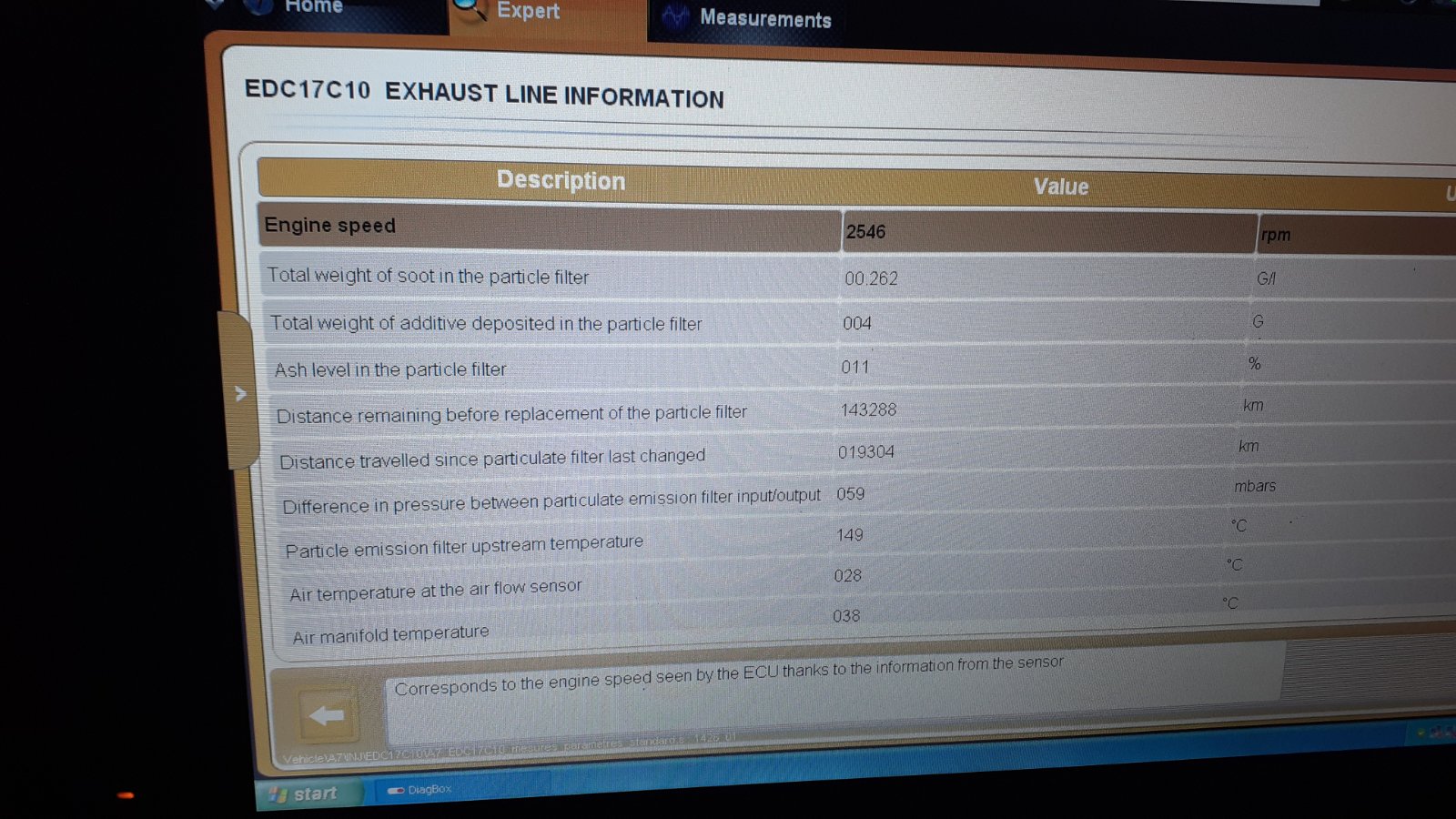

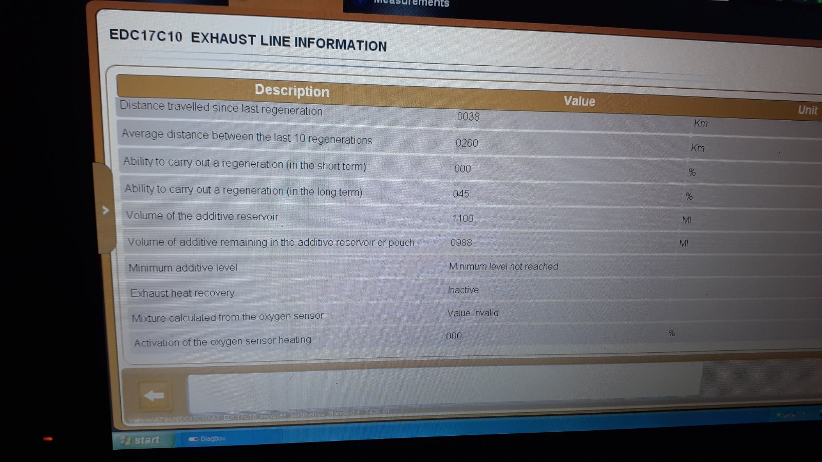

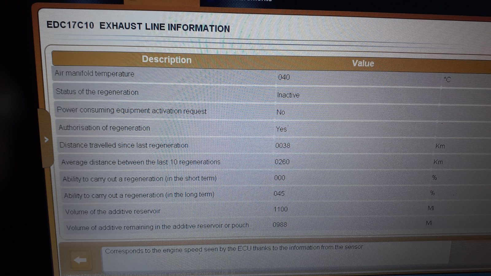

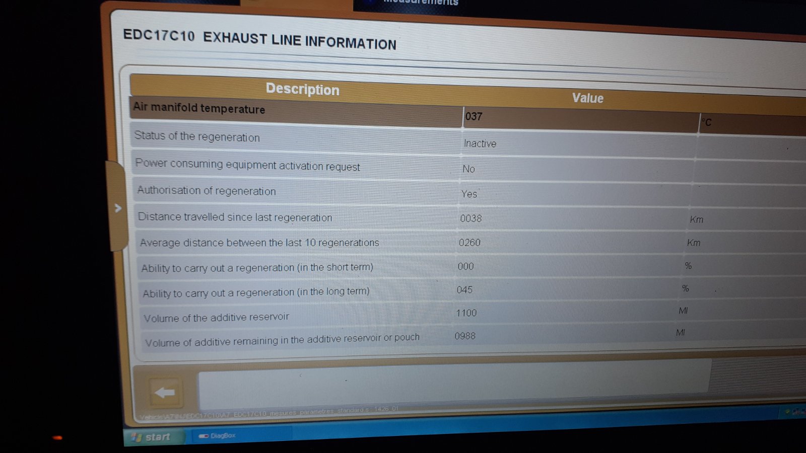

Re: Peugeot 207 fault code P1490, P242F
Hi
I took your advice and called a dpf cleaning company who wanted to charge £460 to clean it.
Somewhat reluctant to spend that sort of money, i decided to think about it.
And in the meantime my car done a regeneration, and all warning lights turned off by the car.
Approximately around 14 miles later "risk of particular filter clogging" flashes up and after a few times stays on the dash.

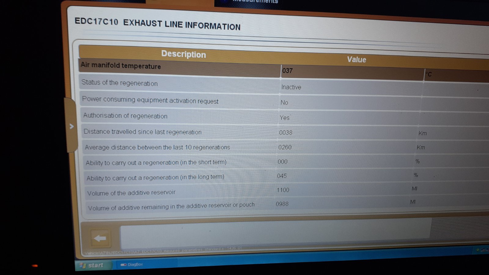

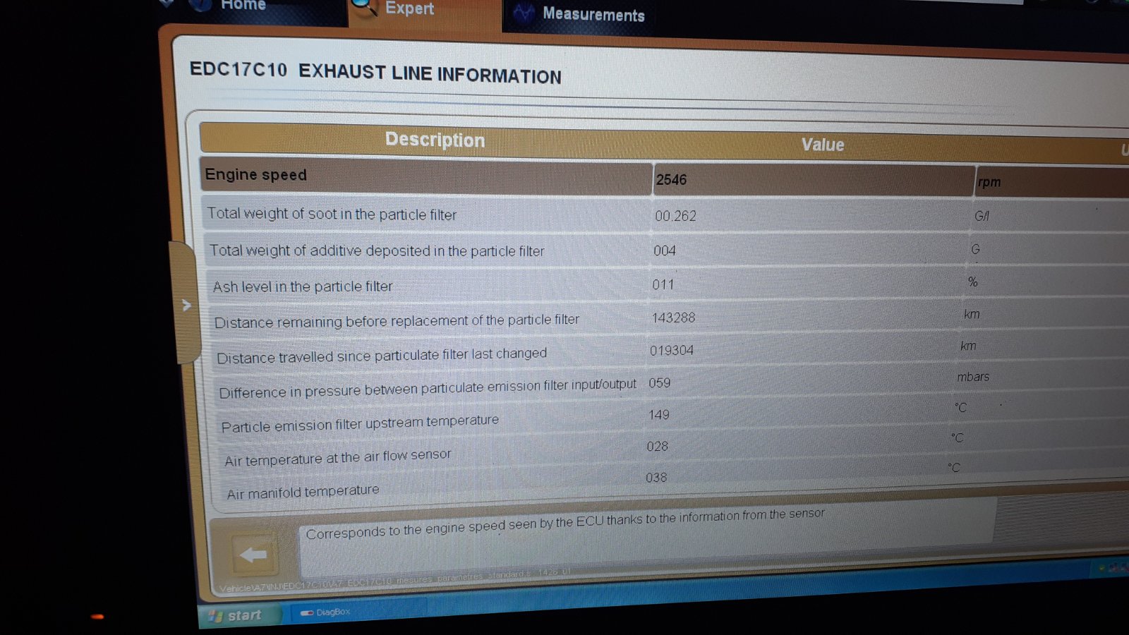

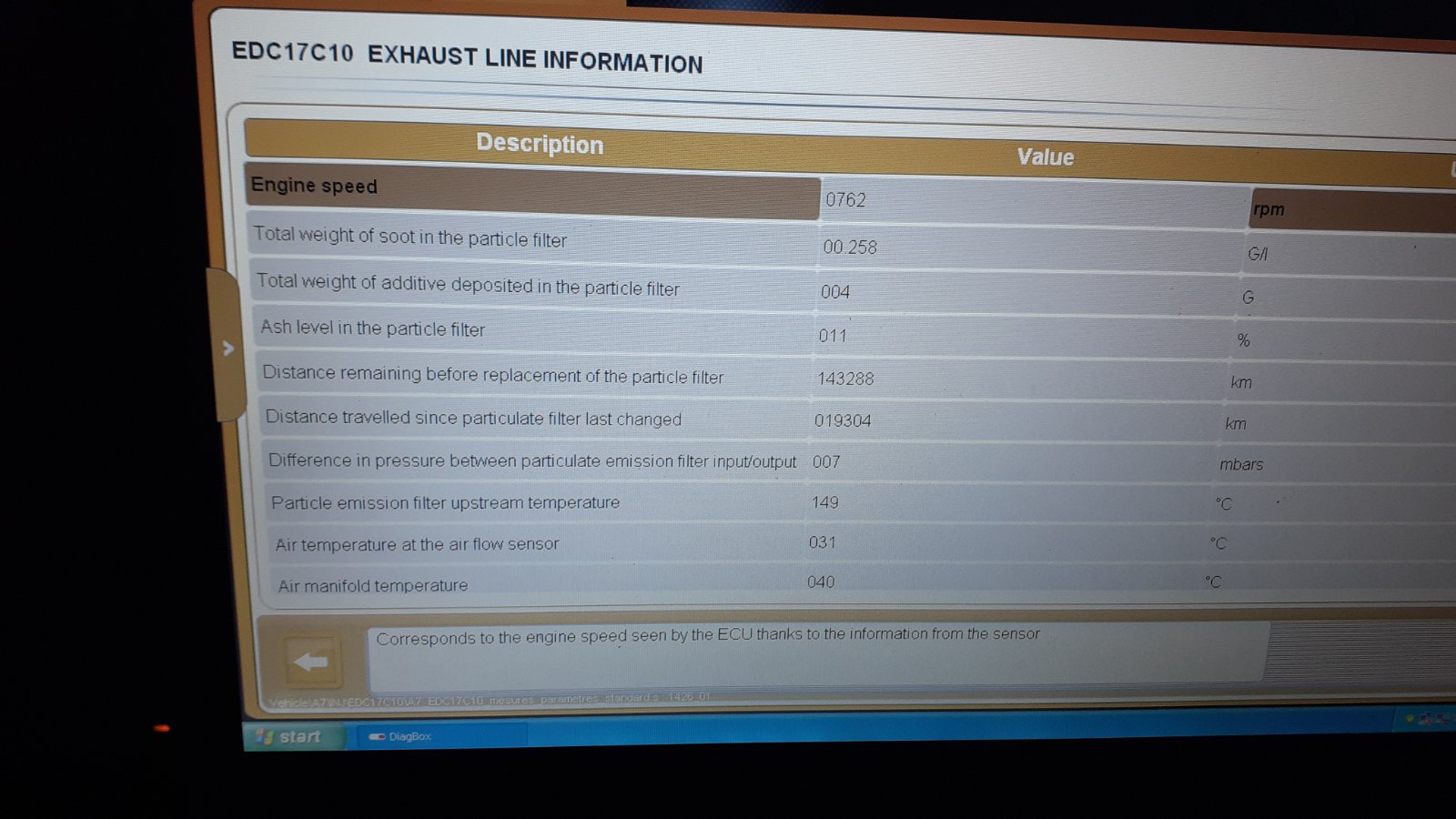

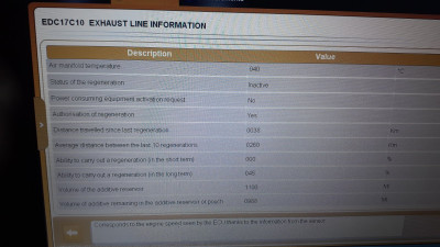

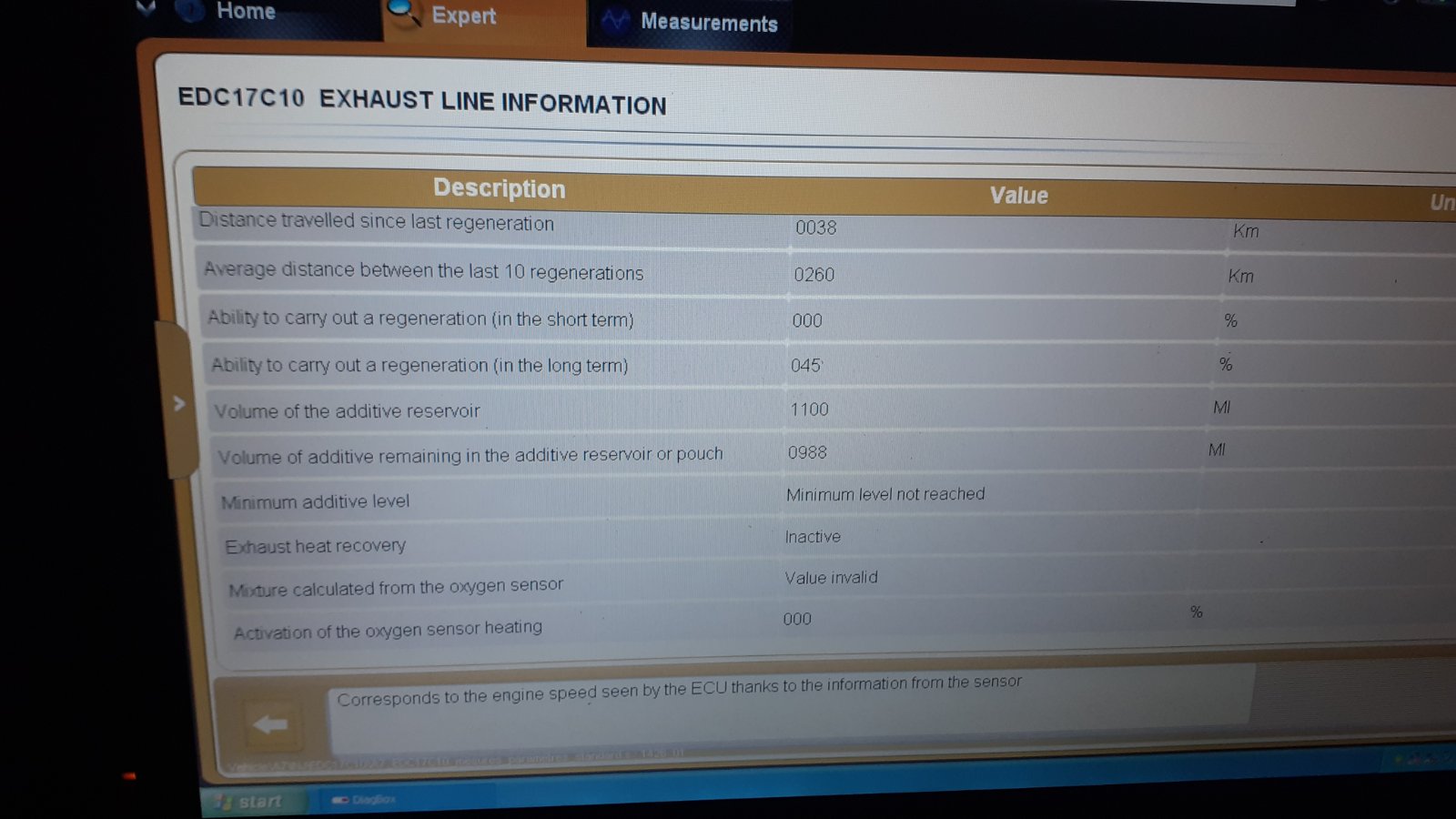

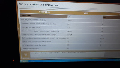

Got to work and done a live scan and to me the dpf does not look like it's anywhere near being blocked. The fault code I'm now getting is P1490 only no other codes.
Please see images below of the live scan on tick over and then at 2500 rpm

- Posts: 12565
- x 1484
If you click through the fault code, what info does it say about conditions when it occurred? In the pics above the oxygen sensor is reporting an invalid value - not sure if this is fitted, or if it even needs to give a reading normally!

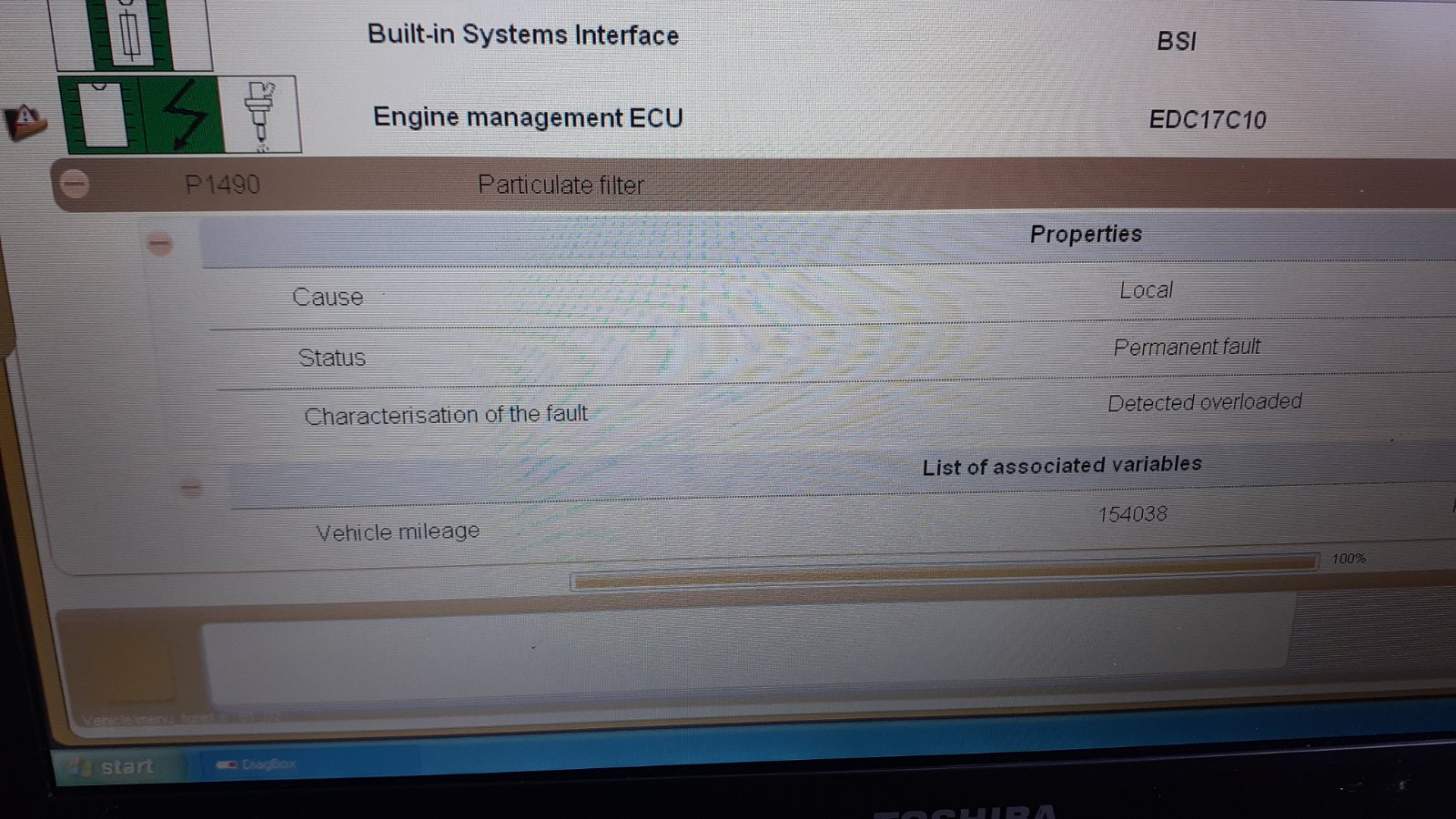

Hi

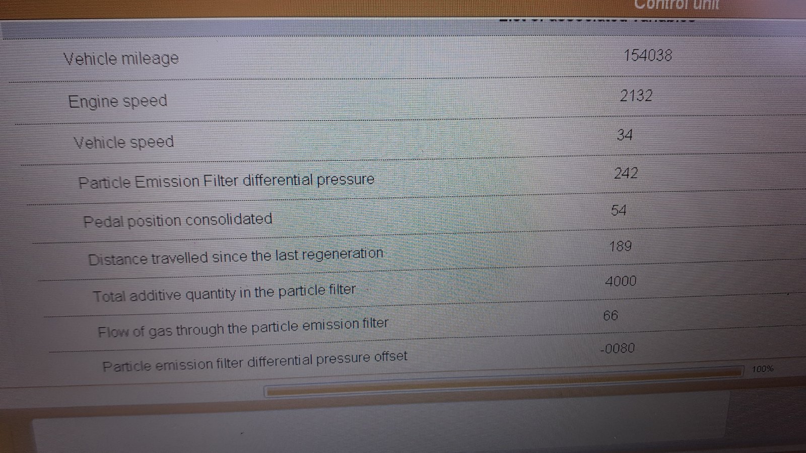

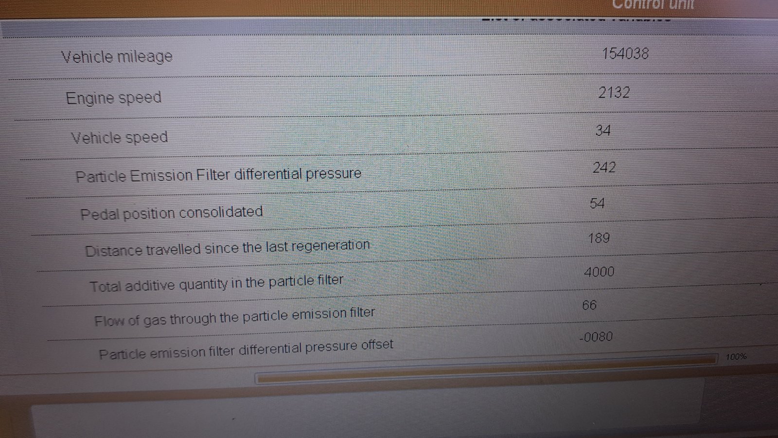

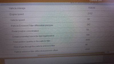

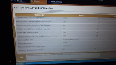

Here are a couple of pictures from that same code on Sunday morning,
Unfortunately i did not take pictures this morning but if need be i will plug in to get them and report back,
Thanks
Thanks
- x 6955
Also, according to that it says the particle filter has already been changed 19k KM ago???
The differential pressure shows as 059 mbar. The differential pressure sensor is designed to show the range of differential pressure measured as 0 ? differential pressure measured ? 100 kPa on this engine / system (1.4 DV4C).
059 mbar is 5.9 Kilopascals, so this would seem to indicate the system is nowhere near blocked.
- x 6955
Just seen you other pictures. Can you please advise what units 4000 on the particle filter additive load is please?
Hi Marc
Hence my confusion as to it being blocked, as I'm not sure how you read these scans, but by what I've looked up it appears it's no where near blocked,
But clearly the car does have an issue,
I changed the elroys fluid sometime ago and reset the counters but was still having this problem so it was suggested that i also told the cars ECU that the DPF had been replaced/cleaned even though it has not been.
Apparently this can sometimes help clear the fault but in my case it did not.
Thanks

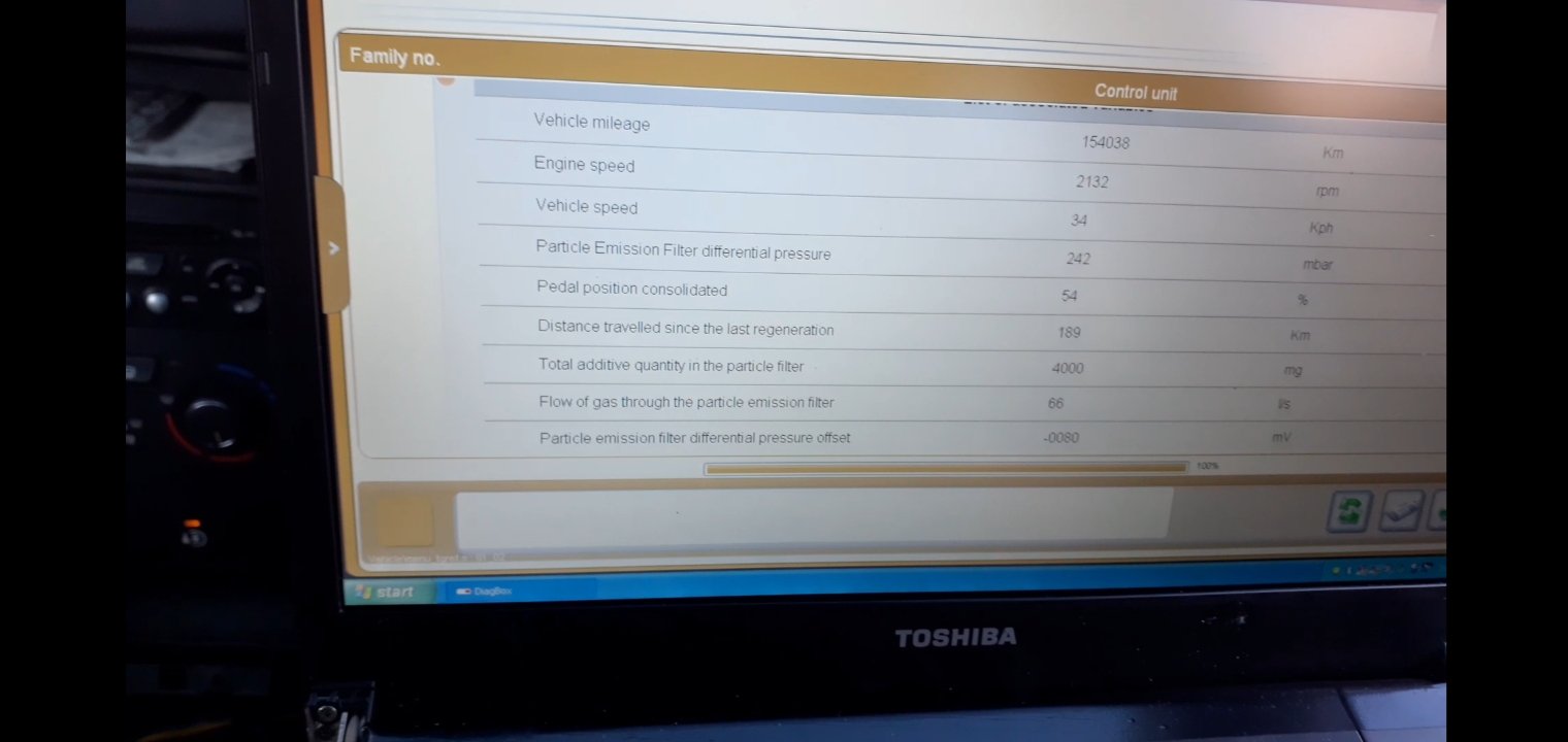

Ah just found it on my Sunday morning scan it is in MgGiveMeABreak wrote: 07 Dec 2021, 10:08 Just seen you other pictures. Can you please advise what units 4000 on the particle filter additive load is please?
Thanks
- Posts: 12565
- x 1484
You've got 242 mbar at a flow of 66 l/s ( 237600 l/hr) - this would appear to be why it has set the code. Given that the pressure sensor appears to be working, it does appear to be a genuine fault. It would be worth graphing the pressure over a short run, along with the air flow to see if there is correlation. It could be a fault with the MAF giving shonky readings, but I'm leaning towards the DPF needing a clean. You can do it yourself with dishwasher tabs and brick acid - there's a vid somewhere I posted about it!

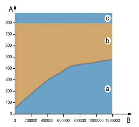

- x 6955
Yes that's the reading we were missing 242 Mbar... so in zone 'b' - overloaded.
"A" : Differential pressure (mbar).
"B" : Volume flow rate of exhaust gases (l/h).
"a" : Intermediate zone.
"b" : Filter overloaded.
"c" : Filter clogged.
