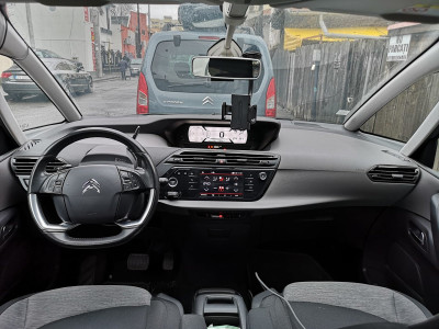

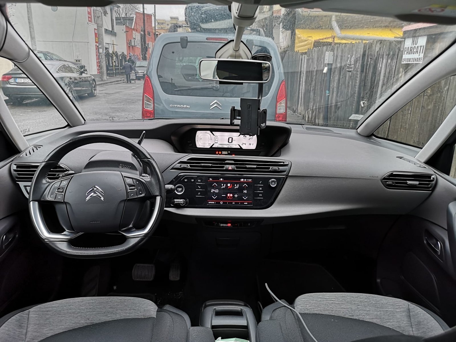

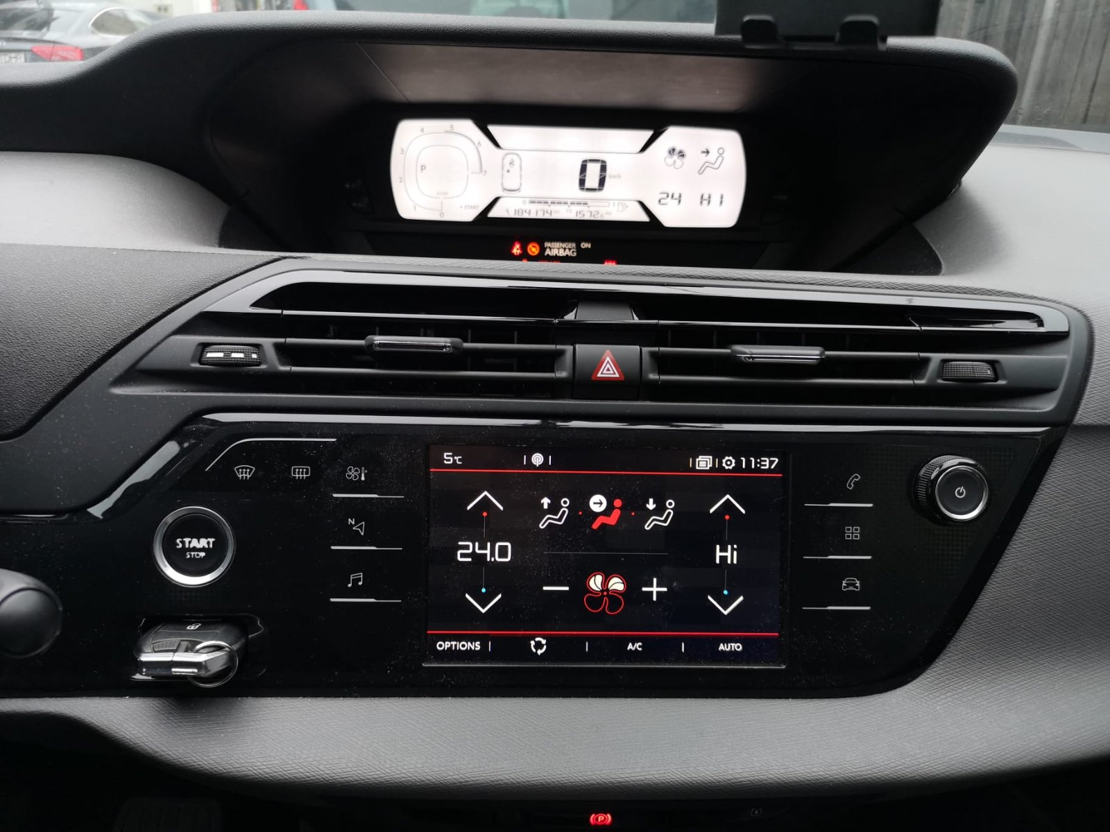

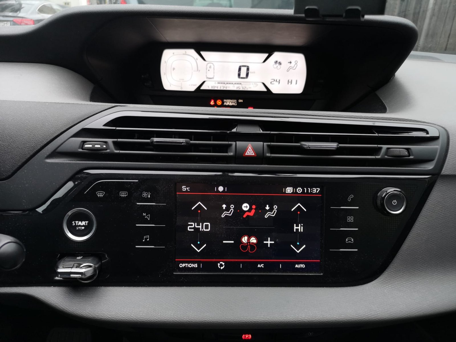

I'm also including two pictures of the dashboard as I've seen Picassos with very different layouts on YouTube.

It does... see the first photo where there are separate temperature scales on the left and right of the screen.GiveMeABreak wrote: 10 Jan 2022, 13:14 This vehicle does NOT have dual zone A/C. It is simply regulated for the whole vehicle, hence why there is only one heating control on the touch screen.

It might not have separate for the rear, but the front definitely is

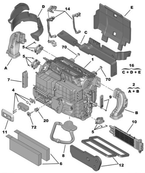

I'm afraid it's not that simple if you are going down that road Chris. The flaps are controlled by stepper motors (5) for both the air distribution and air mixing on each side. The 'flaps' are driven by the motors using control rods (14):
Getting to the main heater unit / evaporator is a fascia removal (dash out job). There are some components you may be able to get to by removing either side of the footwell panel trims.

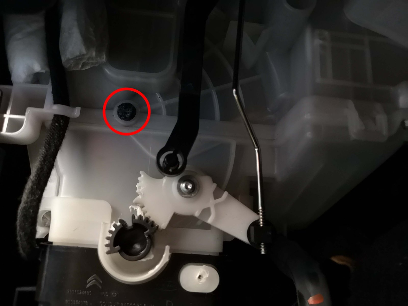

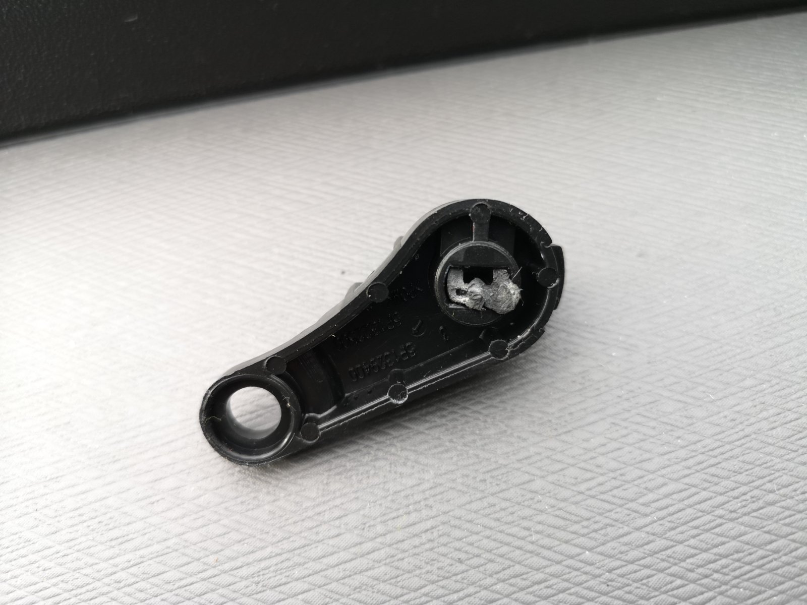

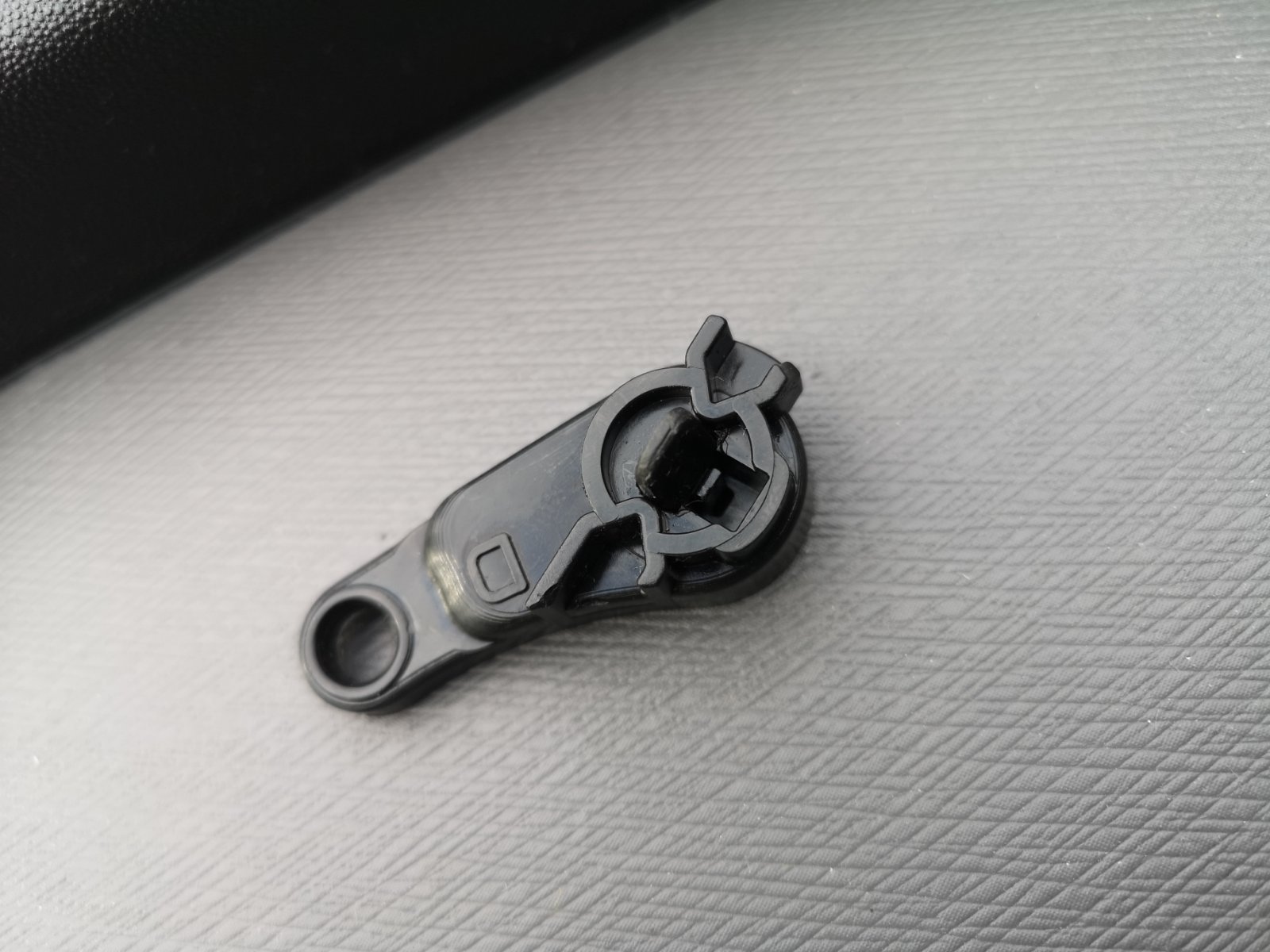

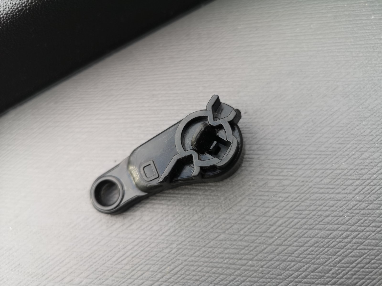

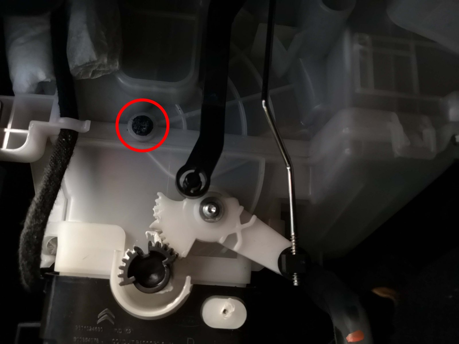

We opened the panels under the glove compartment and found a part had broken off from the heating unit. I've circled the place where it used to be attached in the 1st picture in red.
I've left the car at my friend's garage and he will try to improvise something to either reattach it or to at least force it to be stuck in the hot position instead of being stuck in the cold position.

Item (14) is the Air Conditioning Control Kit, part number: 9821297680, available from Citroen, priced (UK Sterling £112.64).
It's a fascia off to get the heating unit out. Those control arms are on the diagram item (14) that I mentioned earlier.chrisnasulea wrote: 12 Jan 2022, 17:41 Hello again,
No error codes were found using the tester.
Does anyone happen to have access to the instructions for the replacement of the heating unit?
Thanks,

No worries, these Picasso ones are a bit more Carlos Fandango-designed with the long control arms that seem to be brittle by the looks of it.
