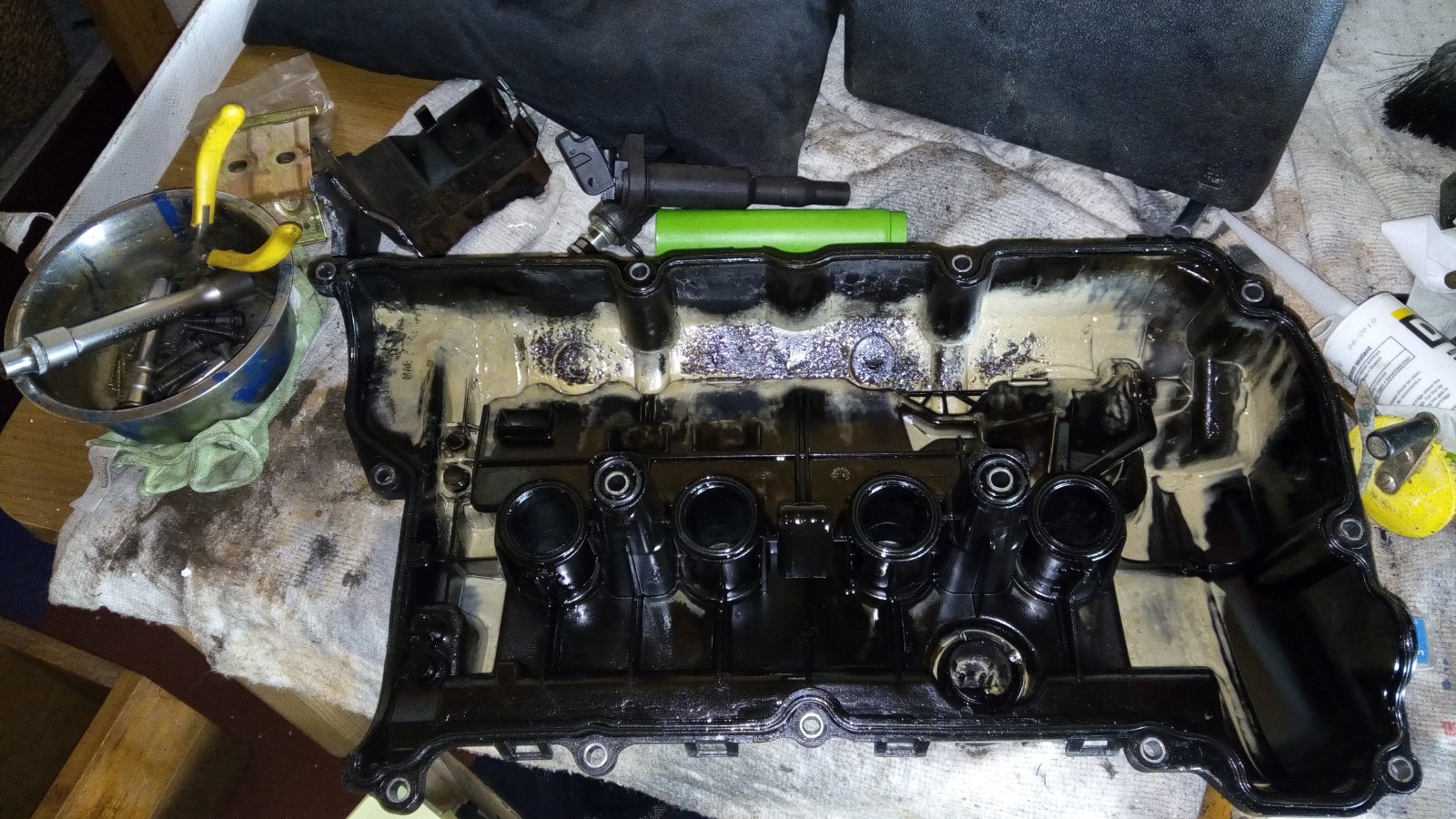

Well things have gone from bad to worse.
I was rechecking the coils and plugs; pulling on one of the new coils it seperated (taking it back on Monday), leaving a rubber over the plug, making it impossible to get the plug out. So off came the rocker cover, straight forward, rubber pulled of the plug, all ok. And when I went to put the rocker cover back on...see below
A lot of white gung.
I checked the oil cap and found some gung in it, but I had to look right at the top of the cap,in the corners, also some on the oil valves. Now I am sure this wasn't there when I checked recently. Dipstick is clean.
This looks like a lot of gung to me but maybe a small leak produces a lot?
Huskyxantia suggest earlier this might be a source of the lumpy problems I'm having.
I know this is a sign of coolant in the oil (possible head gasket failure) but I have not experienced this before, so any pointers appreciated.

Re: 207cc lumpy starting.
This is possible head gasket failure as starting would be lumpy because water across spark plugs means no spark same as the mayo stuff , if you can or know someone get or have them do a compression test that will shine more light on the problem .
If you have noticed a lack in power over the course of a few weeks and more steam coming out the tail pipe than normal that is another sign gasket going, some don't have to over heat one of my old cars ran for a year before it went apart for the slight lack of power wasn't till i striped the head i saw the gasket had failed
Also that rich oily petrol smell , theres a small kit on ebay that uses a chemical that changes colour when the gasket has gone. Ive used them with good results.

In one way I am relieved to see a physical sign of what the problem may be (mayonase). All this OBD stuff was getting me down, as I was going round in circles and changing out parts on partial info is never the way to go. At least my spend has been modest as I had the sense to swope components around were possible and not pay dealer prices when I did fit new parts.
I fitted two new ignition coils this morning and the car reacted very badly and is throwing up four codes re. the throttle sensor, so I now have to resolve that before I can do anything else. Hopefully it is just been knocked in some way when I took the rocker cover off to access the broken ignition coil.
