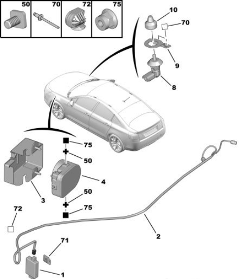

These are the Alarm components: (1) is the control module and (4) is the Siren - so you should be able to rule these in or out....

Despite me saying I would not lose any sleep over this, I parked the car outside my window last night and lost some sleep with the noise :rofl2: at least a reasonable Ashes Cricket response was available..
Yes, that alarm siren is the culprit.. it's sitting inside the steel box in my pic.. I shall unplug it for starters for the sake of others locally..
